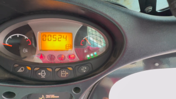

I have a 2019 Bobcat T770 throwing a code E005246--25. Then "SCR" stays illuminated on the screen and the machine will not throttle up. I see that it is a DPF related type error code. I ran the forestry mulcher on the front of the machine for about 6 hours. Then the next morning I just used the machine to push around some debris and after about 20 minutes the code presented itself. I have 3 dots showing on the DEF fluid level indicator. No debris in the engine compartment and all connections for pre-post NOX plugins seems to be well connected nad I did not see any visible chaffing or crimping of wiring. Thanks for any help.

I also get the code U004334-03 DEF PUMP PRESSURE MAX. Any ideas on if I can fix that someway myself? I really don't want to take it to the dealer.
