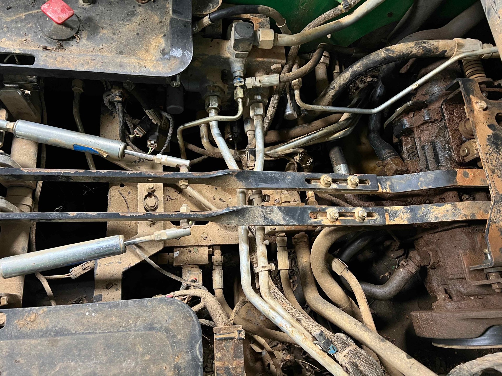

Any idea which line it would be on a T450? Here's an image of the hydraulics. I checked one and it wasn't correct. I can check more, I just thought I'd ask in case you knew. Thank you!!
