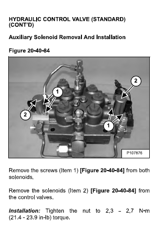

Thank you! Yeah there were so many solenoids on the site, I couldn't figure it out.
I've been using page 20-40-26 of the service manual ... do you think this is the right page?

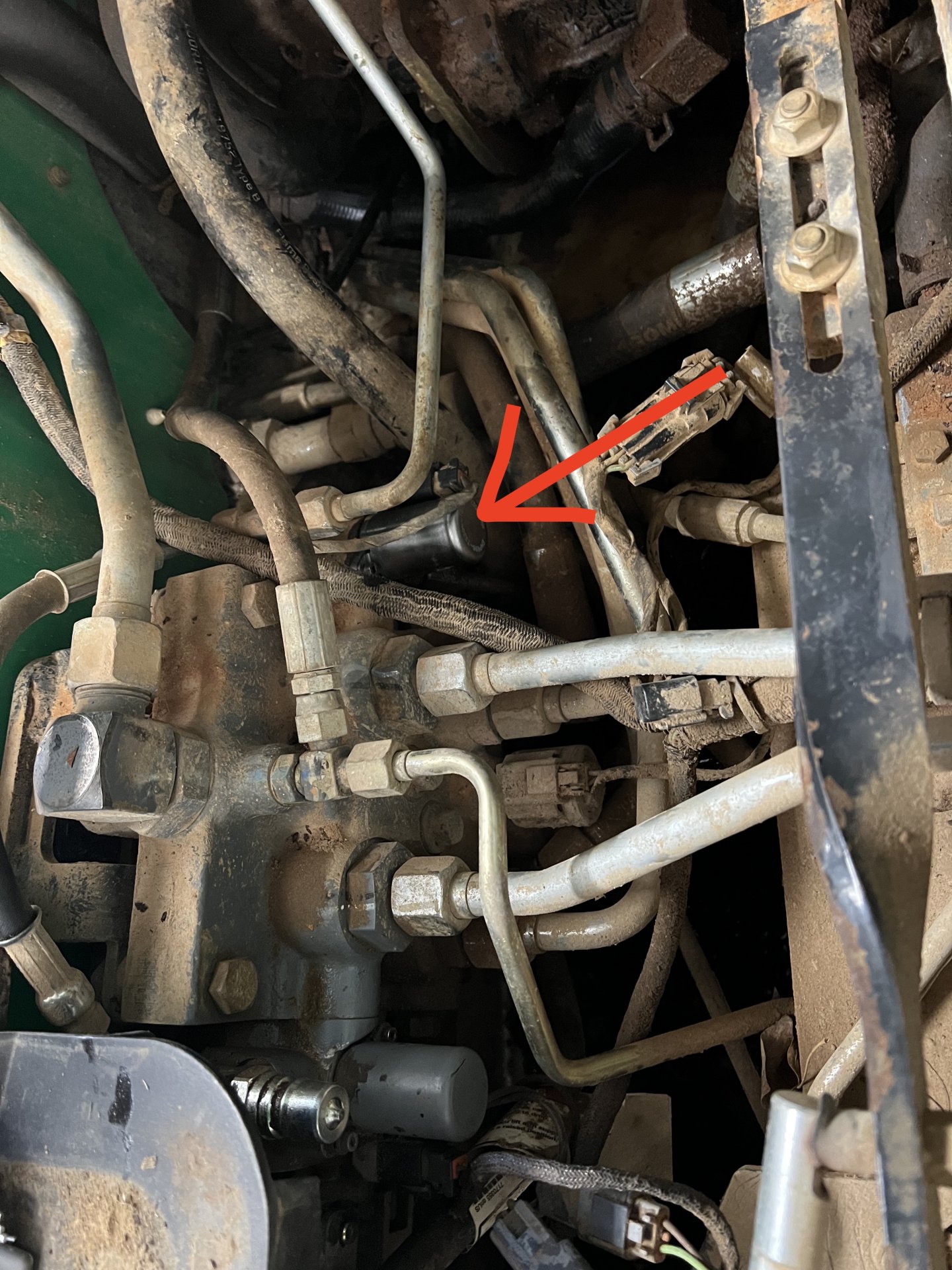

For future reference (for someone else) - this solenoid (H2607) is the one towards the rear of the machine as seen in the pic attached.
