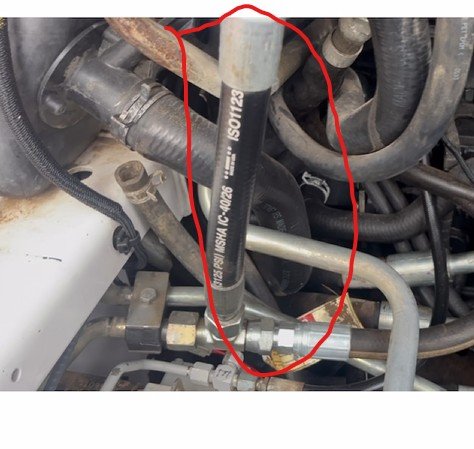

I have a 2008 Bobcat T300 SJC machine. Two years ago I had a pump failure. I replaced both pumps and cleaned the system as best as I could. Once starting it I discovered I had contamination in my lift/tilt valve. I loaded it up and took it to the dealer. They inspected it and said I could replace the valve or they would hone the valve and clean the contaminates to allow the lift/tilt to work. When I went to pick it up it had a ton of drift which was to be expected from what they told me but it now has a chatter/vibration noise when I lift or tilt the bucket. The line from the pump to the control valve had a lot of vibration in it. I then went ahead and got a valve and replaced it myself but the noise is still there. I'm at a loss of where to look next. I have put on maybe 3 hours on the machine since I had it back because of the noise I'm afraid it will damage something. I can try to upload a video at a later time. Also I meant to mention the machine drives fine with no noise just lift/tilt. Thanks for all your help!

That’s what I thought and was told after it was done. I’ve got a fortune in this machine due to bobcat trying that. I bought a new valve and installed it so that valve is no longer in the machine but the noise stayed. I posted a video below.

What is that ? Who installed that?
