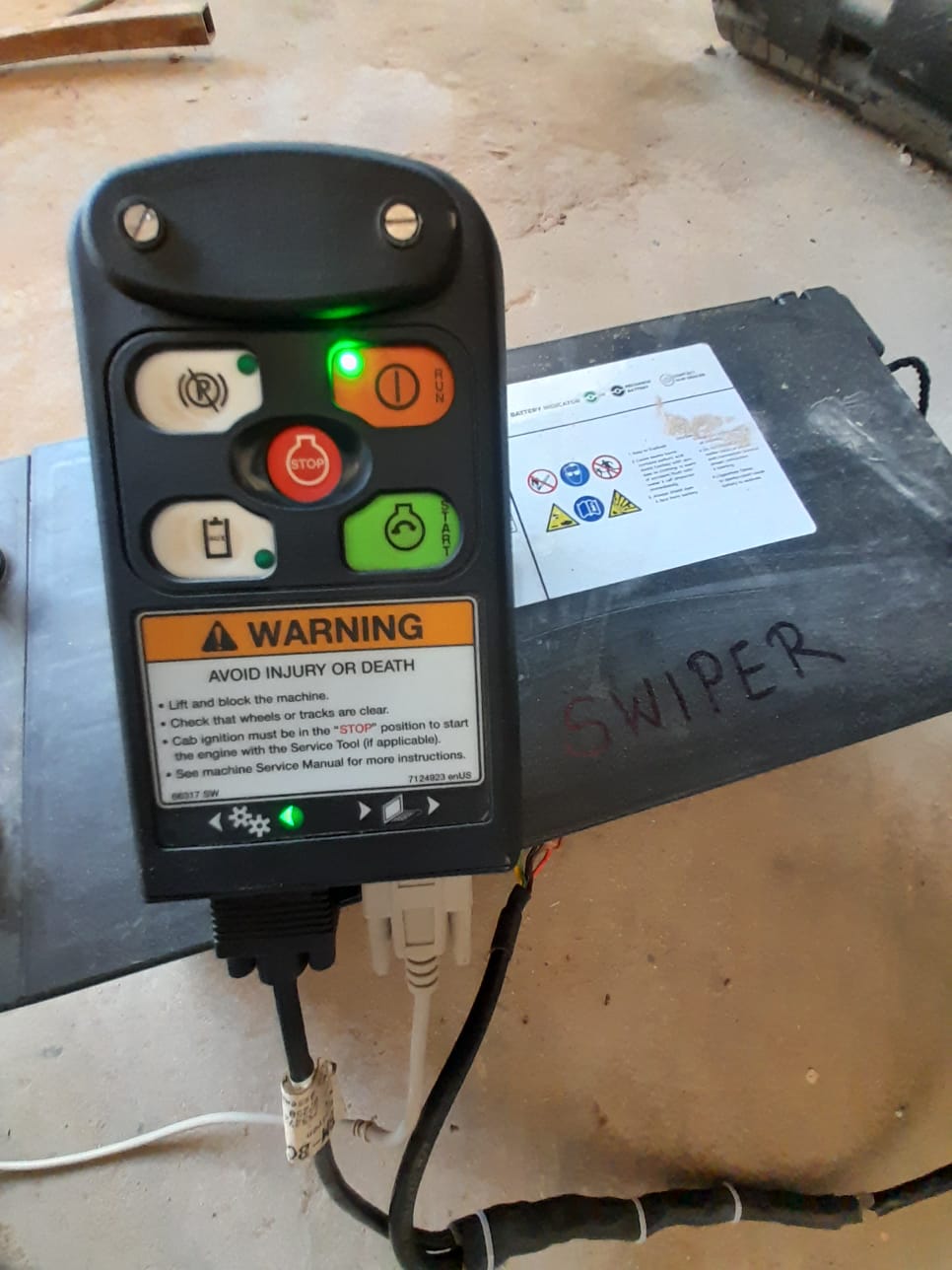

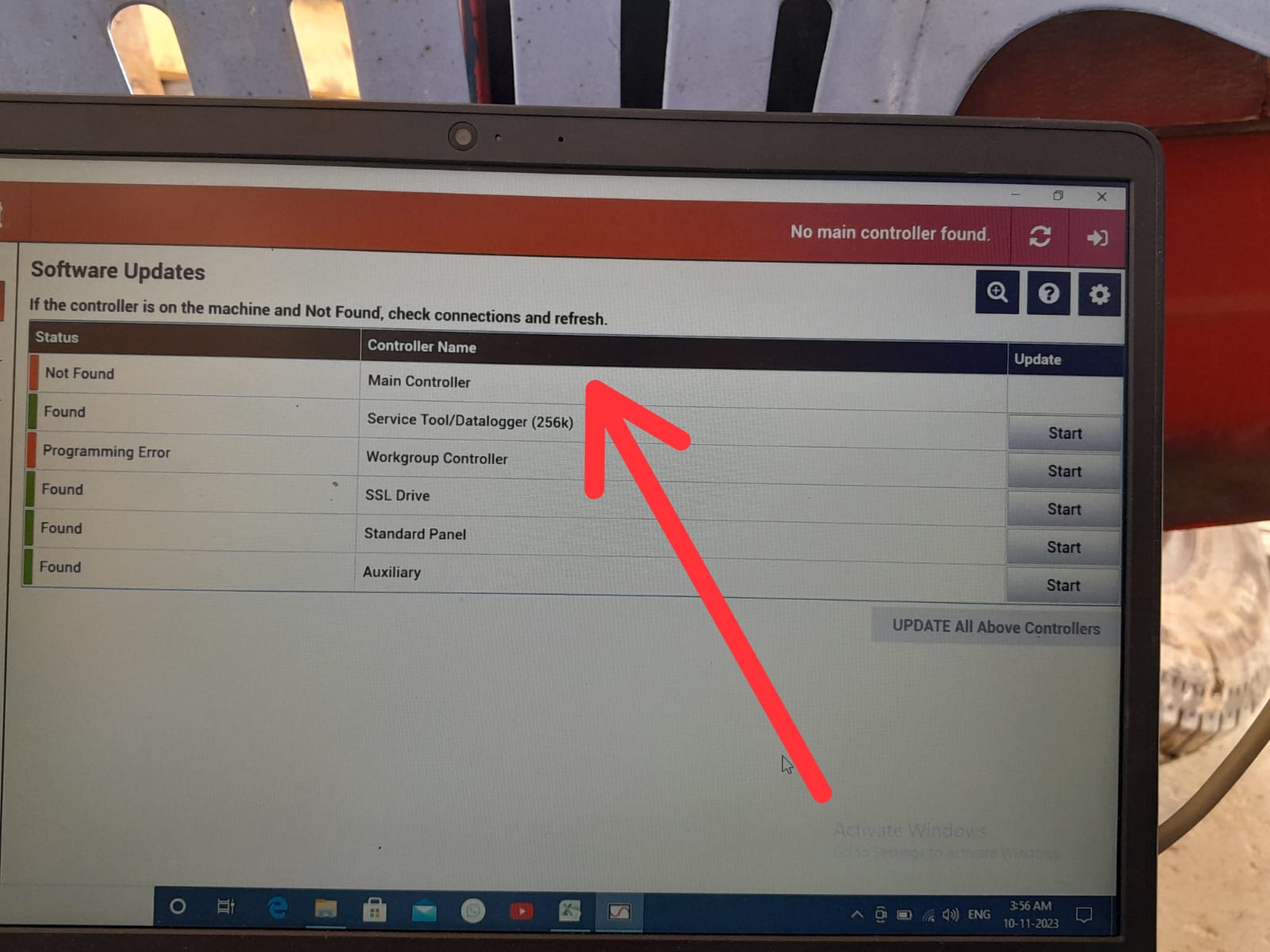

There's an issue with a Bobcat skid steer-(T770) machine. Gateway controller shows as no communication on the display. After putting 2 new controllers it's the same. The machine doesn't start as well. Put new fuse, relay, original battery and check the wiring harness connectivity and there were no issues in them. All the other controllers got updated.
Should the gateway controller be plugged to the machine to update it? Or on a bench?
We purchased the controllers from Dubai through a bobcat dealer. One of their technicians came remotely and programmed it. Only the gateway shows as not found in the analyzer tool and machine display.

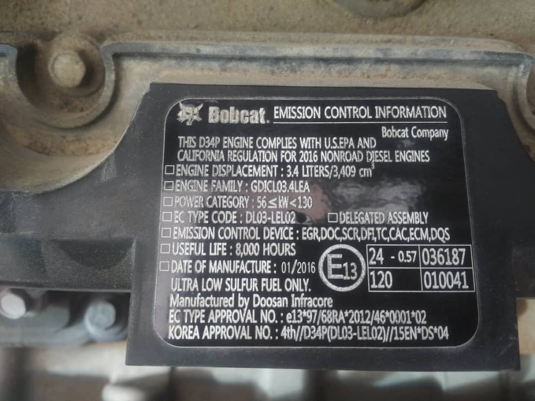

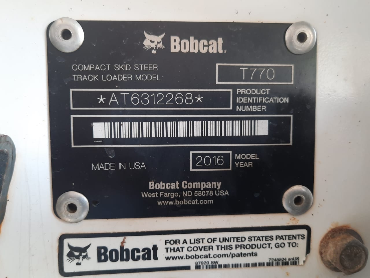

    104 KB
    107.1 KB
    81 KB
