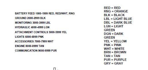

The wiring diagram for the early 864 has wire colors. For the later machines the wire numbers are printed on the wires and at the top of the diagrams there's a guide to the colors based on the numbers like this.
