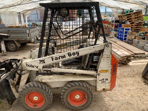

Hi SR,
Well I guess it is an old peace og machinery, but it works and are in good condition taking the age in to consideration ????
As I can see it is a clutch drive and it has 2 bucket cylinders, the engine I am not sure of but have a look at the image below.
It also have a 2 way hydralic outtake that is used for the excavator addon.
Will this help getting closer?
Regards Steen

Unrelated, but that looks very similar to the design of the Rounder L-600. I'll bet Rounder copied some of their design elements off Bobcat or vise-versa.

Hi Steen,
Yes, that helps a lot. I would look for a manual for a 310, 313 or a 343 - all very similar machines. We used to have an M371 - also similar, but older.
Interesting choice of engines, most others had Kohler single cylinder engines fitted as original equipment.
Cheers - SR

I have seen references on the net before about a rare bobcat machine made in Japan. Looks LIke I finally seen one. Although it looks very simular to my old 310, there appears to be a few differences. Check in the UK and europe for a manual.(europe ebay)
Beyond that, if your needing help with something, post it up and we will try and help you thru it.

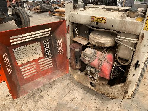

Hello Steen, have you found some more information about your old machine? I bought a 300 farmboy last week, when it is running, it is a lot of fun to work with, but I am struggeling with the carburetor. Sometimes I have no more fuel in the carb, I think the valve is blocked, the carb is from mikuni. What brand and type is the engine? Here is a short video from today: https://www.youtube.com/watch?v=8FIKWwYEW0E Thank you and kind regards from germany.
I am searching for an air filter as well.
I would suggest to take the carb off and get the model numbers from it( since you know the manufacturer ) and get a rebuilt kit for it. I think that would be the easiest for you. If it is running out of fuel chances are the needle and float are not working correctly.

I have the skid now in my yard, the engine is a Kubota GN4000-H-TCM with 12HP max. and 8.5HP cont. If somebody knows an airfilter for sale, please let me know. After an ultra sonic cleaing of the carb the engine runs fine. Could anybody confirm that this machine has no seperate hydraulic tank? I found only one plug in front of the seat.
