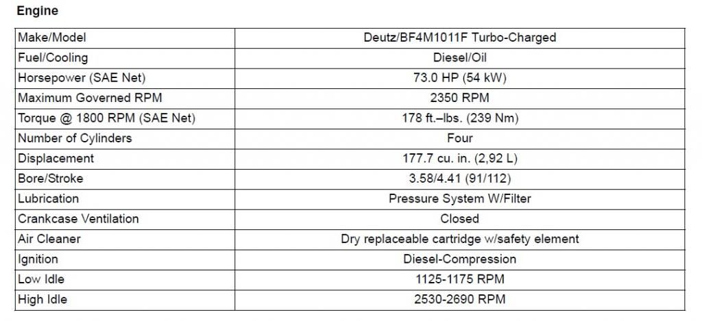

Here's the engine info from the Bobcat service manual.
