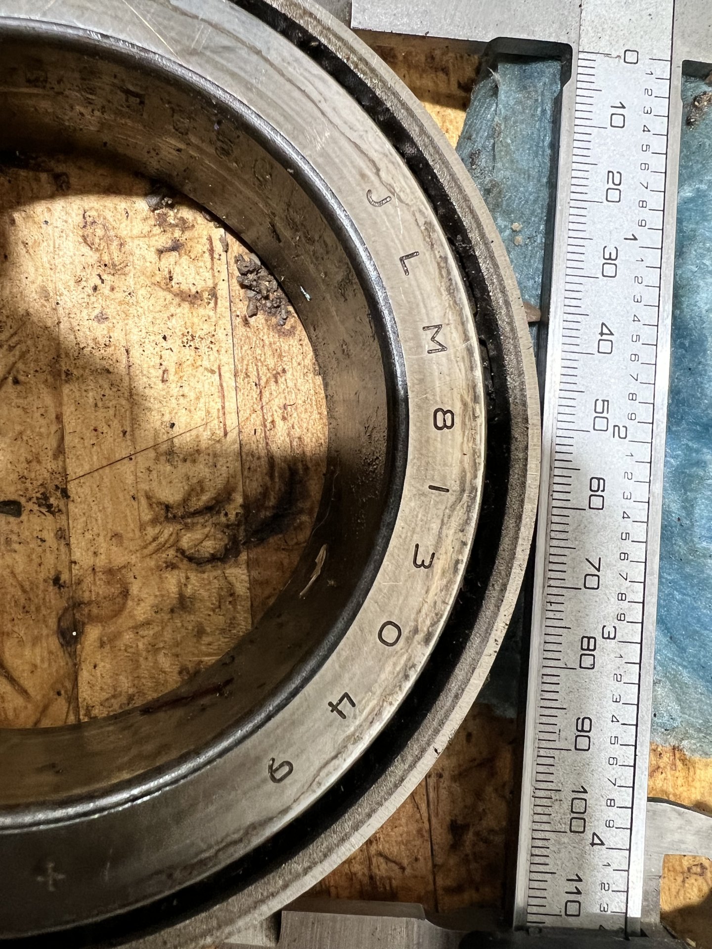

That is the Timken I just pulled out of mine. 4.33" OD.
