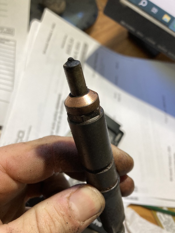

Now I just pulled a fuel injector and the tip looks fouled, so I'm going to just get a new set of injectors (unless someone wants to advise a good way to farm-clean the injectors and pop them back on). My main question is if there could be sediment or issues in the injector pump that might work its way into the new injectors after I replace them. Or could it be something other than the injectors? Also interested if there is a way to salvage my current injectors.

Well, I replaced all the injectors but it's still surging when throttling up and there's no power. Idle is smooth. Here is a link to a youtube video I took of the sound (). Am I looking at rebuilding the fuel injector pump at this point? Any tips are appreciated
