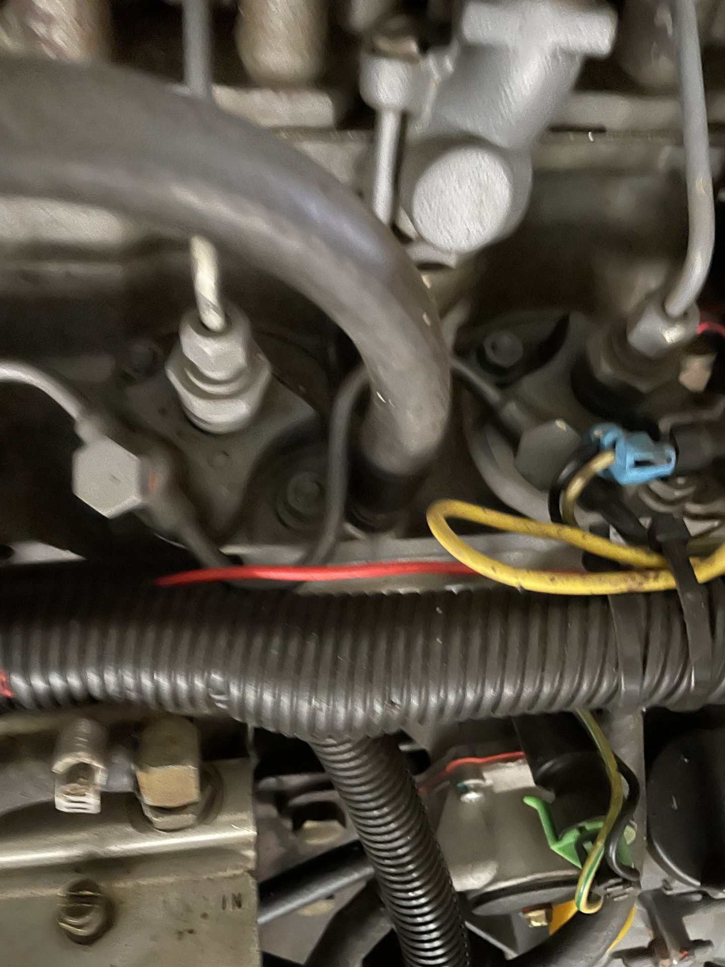

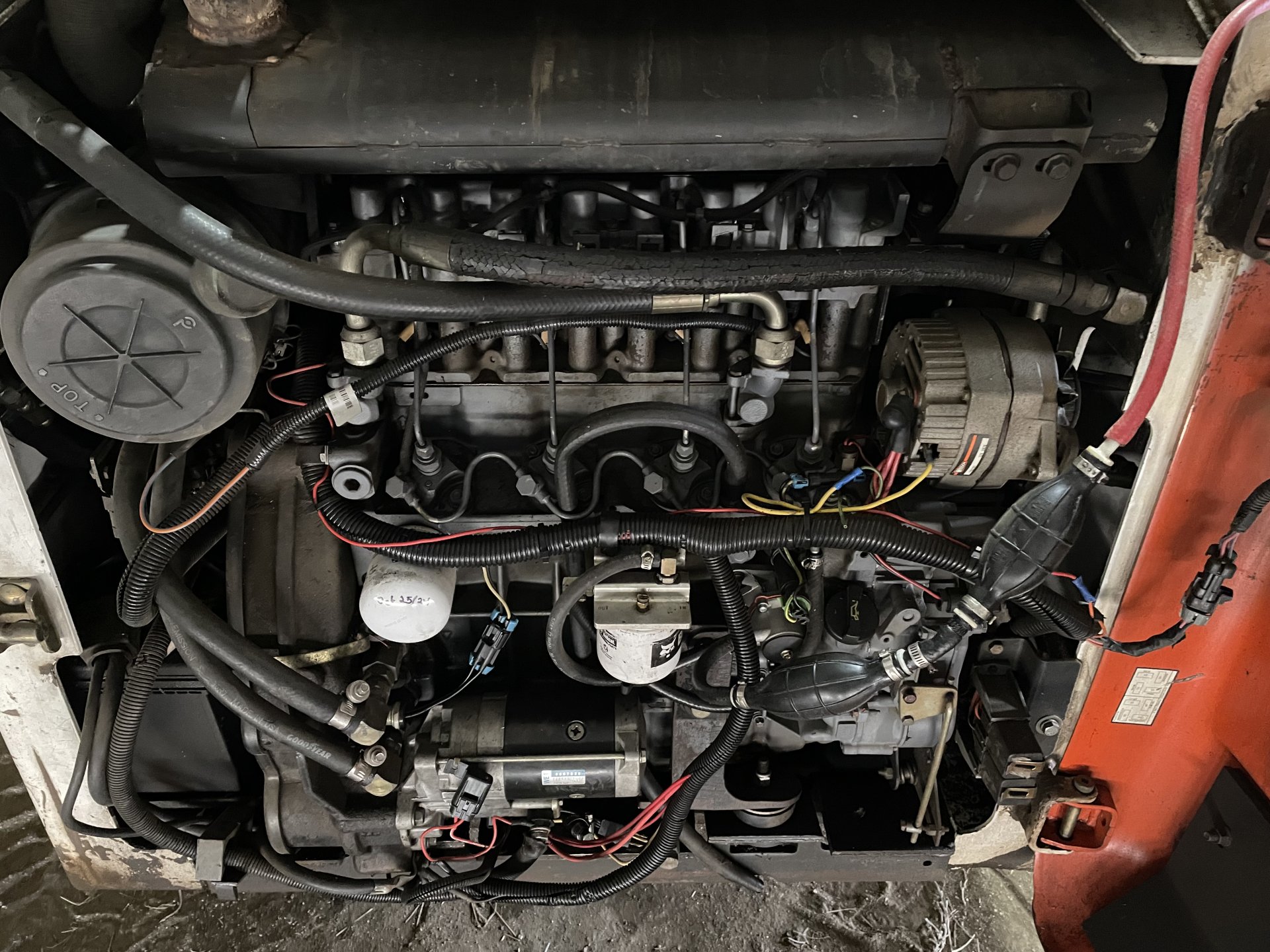

could you take a picture and give me also your serial #?!
    521 KB
    407.8 KB
    300.7 KB
Someone deleted that probably.
What color is your smoke? Because it seems like also that you have an exhaust leak somewhere. There is a lot of soot inside that engine compartment.

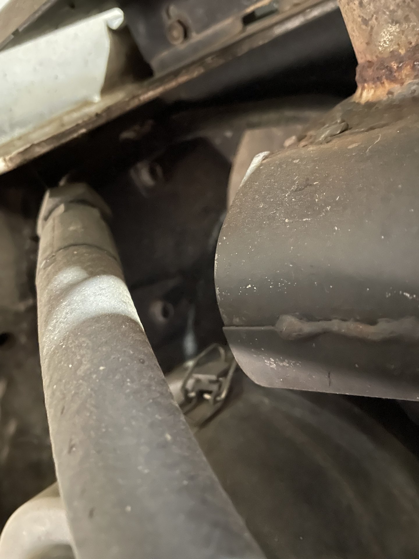

The muffler has a bit of a crack on it. It needs to be replaced.
