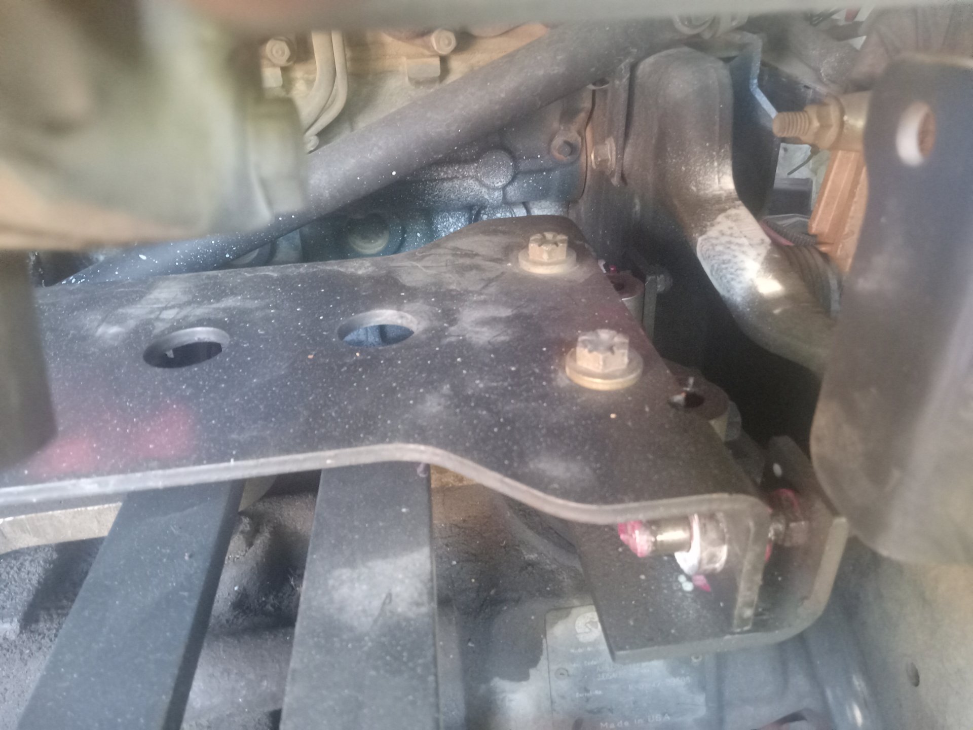

Could you also take a picture of your Neutral plate, because by these older machines there a several setups even within one serial number break.
Here's what it looks like

Just some grease I applied in case it was sticking. Drove it today and the rh wheel actually stops for a second when moving forward and that's why it bucks and jumps I can't imagine it's just an adjustment.

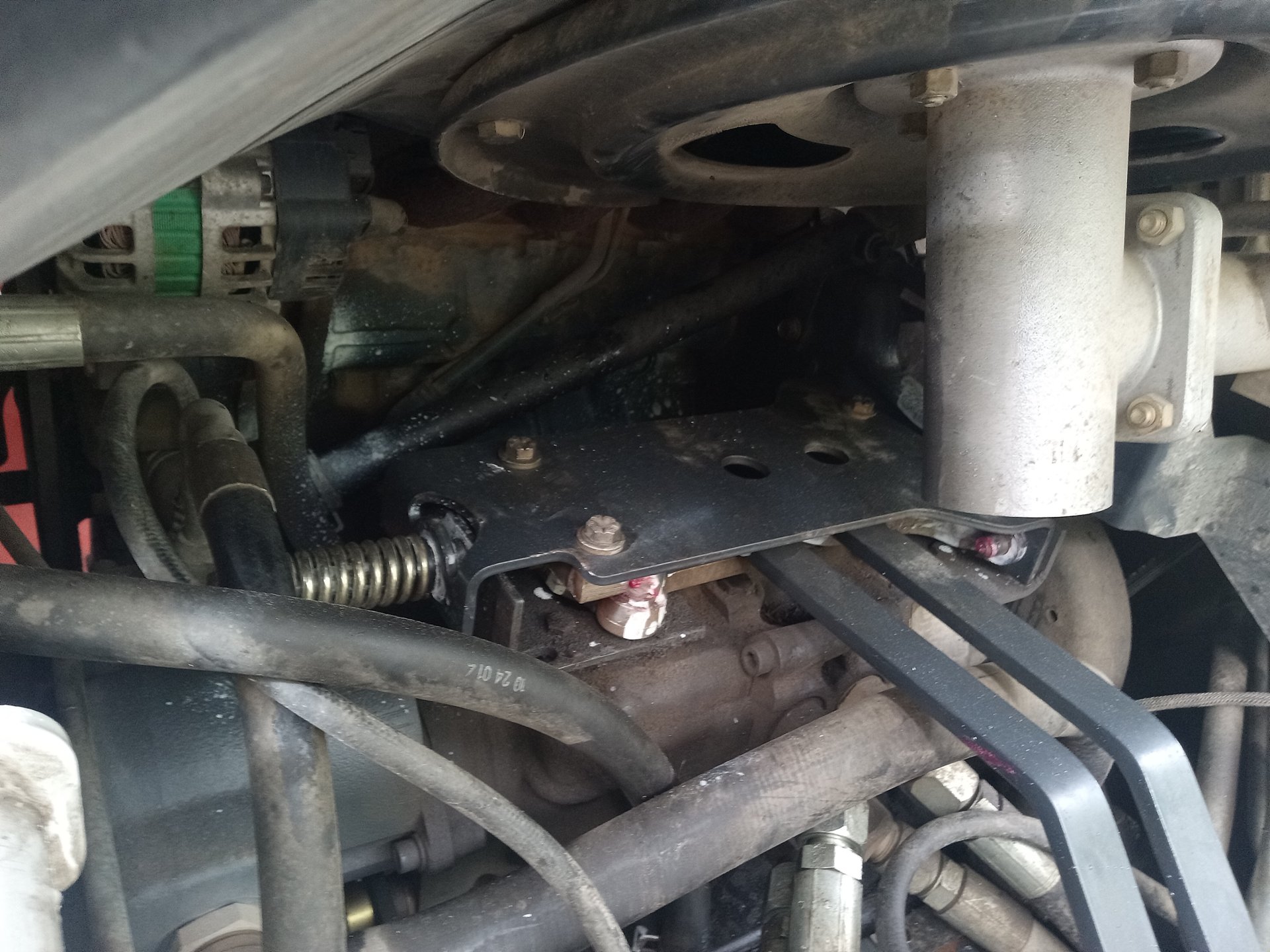

Could you take a picture from the neutral plate again, but from the other side?
If I push the rh stick forward as gentle and slowly as possible as soon as the machine starts to move it instantly lurches forward almost like it has a sticky valve or something there is not a Smoot transition from neutral to forward motion.
Ok, sorry that picture did not show what I was hoping for.
Are you able to record a video, without the machine running and then with the machine running?
Just record the linkage when you move it forward and backwards.
