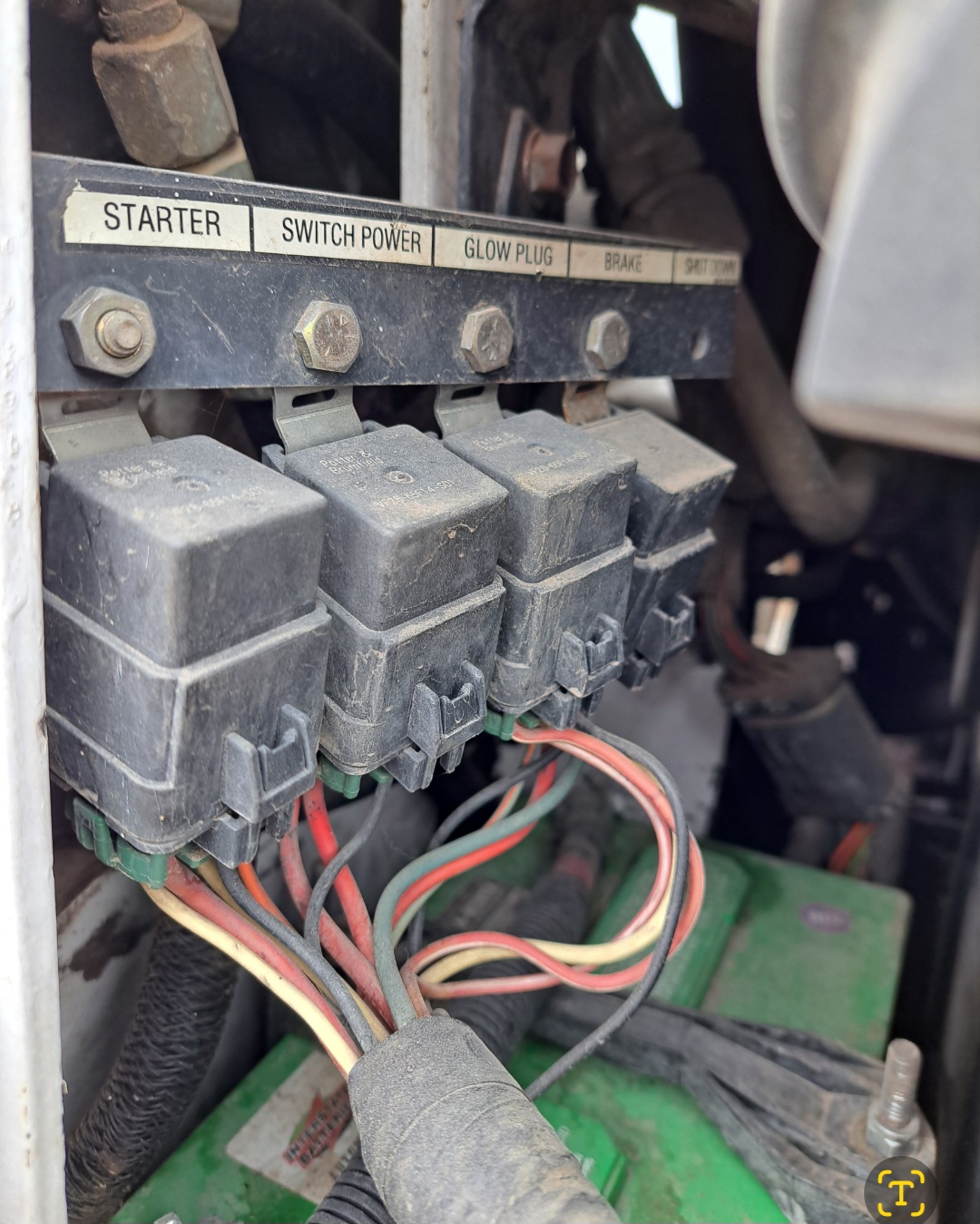

I've got no power to the ignition switch so it does not start or put power to the boss/glow plugs. It does work with a jumper/ inline fuses to the switch—boss/glow/starts as it should. The fuses look good. Thus, I believe it is a broken wire or relay is shot. I am unsure which relay is the ignition relay. There are 4 over by the air cleaner/battery and 1 by the fuses. Any takers on which is correct?
If it is a broken wire, any issue if I Jerry-rig a a new wire with a 10 amp fuse from the starter to the ignition switch.

Here is a picture of an 863 Relays.
Might be the same as yours? But please Confirm.
