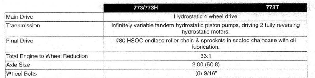

hi was wondering if anybody knows the drive chain size for 96 773 skidsteer...is it #80 or 100 size chain....back wheel locked up on me and sure enough the chain broke and fell apart luckily nothing got damaged..soon as it happened i shut it off and lifted the back up with the forks and dragged it in the shop with the t190.... the only thing the chain says is diamond and #10 on the backside of the link...it looks like an 80 chain but not sure.. i sure would appreciate your advise..thanks for your time
thanks guys...this site is awesome...i guess it is a 80...thats great info machinist...i know there is no master link but i found a company that sells very heavy duty 80 chain and master link so thats what i am going to use..its rated for 28,000 lbs...i will just tack the link with the mig once the clips on just for better security..again thank you for your time and chiming in.

this just happen to me a month ago on my 542b i was able to get the chain at fleetfarm (they sell #60 and #80 as well) 2 boxes of the 10ft sections should do all 4 chains. but you need to buy a additional pack of 3 master links (each box only comes with 1). Also i used AW32 oil from fleetfarm to fill the chaincase with instead of the expensive bobcat fluid.

I just had a major issue with my chain case. I found out that they are a weird off chain size. Mine is a 1998 773, they seam to be a Bobcat only size 83 pitch or something like that according to the parts manual online. G

Pretty sure 80 HD will be fine take a piece of your old one in to match up
