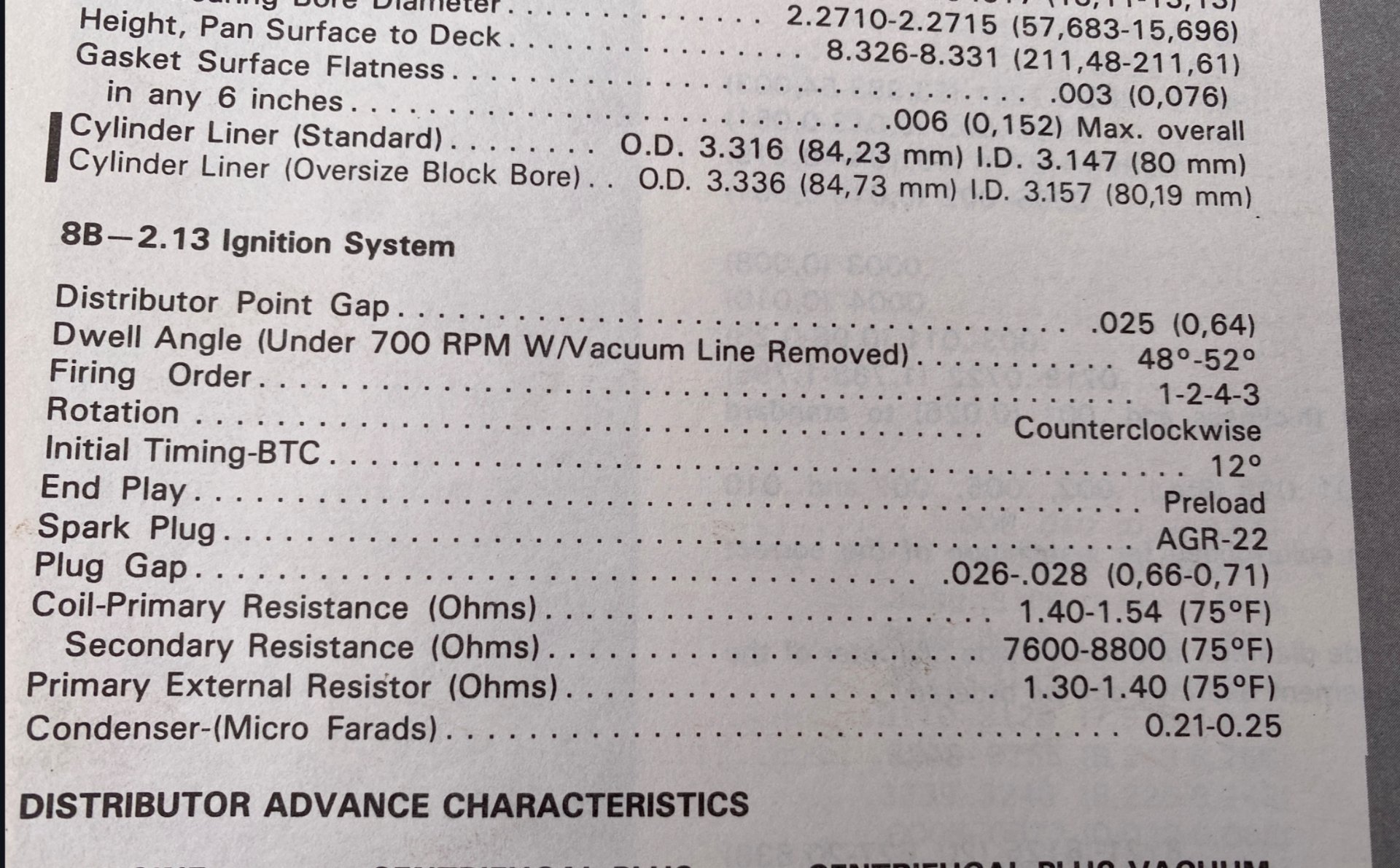

Can you post the timing procedure for the 1.6 742. I have the same problem.
The distributor nut is a pain for sure
Here's the specs from the manual. Also, you shouldn't have to loosen the distributor bolt. There should be a screw holding the distributor tight. Mine can be seen at the bottom of the distributor through the fan belt.
