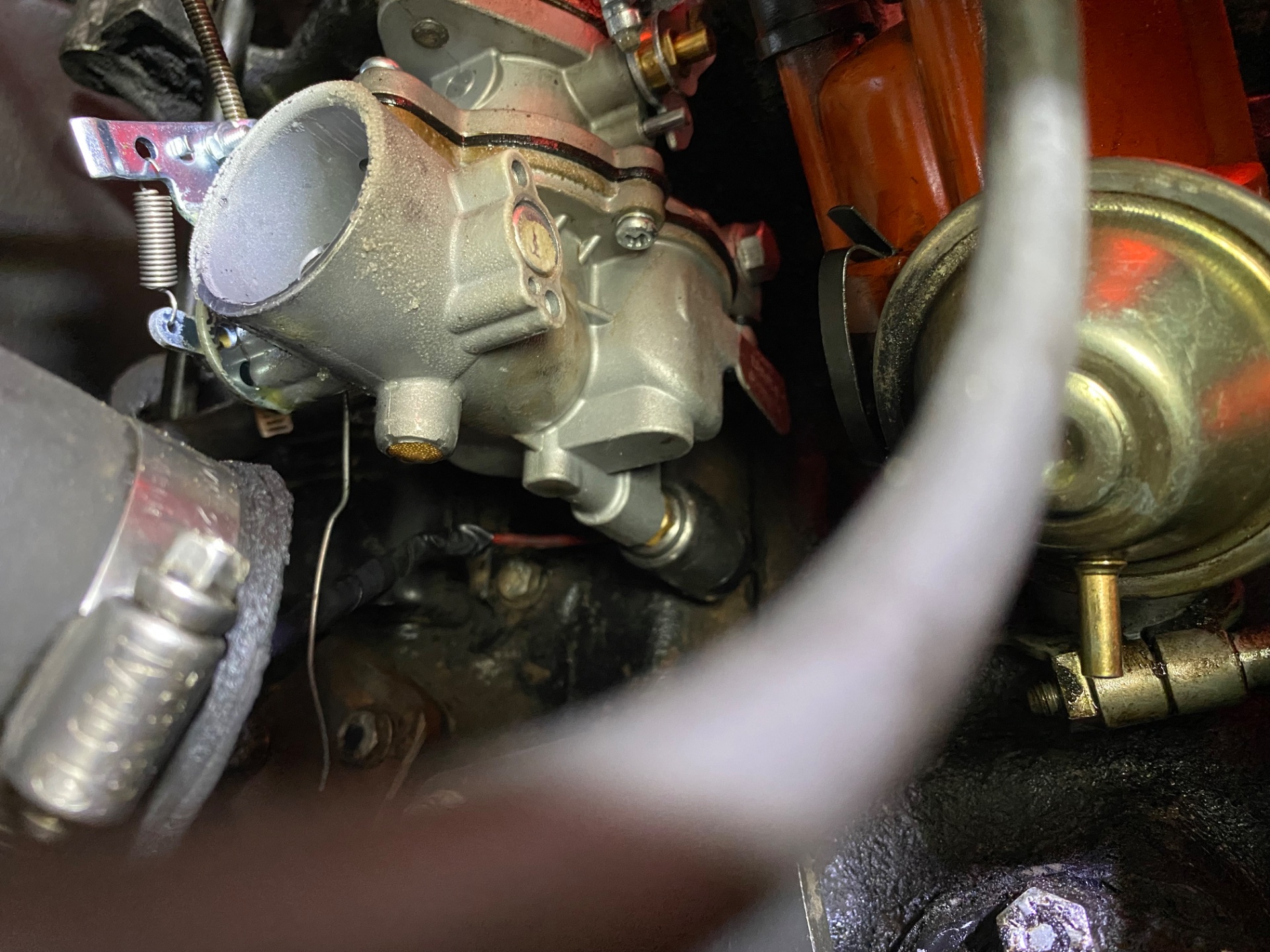

So I located the fuel solenoid but did not test its operation
    761.5 KB
To test the solenoid, just apply 12v to it and see if the needle retracts. Also, there is another fuel shutoff you can check. Looking at the engine compartment it's on the upper right side and has wires going to it. It is normally closed so applying voltage will open it. Let me know if you want a picture ..
