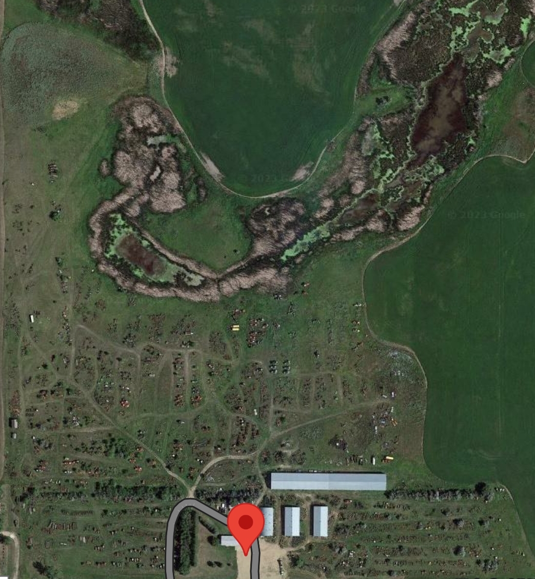

Is that salvage yard you're going to visit, good size? I'm going to have to do some research on what models used the same motors. The Model 632 motors are serial number specific. They put 3 different motors in them. I would like to find 2 motors out of the same machine, that way the wear would be even.
As far as general farm machinery, it's not small... But I don't know what he's got for skidders. He's got lots of smaller/medium tractors. He stocks mostly "rust".
But come a little bit of thaw, and I'll hit him up, unless I find myself out there sooner.
