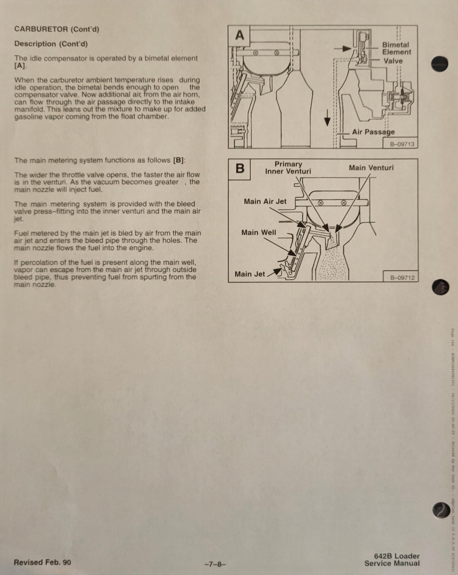

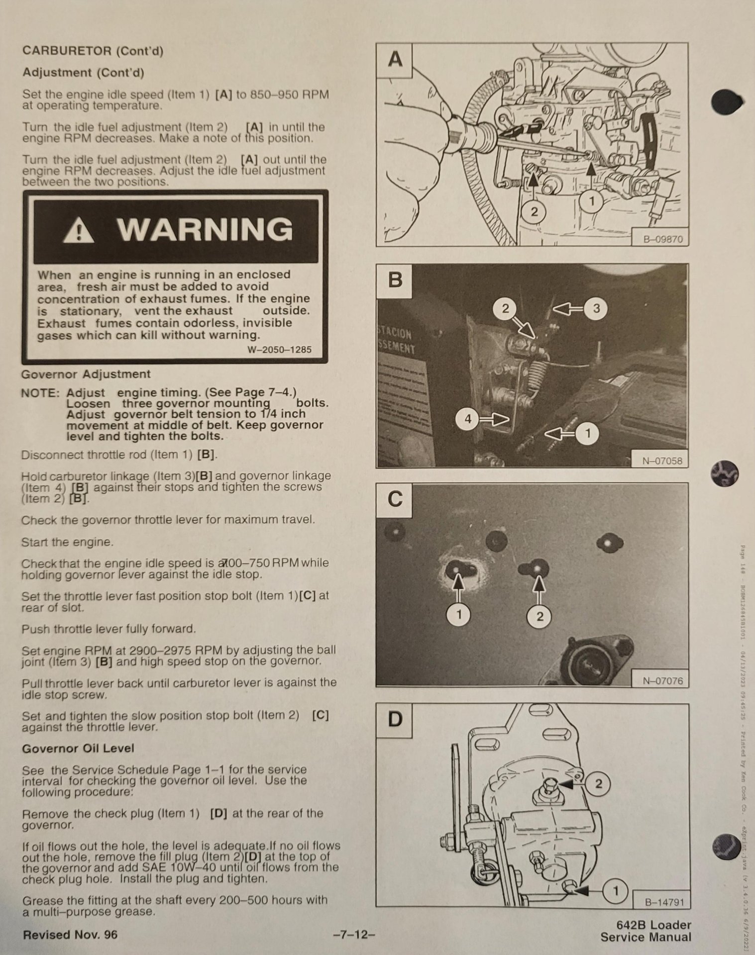

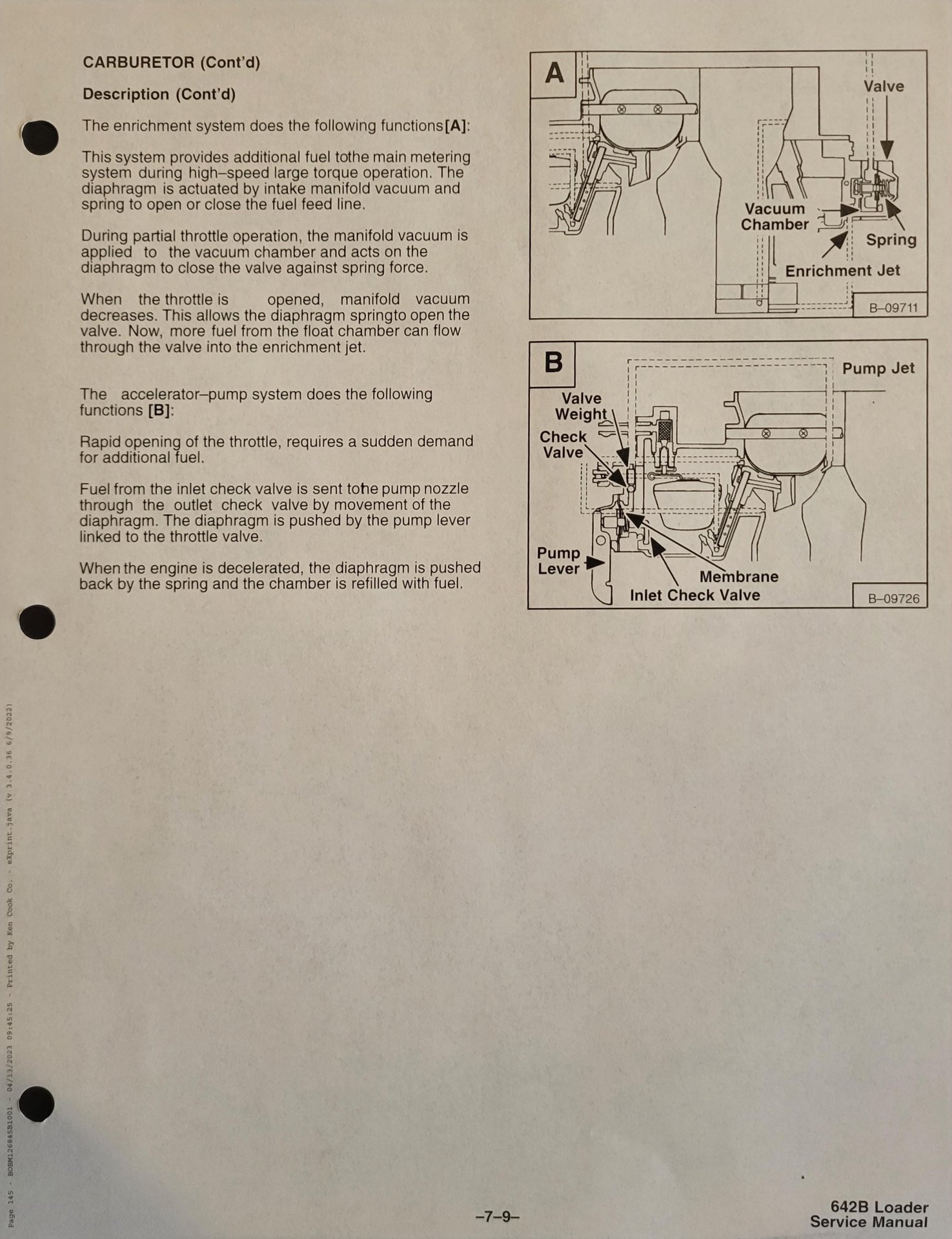

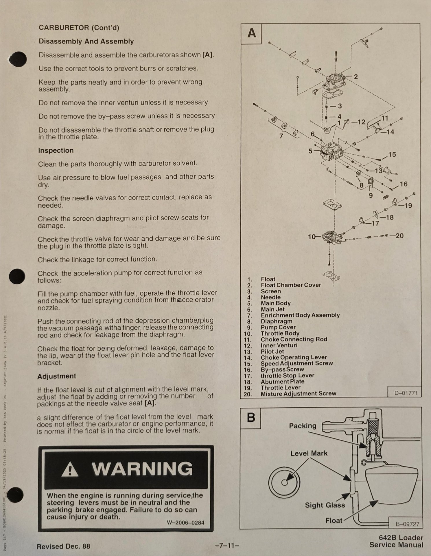

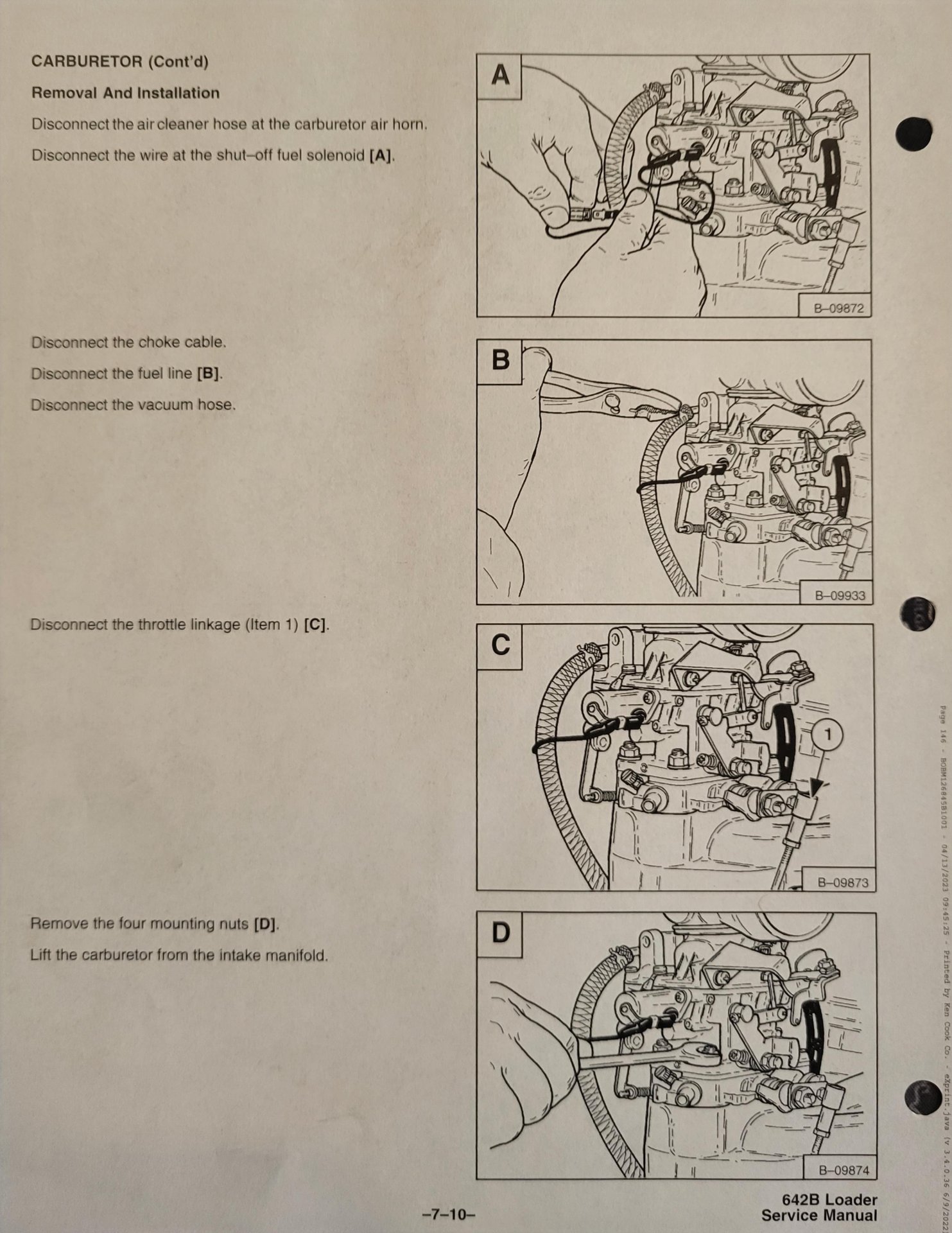

I also agree with @cdmccul and see that this is an older thread though I don't think things got resolved to an adequate/ or granular level. I have added my 2 cents worth below:

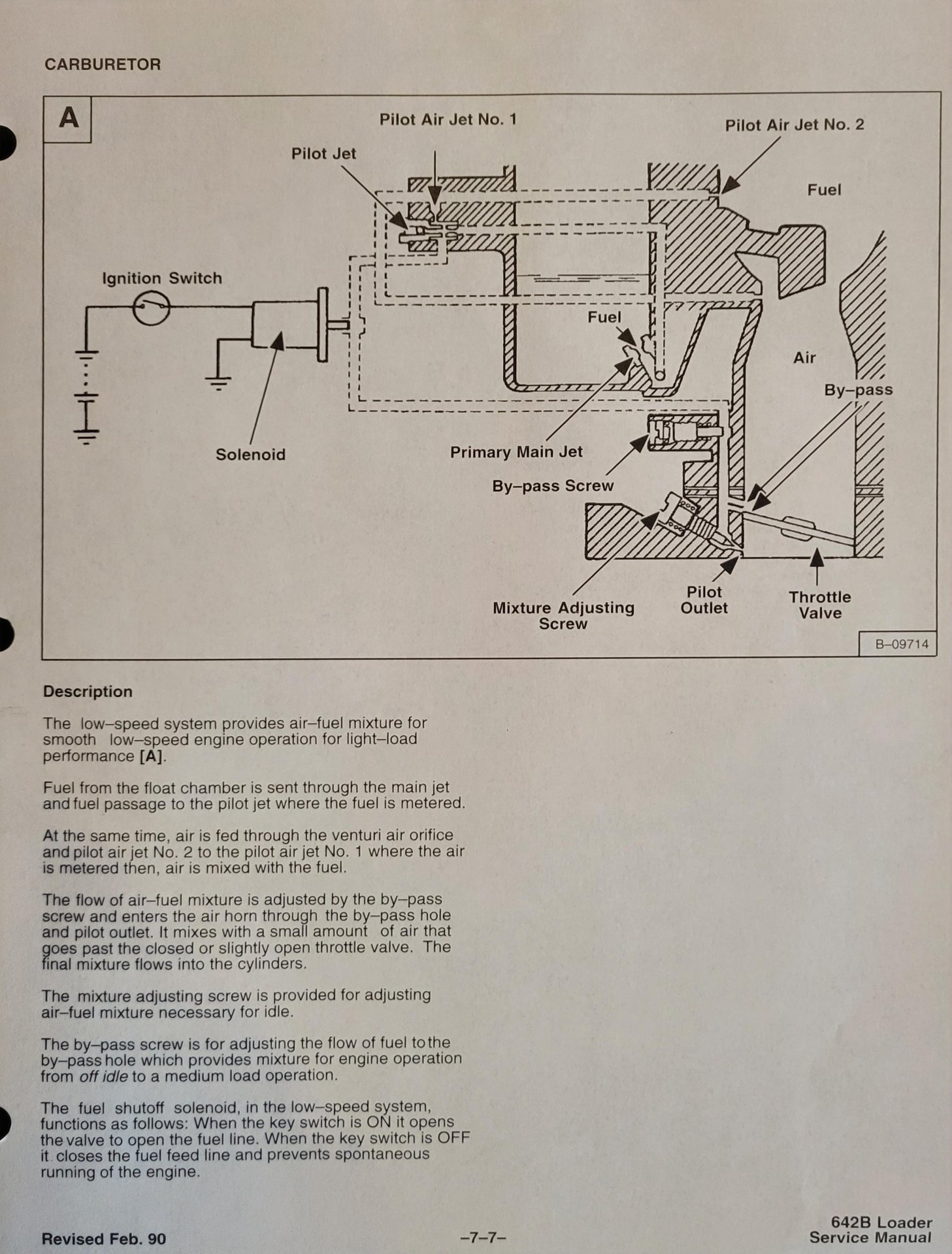

Regarding the fuel
  • Being the first issue/ question listed can as mentioned by bridge builder be due to vaporizing of the fuel (If a gas engine with a carburetor is installed and not swapped out, gather it is based on the governor question below) and it then running extremely lean.
  • A second cause maybe common issue with Mitz engine is the carburetor seals having perished (easily noted by a truck load of fuel in the engine bay and wet drippy "Covid Carburetor" (my term)) (Very much a fire hazard)
  • It may be a potentially combo of fuel vaporizing and carb being empty when you go to start as a combo leak and vaporization.
  • Third maybe the complete opposite, the engine is flooded, the needle which stops fuel from coming into the carburetor bowl may be clog causing a failed open scenario, as the fuel tank is higher than the carb this causes a syphoning effect as fuel continues to flow unrestricted.
  • Fourth is to check the Fuel Solenoid may be sticky that shuts of fuel when the ignition is turned off (round battery cylinder looking thing with wires hanging off it), that is attached to the carburetor.
  • Just a few ideas to follow until you find the cause and rectify.
The "Round Pump Thingy Dodar whatya macallit" (Techo term)
  • The second is the governor as the team noted above.
    • The hand throttle attached to this device. then a rod runs up to the back of the carburetor to control "Govern" the amount of fuel used.
    • on page 7-12 diagram D there is an adjustment bolt that allows you to set the amount of governing the governor will apply, remembering all the engine is doing is powering the hydraulic engine, so it doesn't need to be revving like a horde of screaming banshees.
I have included the pages from the manual that addresses both the Carburetor plus the Governor and how to adjust both.
Hope this helps
Cheers
Geo.

I'll take your word on that @cdmccul the stuff comes from my 642b manual, for clarification and caveat. ;)
Thanks and for the take on the guide. I guess the principles apply so if it helps all good

@Schifference , quick question does the electronic fuel pump have a cut off? I am not familiar, but I do know with the mechanical one fuel flows through due to gravity. The solenoid also shuts off the fuel flow to the carburetor's venturi, as the fuel tank is higher plugging fuel from being pulled down, which if not working correctly causes flooding??
Appreciate your advice/ insight on this.

All I know is that I did that to a 642 that I own. If that antibackfire solenoid is faulty you will have a no fuel. Without a fuel pump mine will not run. When I turn off the key my coil has no voltage and my fuel pump shuts off.
Electric fuel pumps, (Chugger pumps) do not have a cut off.... But they have a low enough fuel pressure that the needle and seat should hold back the fuel.
Yes! That means that if you have a faulty carb (bad bowl gasket, bad float, bad needle, etc) you may very well empty your fuel tank into your engine compartment.
If functioning properly, it won't have a problem. The anti backfire solenoid was removed from later models, it must have been found to be unneeded. I have cut mine and have no problems. I do not even turn off the fuel valve under the tank by the filter.
And you're right, you have to have a pump... It won't gravity feed (enough) to run the engine.

Another amateur fix was clean carb and float. Use carb cleaner to shine float .Make sure the float pin is shiny as a mirror. I also lowered the float to less than level . That spring that goes on float pin - kinda puts a snake bite on pin , Does anyone know what it's for ? It's difficult getting it on right so I left it off . Works for Me .
The spring kinda keeps the float from bouncing so much. It doesn't really add and real adjustment to float height.
