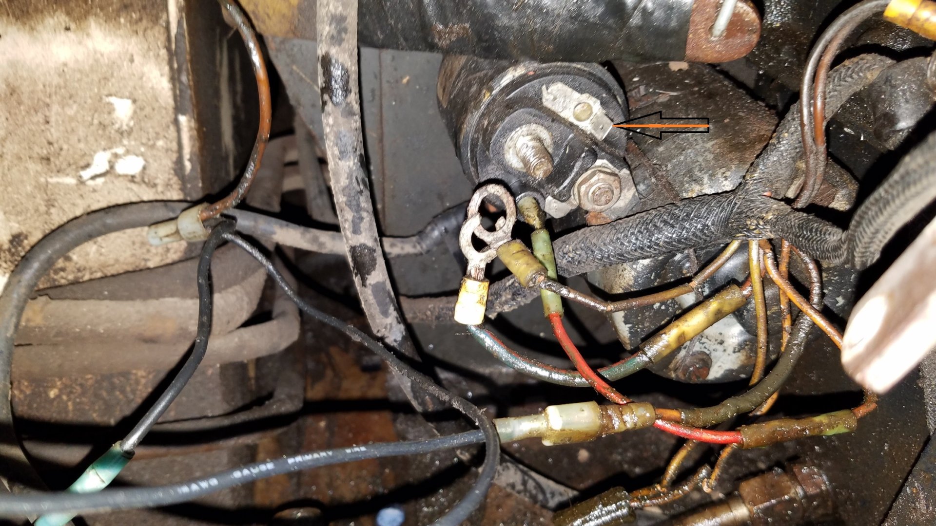

What is a big unknown is the rusty wire upthread near the solenoid that goes nowhere. Thinking this is the real issue.

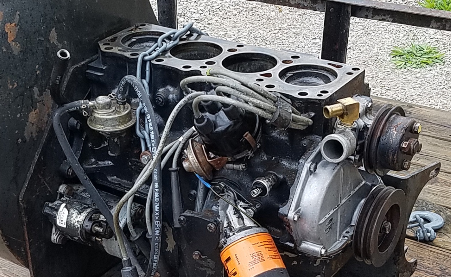

@RandyL thanks! I did buy compression testing kit and found 110 lb and 95 lb on the first two plug points. Perhaps should check them all.
My situation was that my 632 would start at times, and seem to run well. Other times it was difficult to start, but when started it would still run well. Finally it got to where it would start no more, just crank over. All the ignition checks were made as mentioned above. Finally I did a compression test, It was extremely low. It should not have ever started at all..down in the 40 pound range. I oiled the cylinders and it was still very low. I decided to pull the motor and find the problem. The major problem was that the rings were totally worn out. Oiling the cylinders did not raise the compression because the pistons have a deep recessed top and all the oil was collected in this dished out area. The dished out pistons messed with my diagnosis of a "wet" compression test. Starts nicely now that it has compression. I still run the standard ignition system. View attachment 2568
Great picture of the 632 engine! I do see your distributor cap is black (my Bobcat 632 has a brown cap). Hoping that the plug wire order would be the same - can you please tell me which wire goes to which cylinder from your distributor? I think I messed up my order when I replaced the plugs and wires. Thanks!!

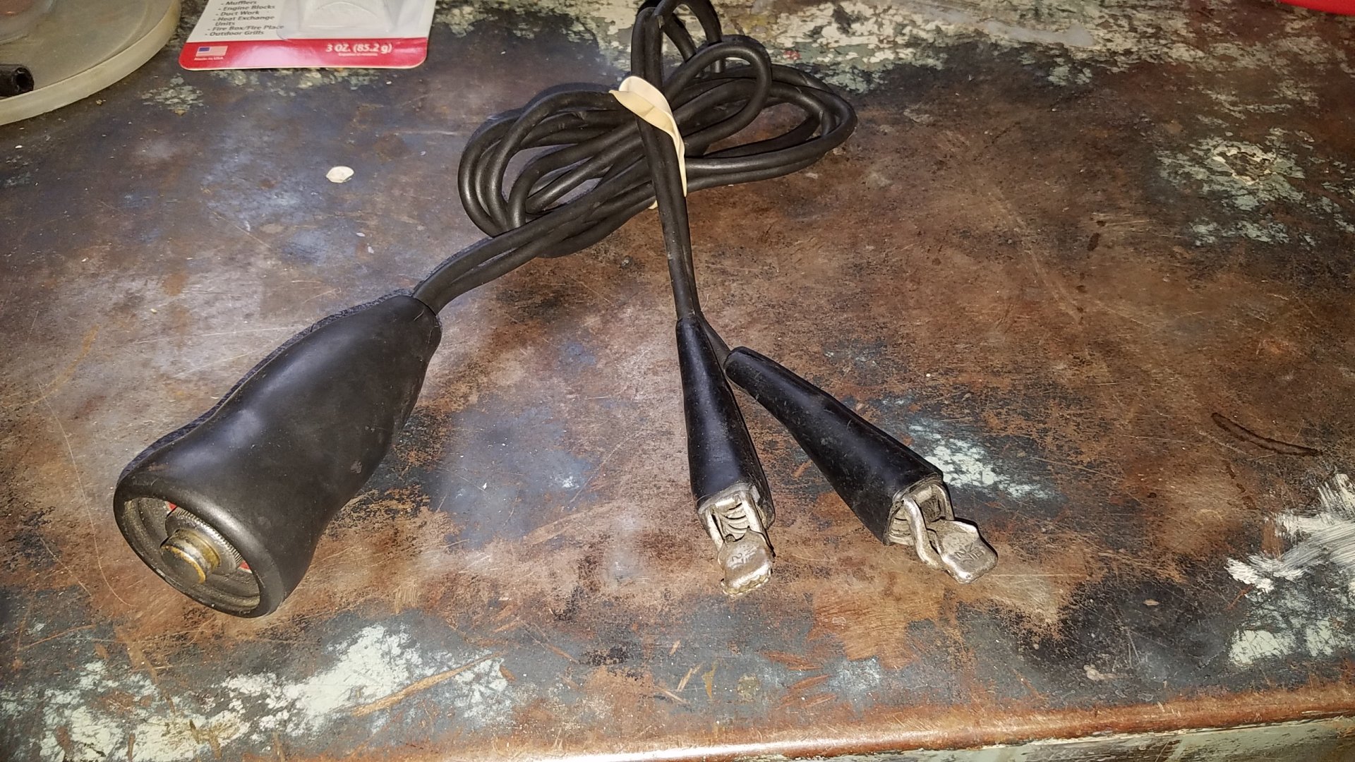

Randy - I am the only one working on my Bobcat 632 (with no 2nd helper) - want to crank while I am on the engine side, as opposed to walking to the front of the bobcat when I am unable to see any dials or readings) - Any suggestions on what part to buy and the wiring needed so I can temporarily crank while working on the engine? Many thanks!
Sent you a private message… you can also bojang together a switch with alligator clips and hook to those terminals, then when you need to crank you simply activate the switch. Be careful of any loose clothing and body parts that they don’t get caught up in the belts!
I used to bridge the starter but the sparks produced were not fun, not to mention the damage that was happening to the studs.
A remote starter is what I use now. Here is an example: Amazon product ASIN B00OPVYHZ4
It’s a personal choice and they are easy to make. But for the price, and since it can be used on just about any vehicle or machine with a starter, it’s worth the $20.

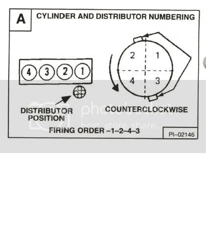

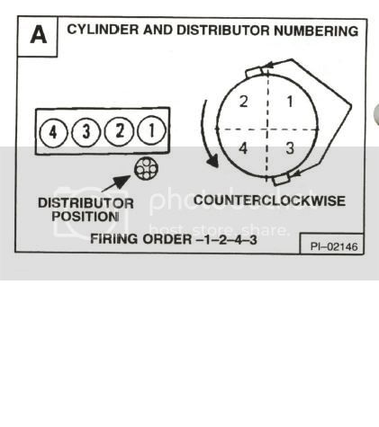

OK.... lets see if we can get your plugs wires on correctly. This is an old picture from a previous post that shows it pretty good. This is the Ford 1.6 engine. Mine is wired like this. The cap color does not matter. That is the material it is made of.
#1 cylinder is close to you when you open the engine hatch, #4 cylinder is much harder to reach, deep in the engine compartment.
There are 2 clips that hold the dist cap on. They are pictured in the drawing. Use them as a guide for installing the plug wires. The clip closer to the engine block should have wires 1 and 2 on either side of it. wires 4 and 3 are on either side of the other clip. Match these wires to the cylinders of the same number.
The word counterclockwise refers to the direction the rotor turns when the engine is turning over or running. See how clear all of this is.
I have a remote crank button that I have used for a long time. One clip goes to the starter, one clip goes the positive battery terminal. Push the buttone and the engine cranks. If you want the engine to start you have to turn the key on to energize the ignition system.

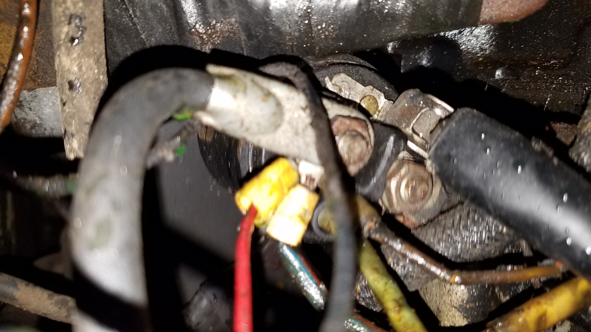

2 nasty pictures of my starter before I rebuilt my engine. One shows where the clip goes after sliding off the connector from your ignition switch, I put an arrow on the pic. The other photo shows it actually hooked up with the wiring all there.
Making a pushbutton and clips can be of what you have on hand. I am fortunate to have tools on hand. I started rebuilding and working on engines in the 1960's. It was my entire career.
The word counterclockwise refers to the direction the rotor turns when the engine is turning over or running. See how clear all of this is.View attachment 2581
Indeed it is very clear - and the way you explained also makes it absolutely clear. Thank you!!
