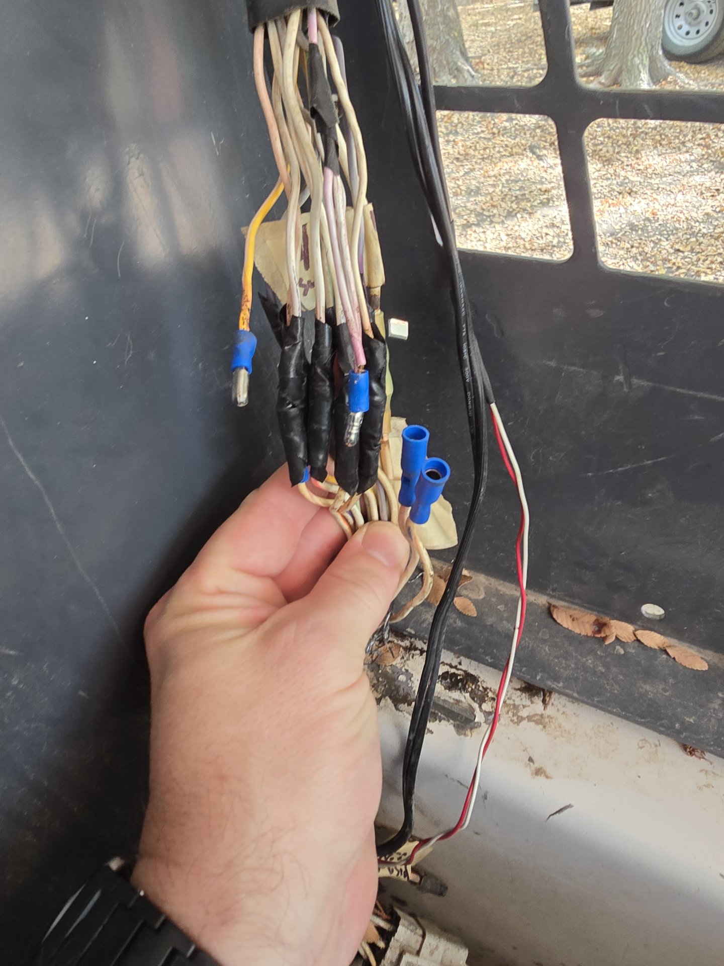

A few weeks back i purchased a 632. Runs pretty good, but didn't like only having the dummy light for engine temp. Considering there isn't much in the way of parts for this dinosaur. So i bought a coolant temp gauge for it. Wired it up.
Previous owner had a toggle switch to turn the ignition on then use the key to start it. He said that the battery would drain if I left the switch on. I knew it wasn't right, but the machine ran good and I just put that off as a project for a rainy day.
Well i hooked my gauge up to work with the toggle switch on, but as soon as I would turn the key on, my gauge would go blank. So I started digging into the wiring. Did you know that the dye they used in the wiring for a 40 year old Bobcat disappears, so now every wire is a white wire, yay! And then to top it off someone had cut out the plugs of the wiring harness between the rops and frame.

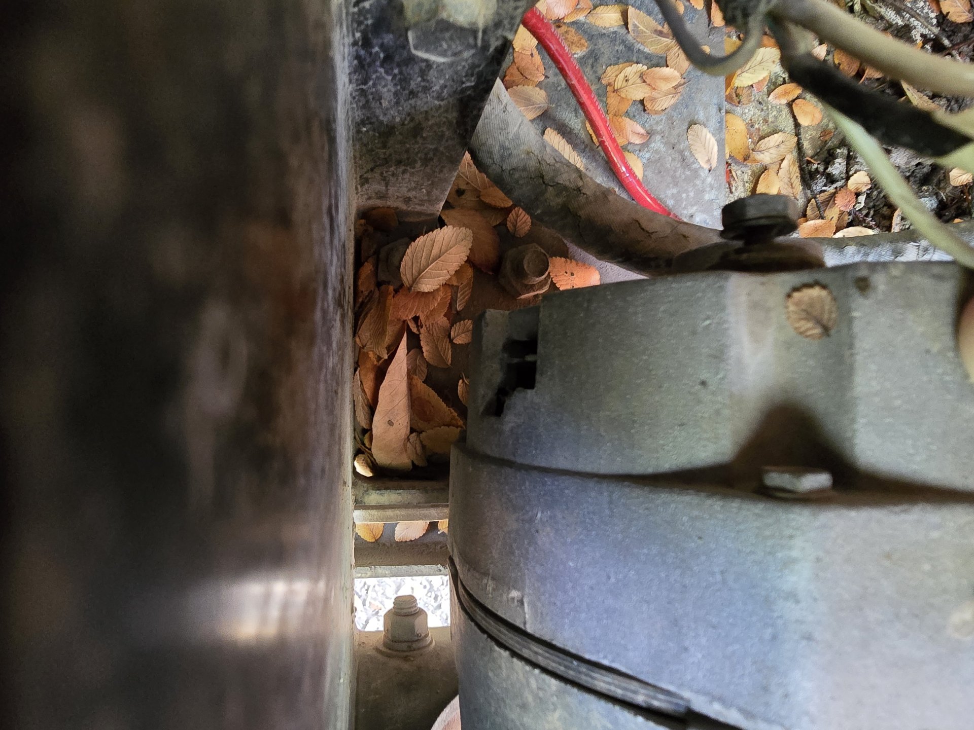

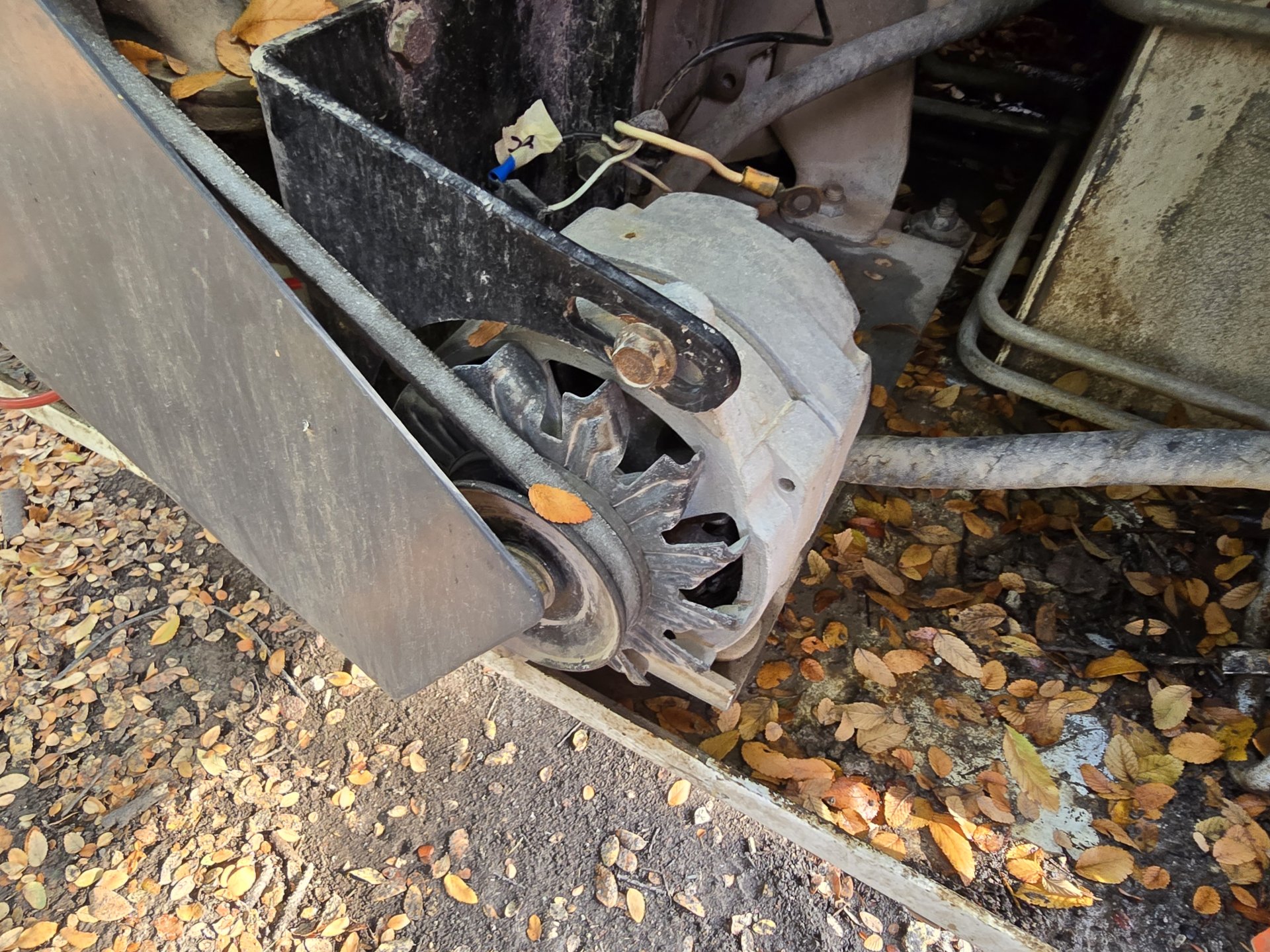

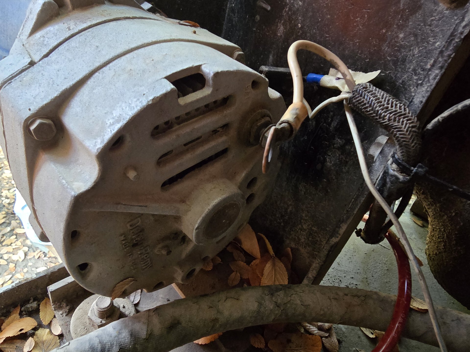

So after probably 8-10 hrs I traced all of the wiring out trying to figure out why my gauge would go blank and why did they have a toggle switch to stop the battery from draining. I don't know if the switch was faulty but the acc side of it would only work with the ignition off and the key turned to acc only. So I replaced it. Gauge worked but still had the battery drain. I ended up finding that the "batt" terminal on the alternator is creating a 4.5A drain. Now if I can just find a replacement that doesn't cost $175. The autozone near me can get an alternator for a 71/72 Pinto. Just don't know if it is a drop in replacement.

I would go down to the auto parts store, ask for the pinto alternator and match them up. My 642 has the Kent motor and I've done that more than once.

Take the alt to a auto parts store most of them will test run it for you for free.
They should be able to find a replacement. Or the parts to fix yours like the diode bridge, regulator brushes and alike. I would put in new brushes if they are short while you have it out and apart. Not sure if your alt has a internal reg but when they test they will know ask them if it does.
