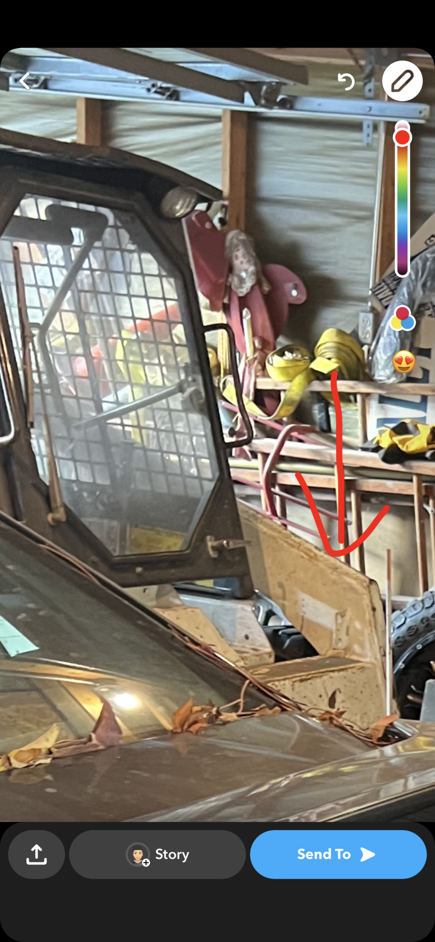

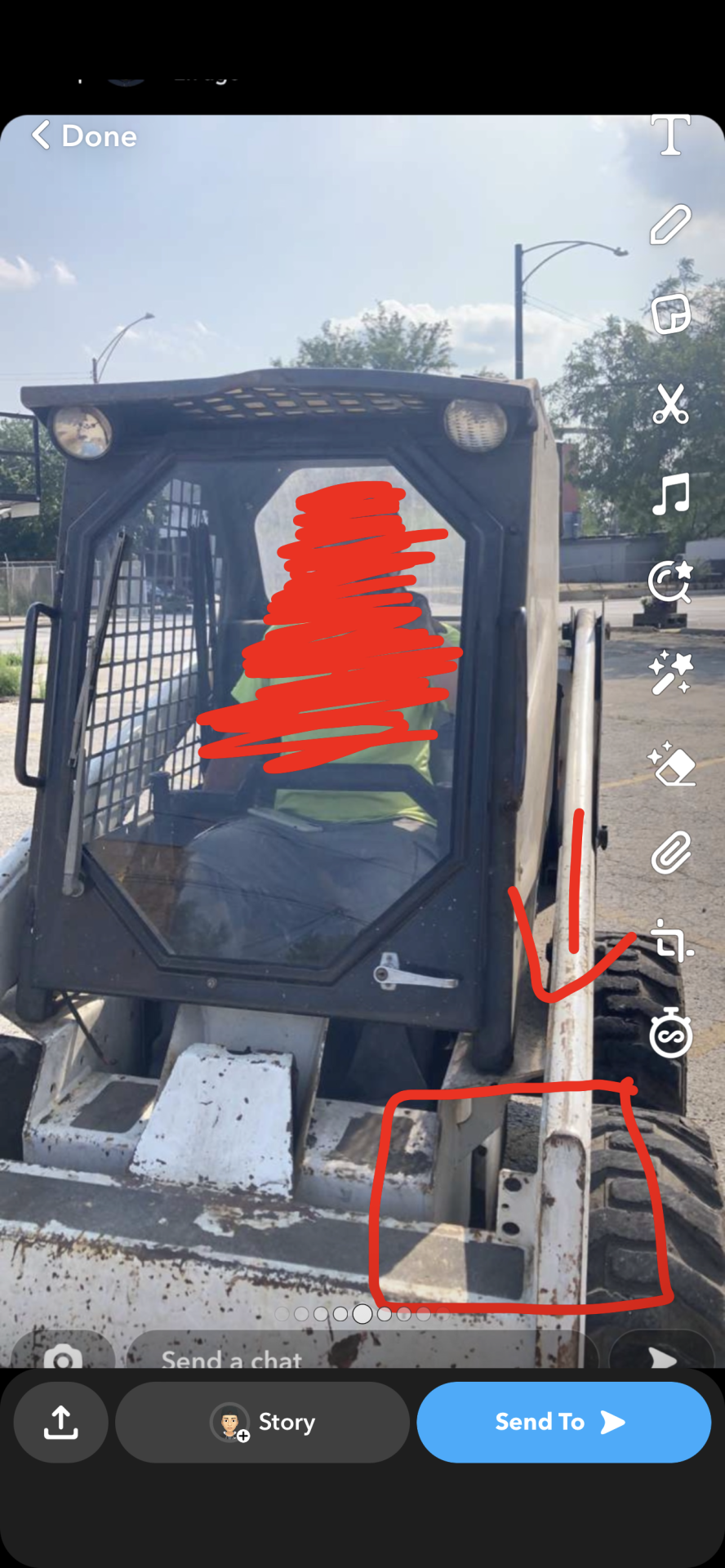

Hello. I purchased my first bobcat a few years ago in an auction and use for my snow removal business. It is a bobcat 743. Unknown year my guess is 80s -90s. But what I noticed is there are no auxiliary hydraulics on the machine so I cannot use attachments. It has just an empty bracket where the auxiliary connections mount on the front of machine. Was wondering if there is anyway I add them on or what. Any help would be great
I thought I didn't have aux hyd on my 743 but turns out I did . A bolt was locking it from moving L & R. if my knee accidently pushed it. Lift seat ( cab) to see if at bottom of R. hydro lever has a bolt in aux valve.
Did yours have connections on the front of your machine for aux hyd? Mine just has a bracket where the connections fit into but they’re not there neither are the hyd lines that are needed for aux hyd
I believe all 743’s originally came with auxiliary hydraulics.
I think that maybe over the years if someone did not need the auxiliary and it started leaking or the tubes got hung up and bent, they would just plug them off and remove them.

see I have a bracket for the aux hydro connections to be mounted. Just don’t know if this machine is equipped with them. If anyone can help that would be great
see I have a bracket for the aux hydro connections to be mounted. Just don't know if this machine is equipped with them. If anyone can help that would be great
Here is a link to the parts catalog:
https://partscatalog.bobcat.com/
You should be able to find the auxiliary components and where the spool is on the control valve.
I do see that at some point they were listed as an option so your machine may not be set up for them.
you can confirm by lifting the cab and look if there is a linkage from the lever to the valve, on my 743 both of them also had a 4th spool for rear hookups, the left lever had a lock bolt to prevent movement and a cable running to the valve, I believe the spool valves were all the same
