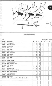

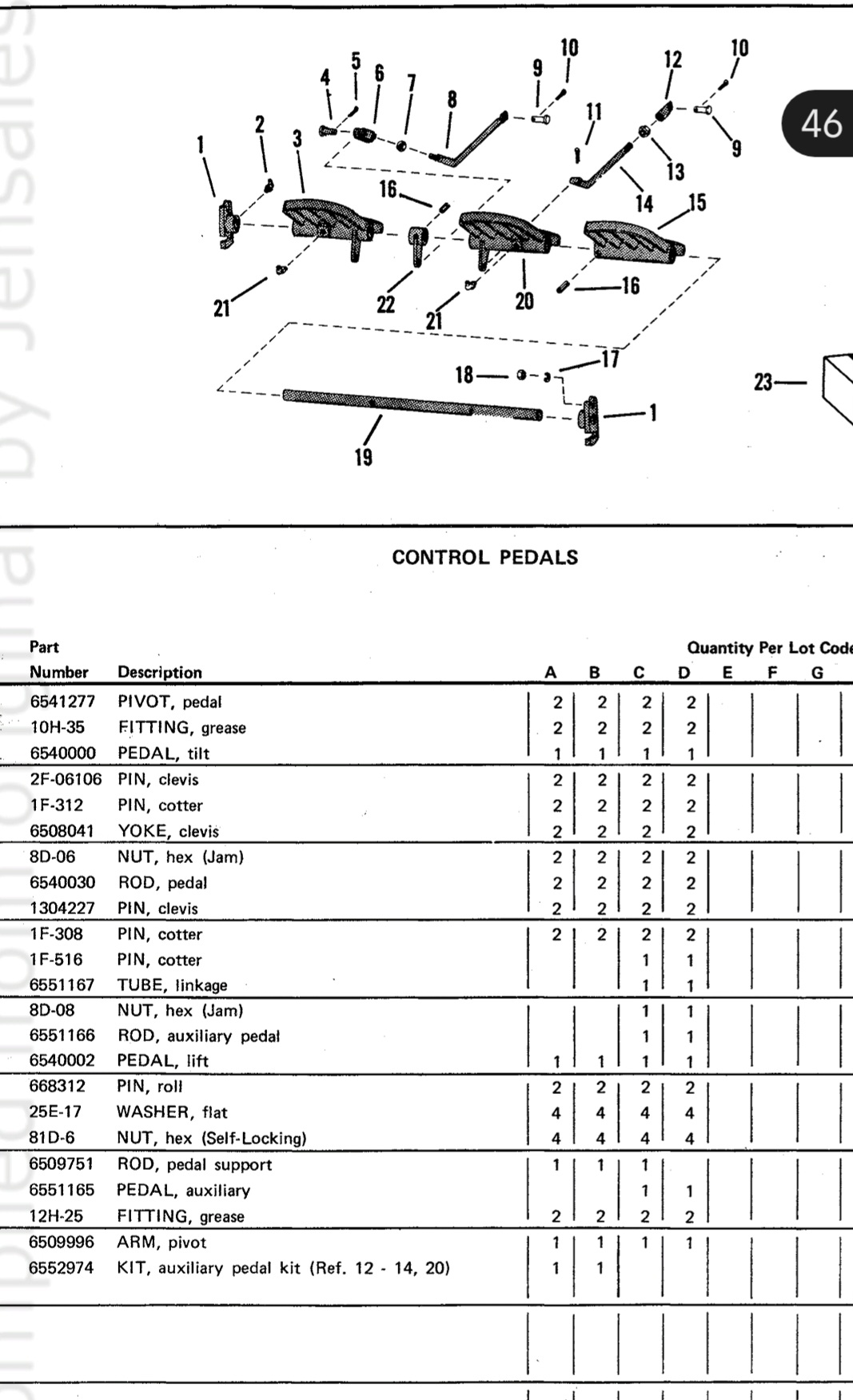

I don't have a answer for your question. But I have a question of my own. I have a M700 with the aux pedal. But I have no idea what it is used for. I'm working on the machine for friends of mine. And he doesn't know either. Just curious. Thanks.

Hi glad to help answer that! Hope it helps for what it worth.
So my auxiliary pedal is engaged by stepping on the toe (front part of pedal) semi hard and quick. It's like a rocker pedal. Once activated It supplies hydraulic pressure to a attachment/implement such as a grass shredder, auger, or a grapple. It has hydraulic hose couplers somewhere on your tractor. To release hydraulic pressure I press down on the heel side of the auxiliary pedal and the implement will stop. Hope this helps!
