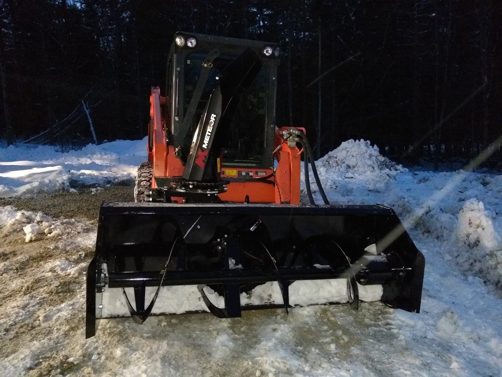

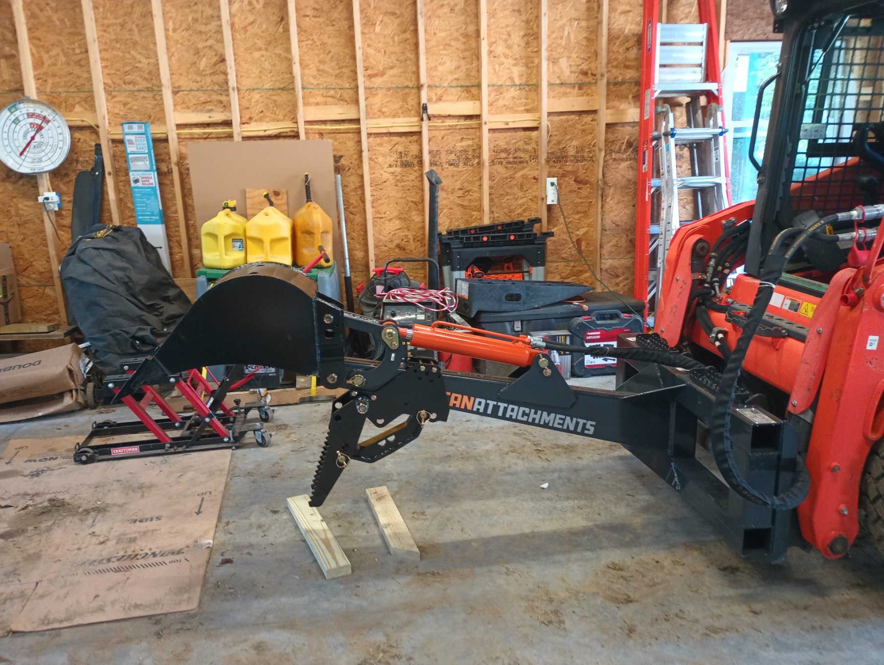

I have bought a snowplow, front hoe, pallet forks, and stump puller from palletforks.com (Titan) with no problems. The 76 in snowblower came from Meteor. An issue or 2 with that. I don't know why they would put the side step on the same side as the hoses. Also, I ended up wrapping the hoses in foam pipe insulation and used tie wraps to keep the hose from pinching.
