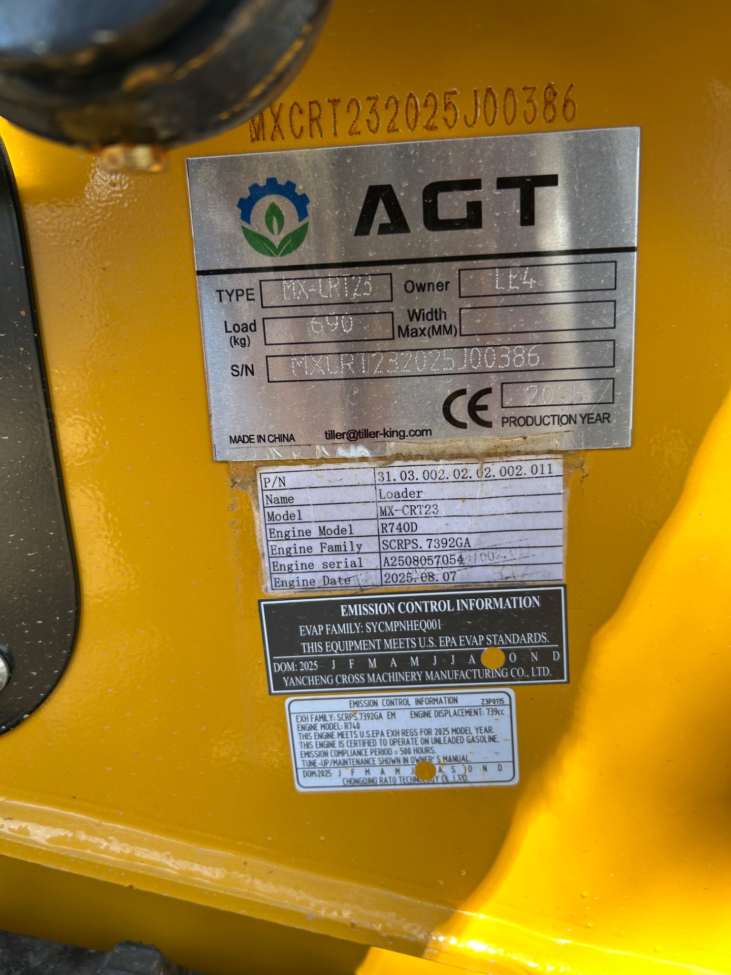

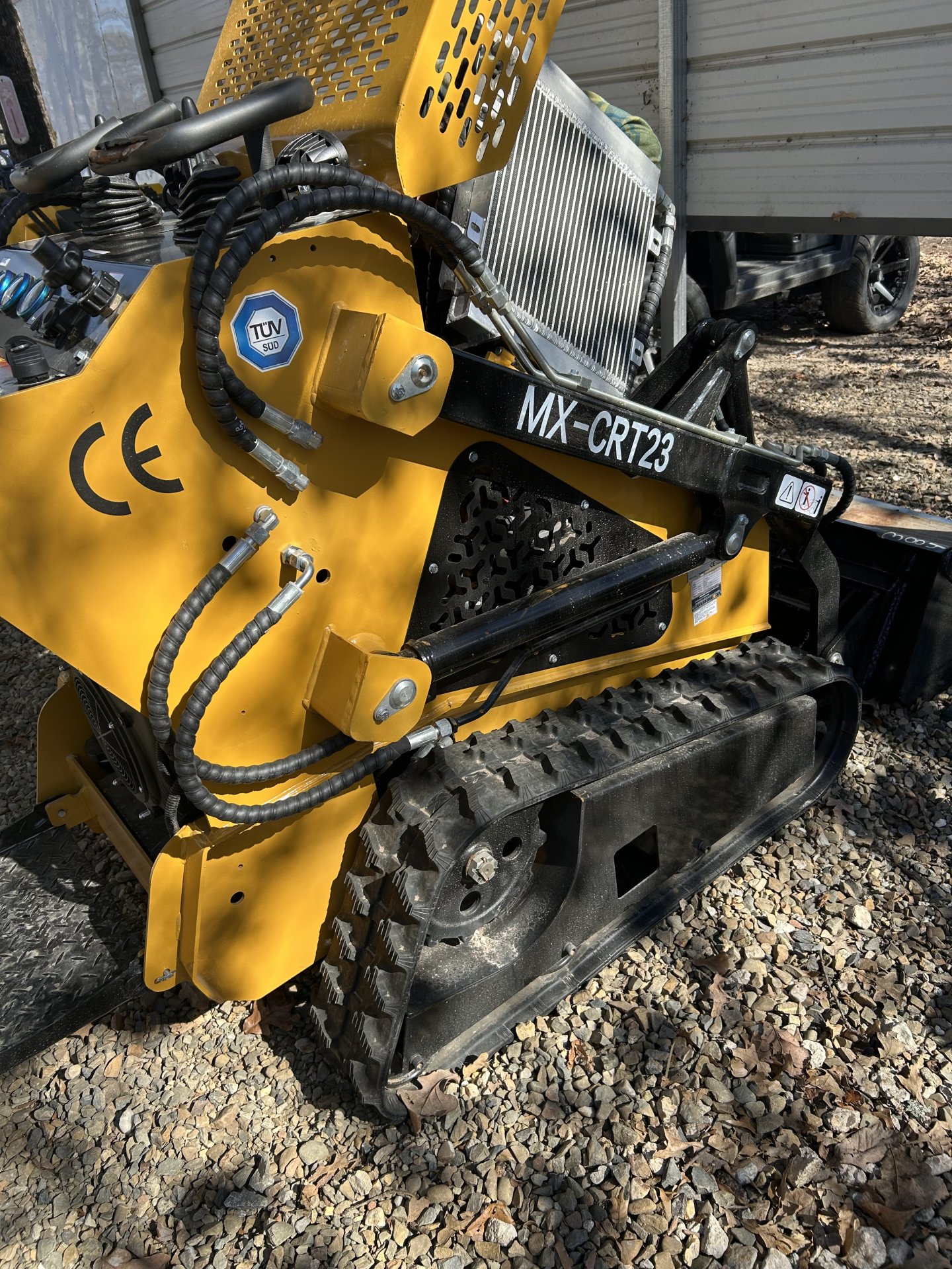

Hopefully there’s someone out that’s worked on one of themI know nothing about that machine but I would suggest to check all the safety points to see if you left something on that needs to be off when starting. check the manual.
Great video. Can you point me in the right direction as far as no spark on the engine.few other video on machine
I’ve already disconnected the low oil sensorwith gas engines there is a kill wire that goes from the ground and to the key switch and to the coil . take off the engine shroud off and disconnect the smallish wire on the coil ( they should be linked together if two coils) and retest for spark. Have you disconnected the low oil monitor as a test to see if it is defective? that will kill spark also if bad or oil level to low.
Figured it out. Was a wire on the kill buttonwith gas engines there is a kill wire that goes from the ground and to the key switch and to the coil . take off the engine shroud off and disconnect the smallish wire on the coil ( they should be linked together if two coils) and retest for spark. Have you disconnected the low oil monitor as a test to see if it is defective? that will kill spark also if bad or oil level to low.
