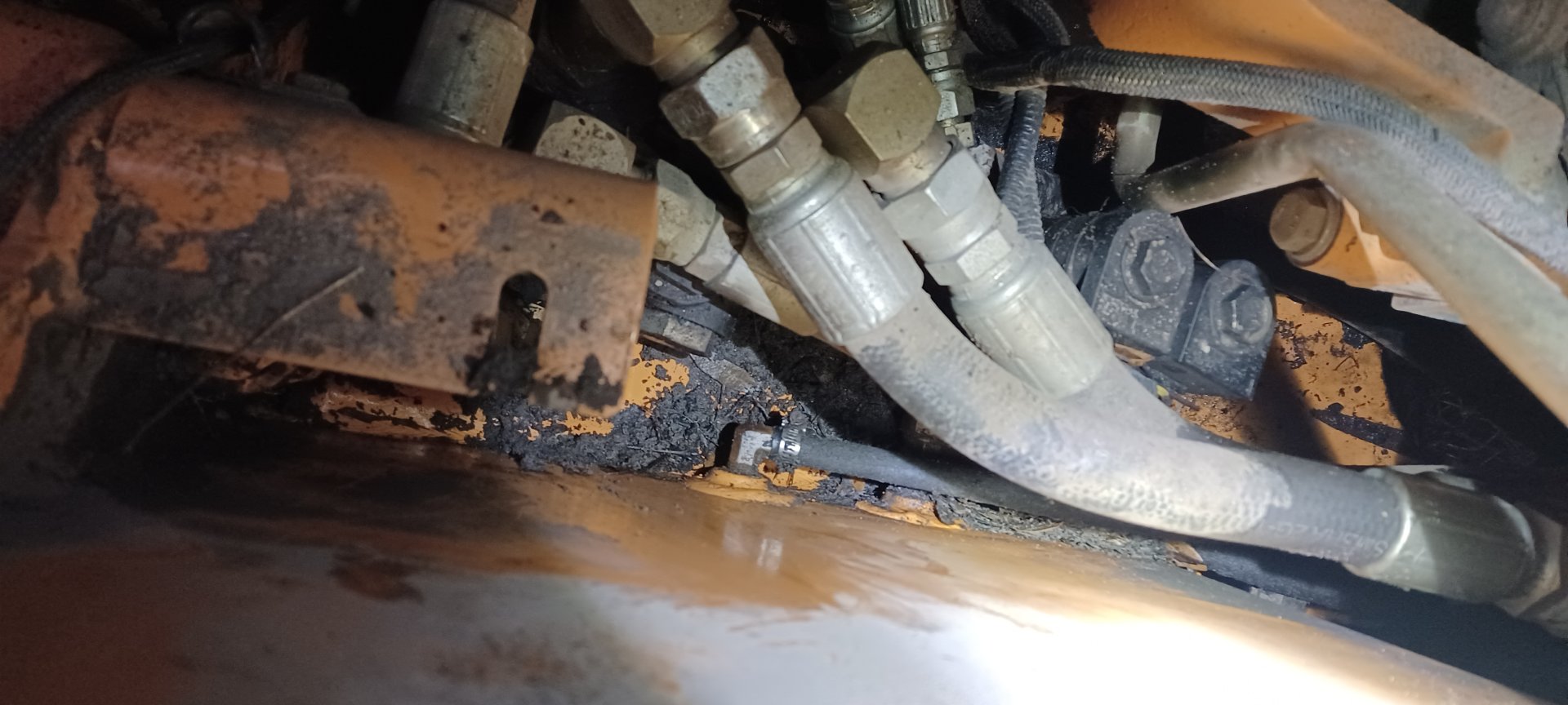

Richie here ..progress on the 03 75XT .....Answering a couple questions and leaving a couple pics ....1..radiator should be removed to replace fuel line ....I was able to swing out and hang oil cooler with straps ......removing fan shroud and fan helps a lot .....and there is the fitting....
