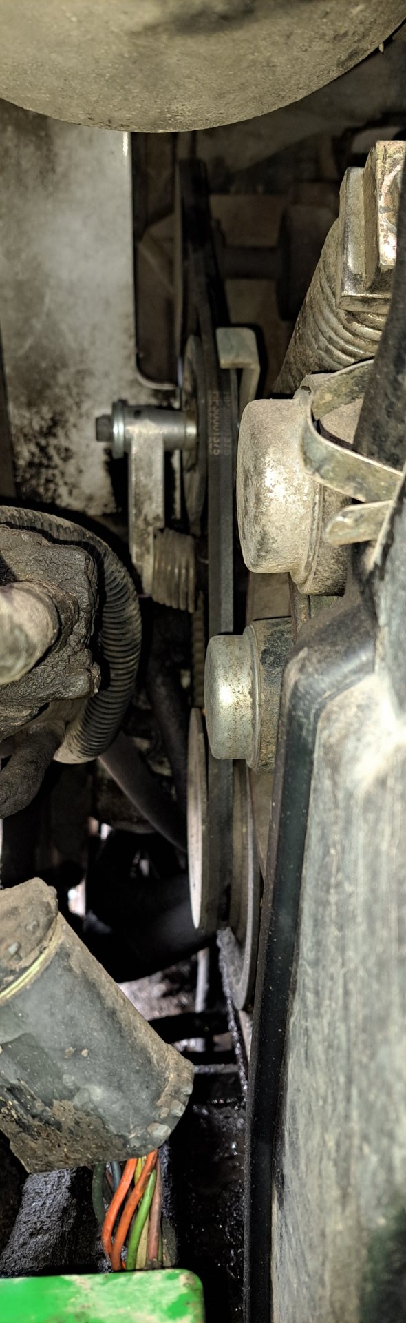

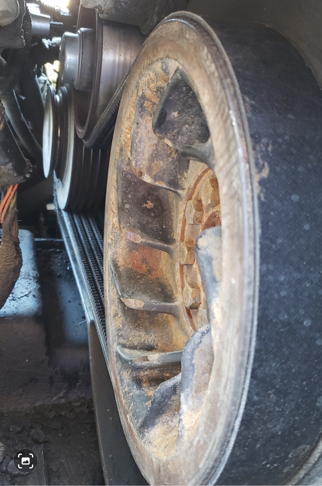

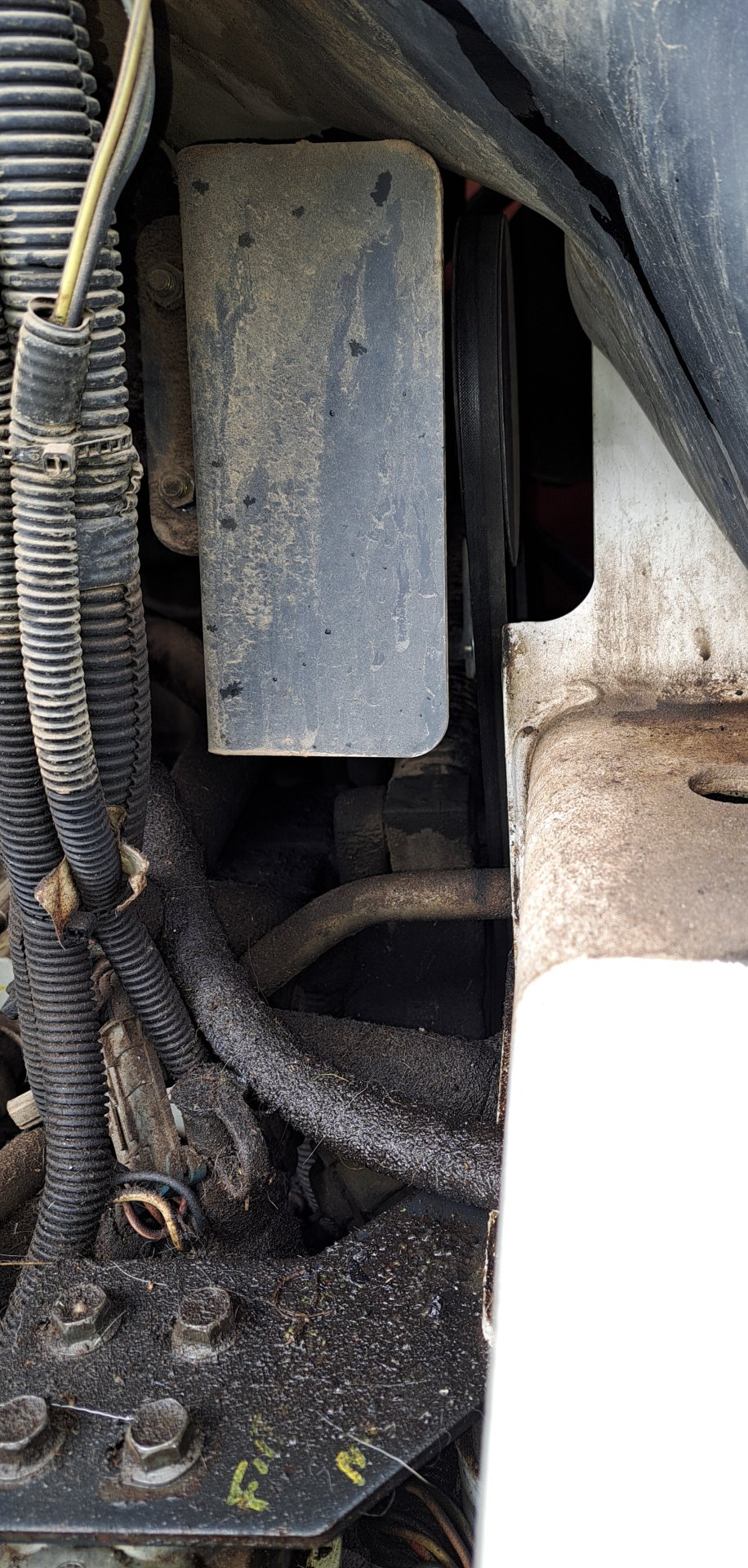

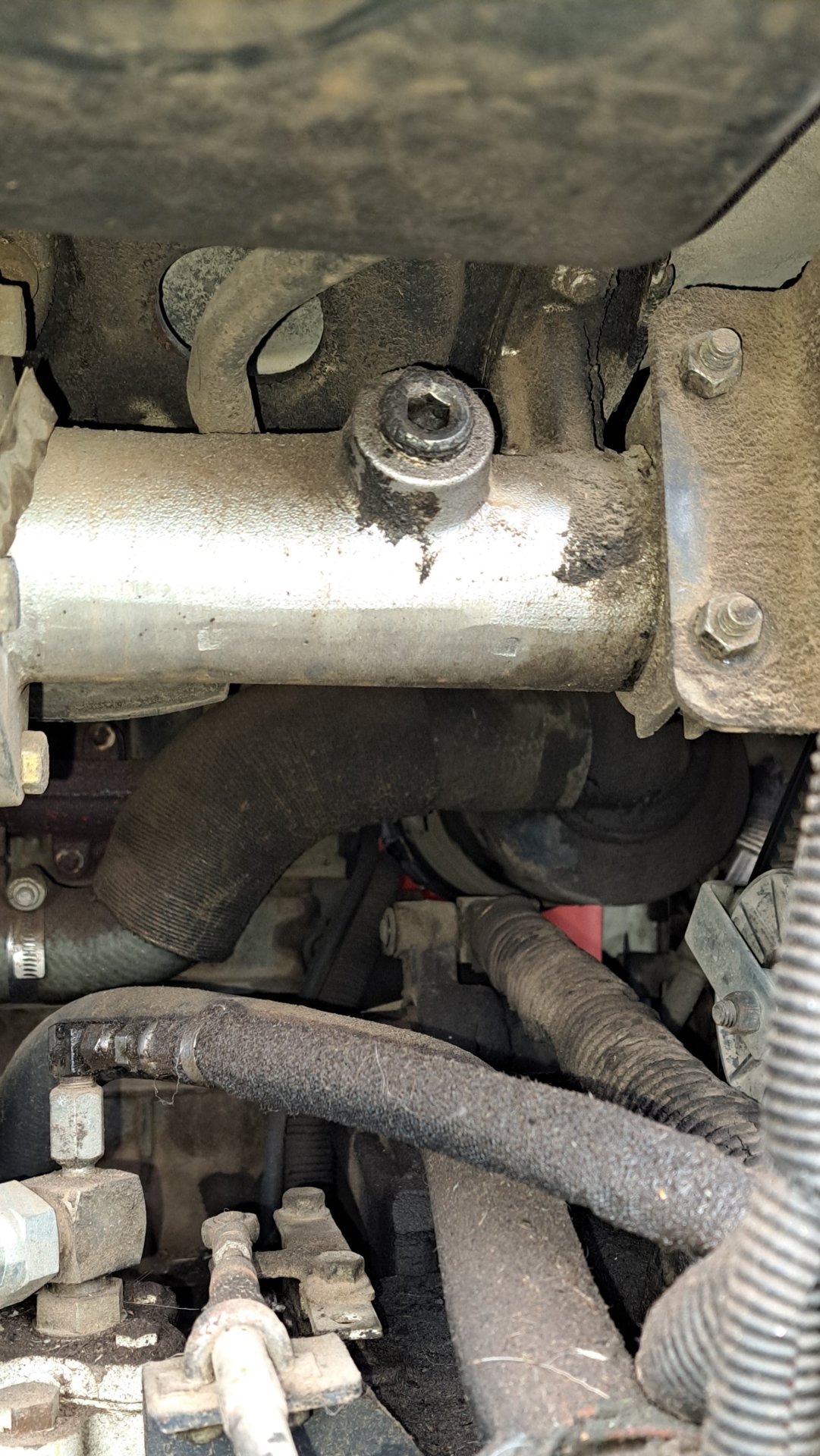

I did almost all of it from top (cab up) for the fan belt. Side note: if your Drive belt needs to be replaced NOW would be the time! I did them both at same time. That is mostly from the rear of skid steer. I removed the battery to make room. ( I think its a must to get the cover off) Glad I did, it was pretty worn..

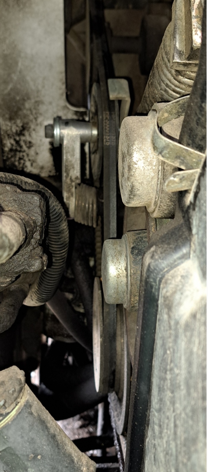

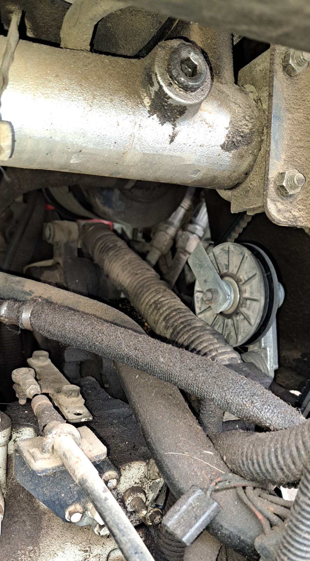

The drive belt goes on before the fan belt if so. Here are pictures looking from rear forward. One picture is it complete. The other is cover off no fan belt.
I ordered a tensioner kit and the drive belt but didn't see a fan belt. I thought the drive belt was the fan belt? Everything in the service manual only refers to the fan drive belt.
No, two different belts...the drive belt is big and has like 4 rows. Fan belt is like a regular belt.
You see the Fan tensioner & belt on left picture. The drive belt in right picture..

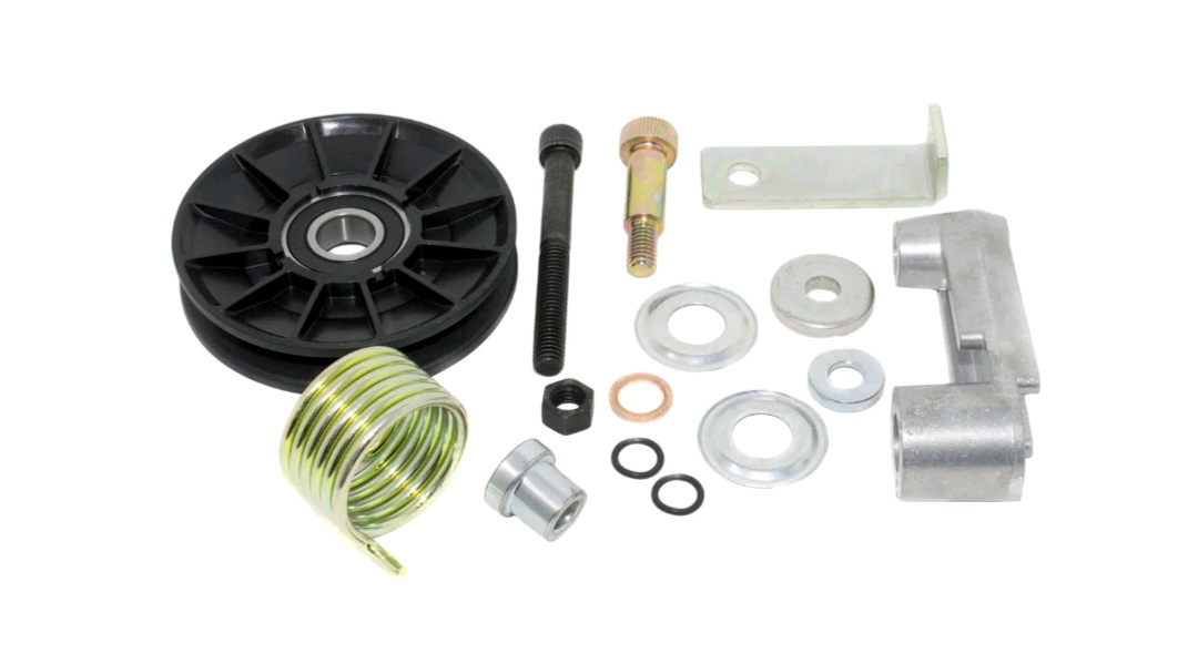

I think I am seeing this now. The manual refers to a drive belt or pump drive belt (rear of machine) and a cooling fan drive belt (cab raised). I ordered both with the tensioner kit. Hopefully the tensioner pulley for the pump drive belt isn't worn...
The tensioner kit Should have a new Pulley!
It's what goes bad on the fan belt system.
Check the kit. Usually $45-50 us $ .

The tensioner kit has the pulley for the cooling fan drive belt. The hydraulic pump drive belt has a different tensioner pulley and frankly looks more straightforward to replace than the tensioner pulley kit for the cooling fan drive belt. Now all I can do is hope I get everything by Friday so I can get to work on this on Saturday. First time raising cab for me too. Looking forward to getting this done so I can clear snow before more comes. I really appreciate your help!
