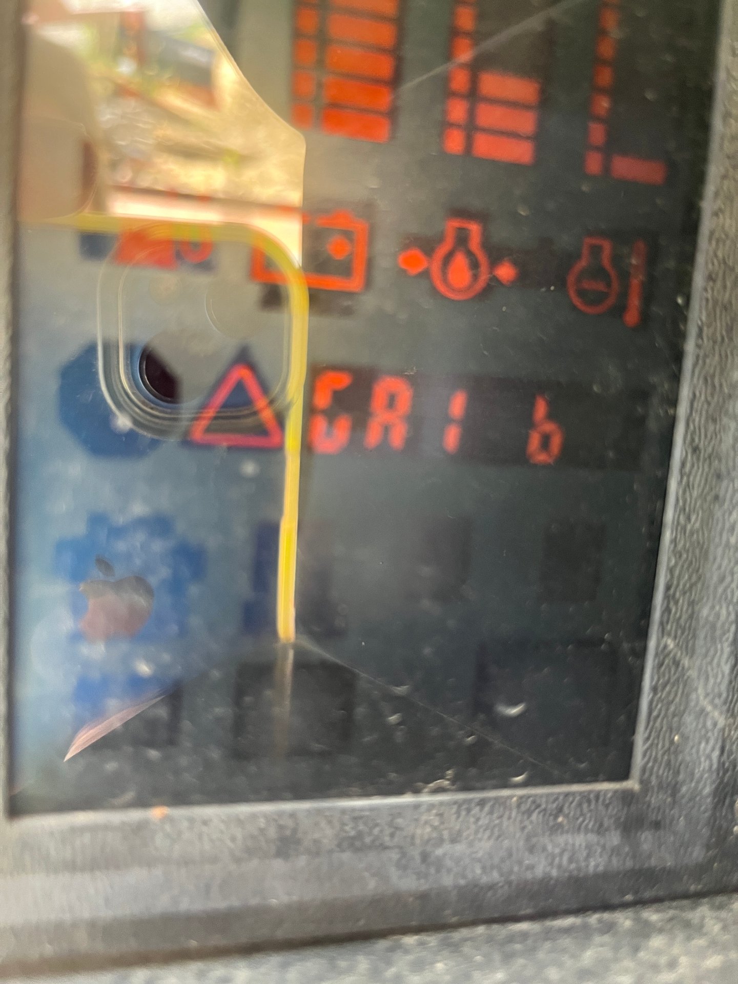

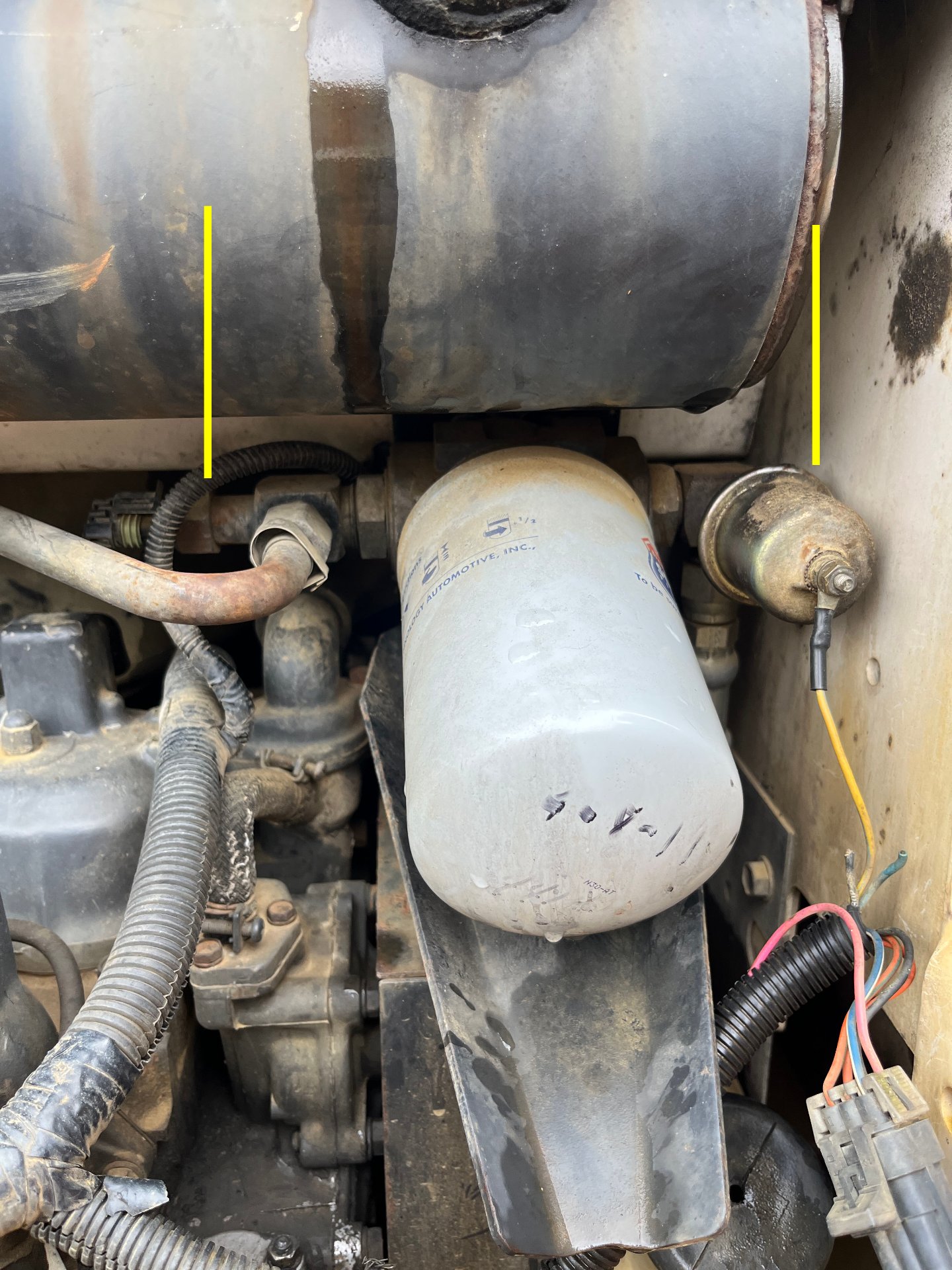

Does anyone know what the ohm resistance values for these two sensors are? I believe one is temp and one is pressure. I have found most sensor values but these two elude me. Still getting a goofy code on the readout and I don't believe it is a display issue as everything lights up when the key is first turned on. Starting to wonder if that is suppose to be a ground fault code of some kind? Just trying to avoid a $1000 Bobcat bill. Thanks in advance.

There only 1 single bulb in this display. When key is first turned on everything lights up on the display as it should. So I don't believe the issue is the display, more of a sensor out of range or not working at all. Could also be the Aux Hyd control module, but since hand control switches have not been connected for almost as long as I've owned it I don't think that is my issue. This one has been a head scratcher for sure. Thnx for responding FCB!

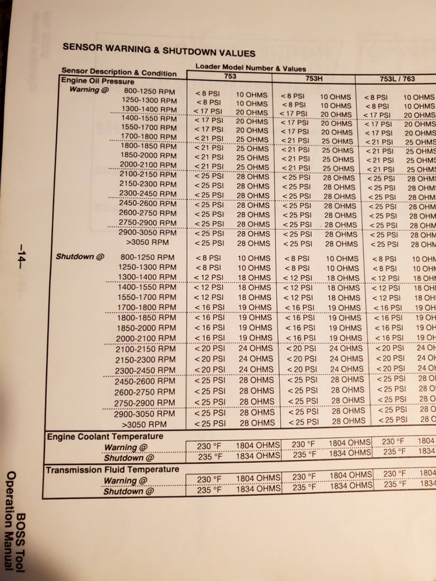

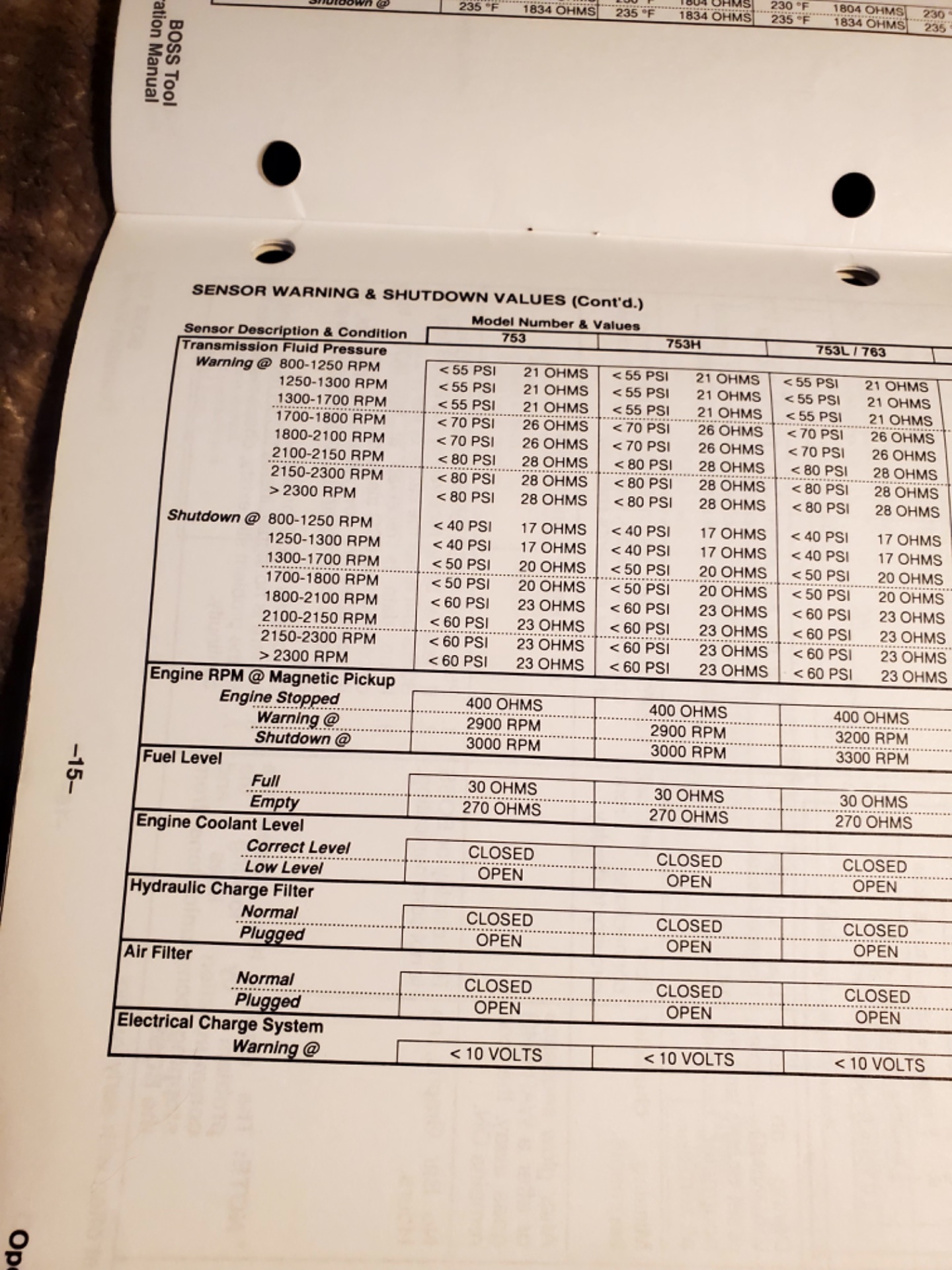

See attached specs for transmission temp and pressure sensors. This is from the BOSS diagnostic manual.

Hey Dale! The two sensors I've been looking at are in my original post. (yellow lines run down towards them) The 2 prong on the left side I was checking between the 2 leads, the single post on the right between that post and ground. Have you had any issues with your BOSS system?
KMM, I checked my machine. Left sensor with plug removed: 1.021K ohms point to point. High resistance - had to swap meter scales to see the reading. Right sensor (I did NOT remove the wire) - 68 ohms point to ground.
Any questions, let me know.
Dale
Thanks Dale. Both of my readings are very similar to yours. I guess I can rule these two out lol. Back to the drawing board.
I think you need to figure out first what kind of code you getting! These goofy numbers could be anything.
You might wanna look into tearing your BOSS Display apart.
I've torn it apart, cleaned all contacts, air dusted the carbon connections from the display to the circuit board. No visible signs of component failure, but no schematic for the circuit board that I have found. If it was just the error numbers/code I could deal with that, but the "warning beep" is constant and annoying as all get out. There is a company that will check the display for $700. I figure I could bypass the entire BOSS and get gauges to cover most components for less than that. Damn electronics to "make life easier" never do lol.
