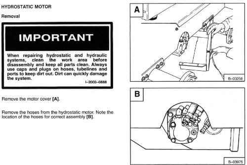

Does your book say anything about how the cover comes off? I couldnt see any screws or bolts to hold it on, it kind of looks like its pressed on, but I dont want to pry on anything until i know how it is attached. Thanks for your reply i appreciate your help
The book doesn't offer much help, but the illustration indicates that there are 4 mounting bolts at the bottom. The parts book indicates seal strips that help to bond it to the rest of the chassis.
text
Thanks for the picture I think that will help me a ton. Thanks again for your help
