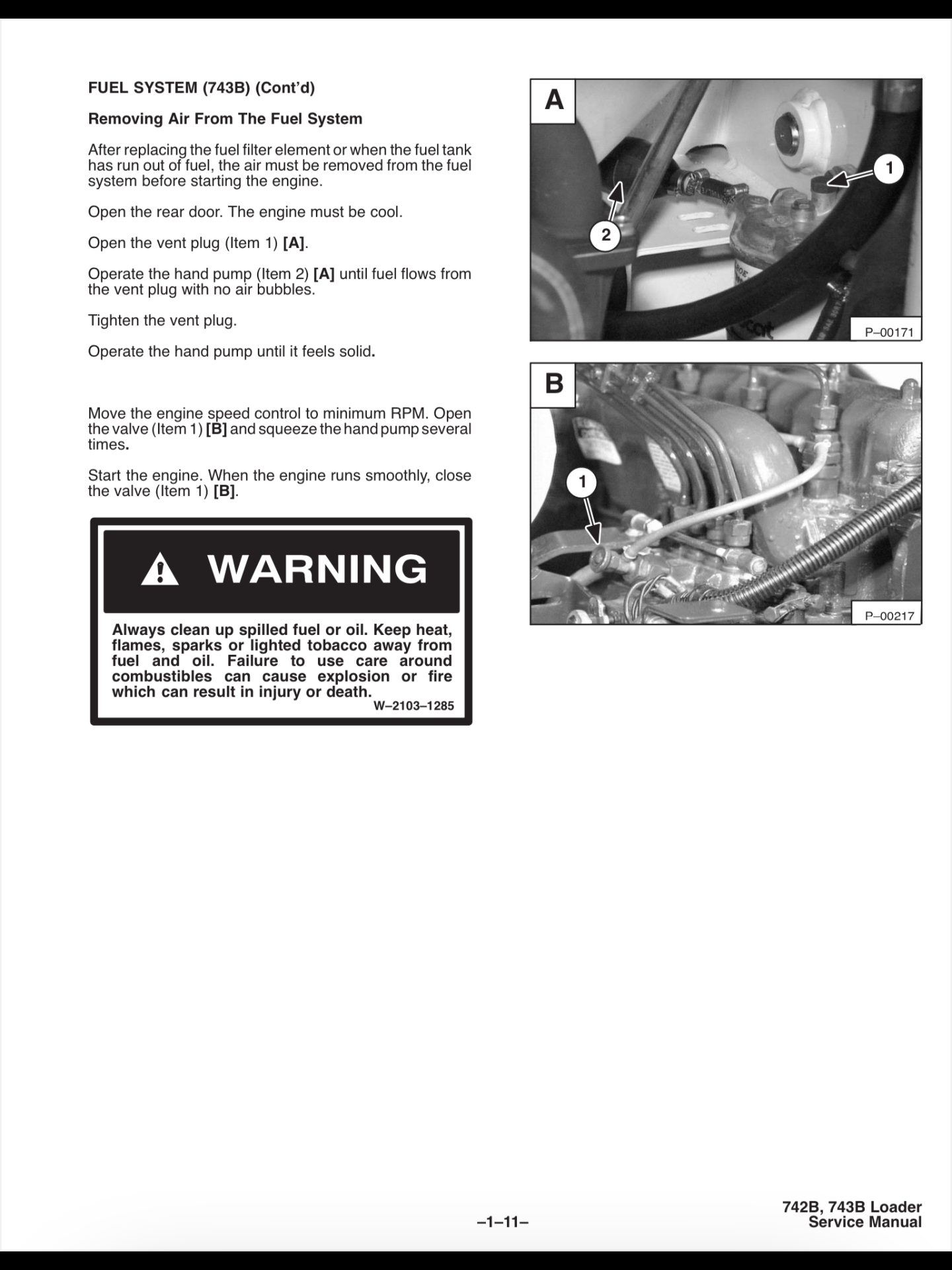

Your fuel tank is 13 gal. That is from the manual. I had a 742B and that is what my tank was.
As for the fuel gage….do not trust it. It works with a foam "float" that deteriorates over time and does not float as well anymore. Look in the tank with a flashlight to give yourself a better idea as to where the fuel level actually is.
You may have run out of fuel because your fuel pickup line has either cracked or broken off in the tank. Not hard to replace.
I will attach a photo of the pertinent page for what to do after running out of fuel.

I got the vent open (1a) but the bulb is so stiff or I am so weak I can't compress the bulb.😞... sucks getting old lol
Your fuel intake may be clogged.
If the bulb needs to be replaced, or not, remove the fuel line on the tank side of the bulb and blow low air pressure down it. This may unclog it. There may be a check valve connected to the end of the fuel intake so do not use high pressure.
You should also pump some of the fuel out of the bottom of the tank from the fill hole to see if you need to clean out your tank.

okay I followed the instructions to the best of my ability and it's running sounds smooth I'll see if it can do some work. thanks so much
