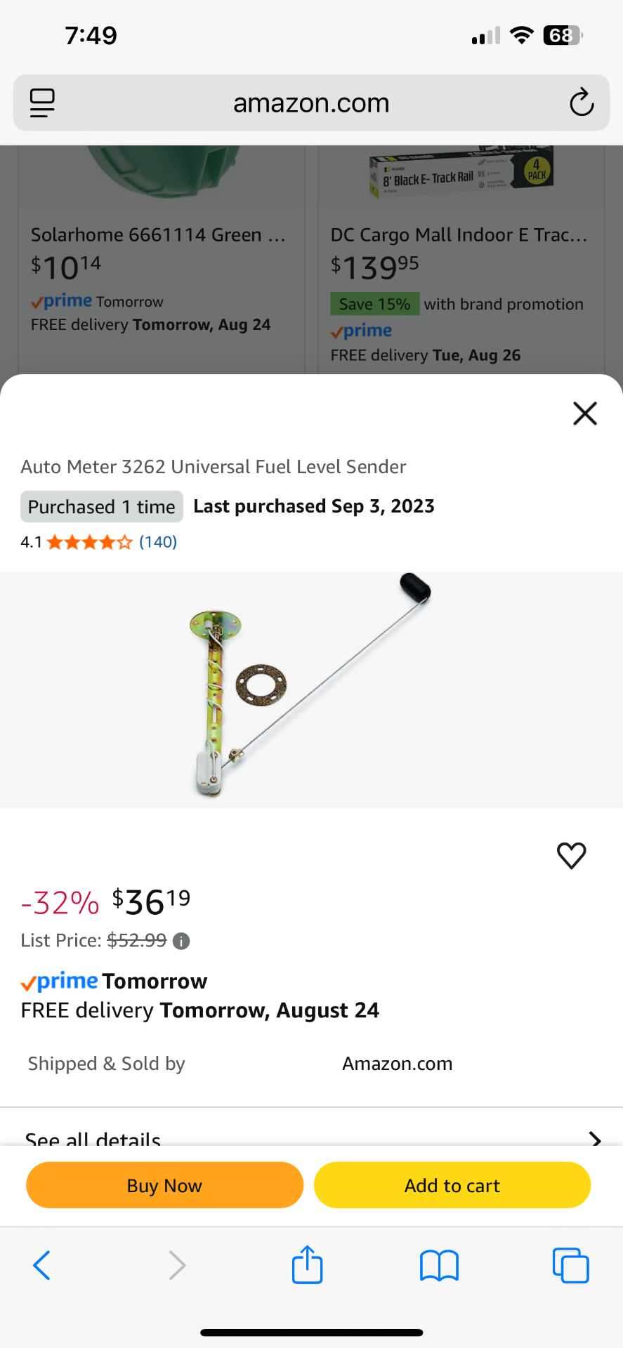

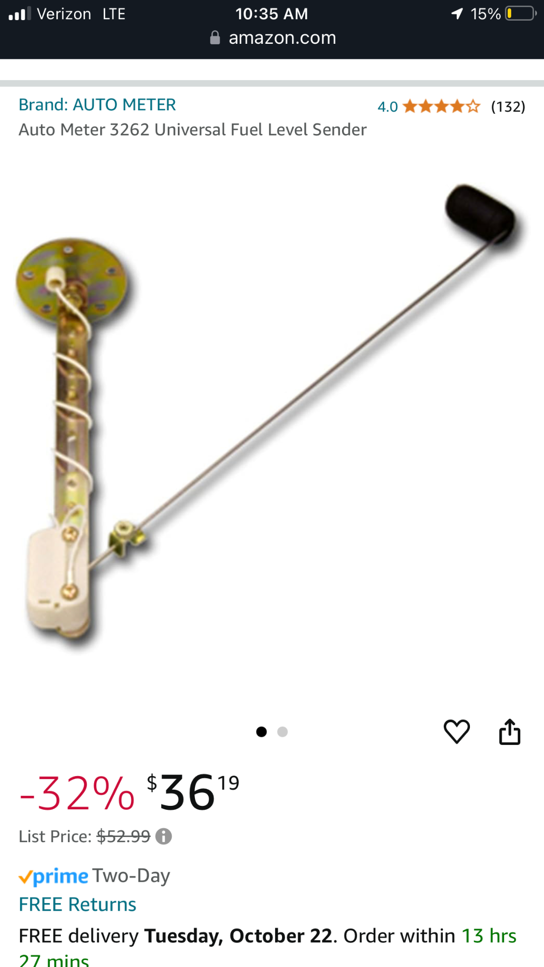

This one worked just fine for me. You’ll have to adjust it properly outside the tank before install.

I believe it is part number 6568175. Check in the parts catalog to make sure:
https://partscatalog.bobcat.com/Bobcat still sells these. Or you can try aftermarket like here:
https://stores.allskidsteers.com/
I ordered that # fuel sensor, my original has two leads on the top the new one has a center bolt. Mine has two black wires together and one wire on to its own.. my question is how should i wire it if i only have on post and the two sets of wires ,, one being a double black the other is single,
I put the one lead to the post on the sensor. and the doubled up black one , i went to ground. how ever now the gauge needle pegs to full? and i know theres only about three gallons of fuel.
I’m 2000 miles away from my 743. In every picture I see of the 3262, there are no wires, just a post to connect a wire to. Are you sure that you received the correct part?
If I remember correctly the 743 has a plastic fuel tank ,so there should be a wire going to the center post of the sending unit to the gauge and a wire from the base of the sending unit to good body ground.
Seems to me full ground = empty and no ground = full, if I remember right
