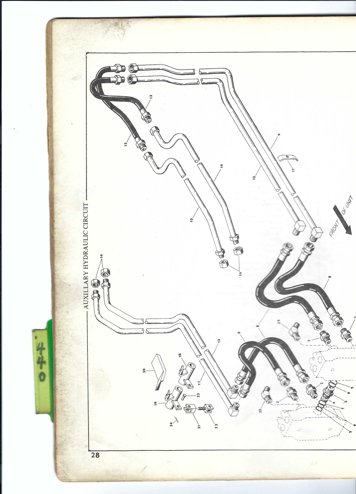

How would a guy go about figuring out where what and how to put a aux hose on his danfoss pump? Mustang called it something else back in the 70s, the manufacturer of that pump currently is danfoss.
When I got the skiddy there was no attachments, when I pulled the center frame out to put the new motor in it I saw some plugged off ports.
Any help would be great, been pondering this for a little.
does it have the 3rd spool on the main control valve, if it does u can probably fabricate your own
pedal / lever setup and hoses
You basically spoke French to me firefighter. I'll look up what that means later tonight and see if I can spot it.
ok looks like it came with auxillary hyd from the factory
Mine only has 2 pedals. I don't believe I have those lines floating around but it's been a year since I was into that system
