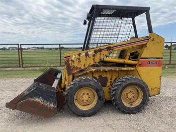

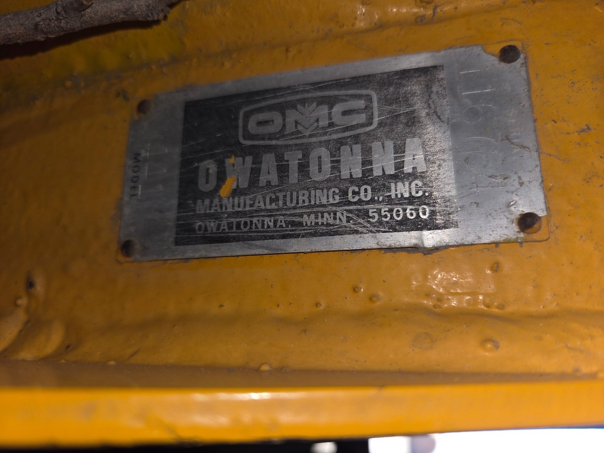

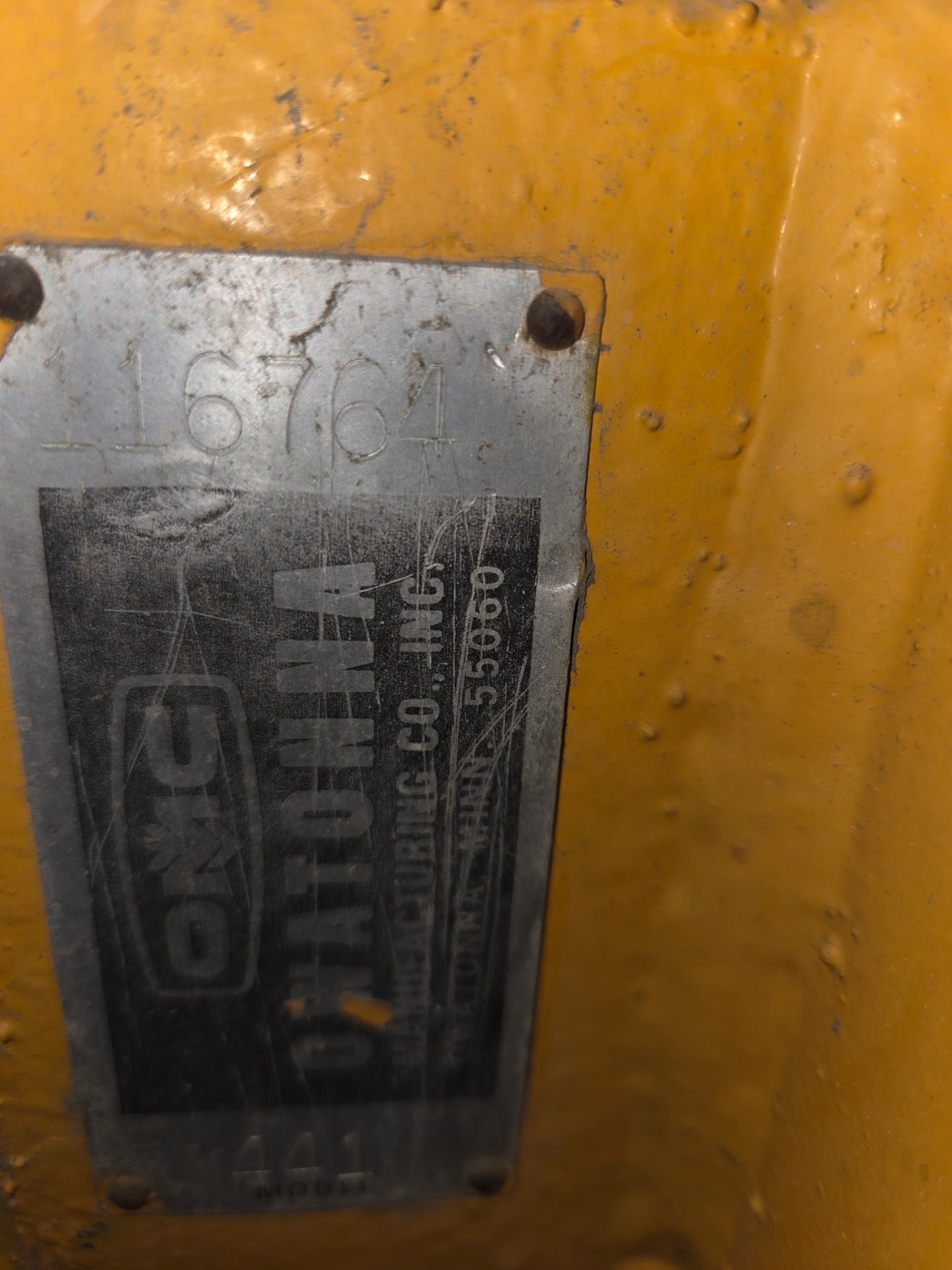

Hi there, my parents have a very old OMC Mustang 441 skid steer. We had a local mechanic look at it and he said the rear axel seal is leaking. Does any know where to find parts for these older OMC skid steers? Any help would be greatly appreciated.
Find a Gehl Or Mustang / Manitou dealer they should be able to get them, bearing & race part numbers are 044204 & 044205
seal number 335-20740. i keep those at my shop as they are the same in the later model mustangs
