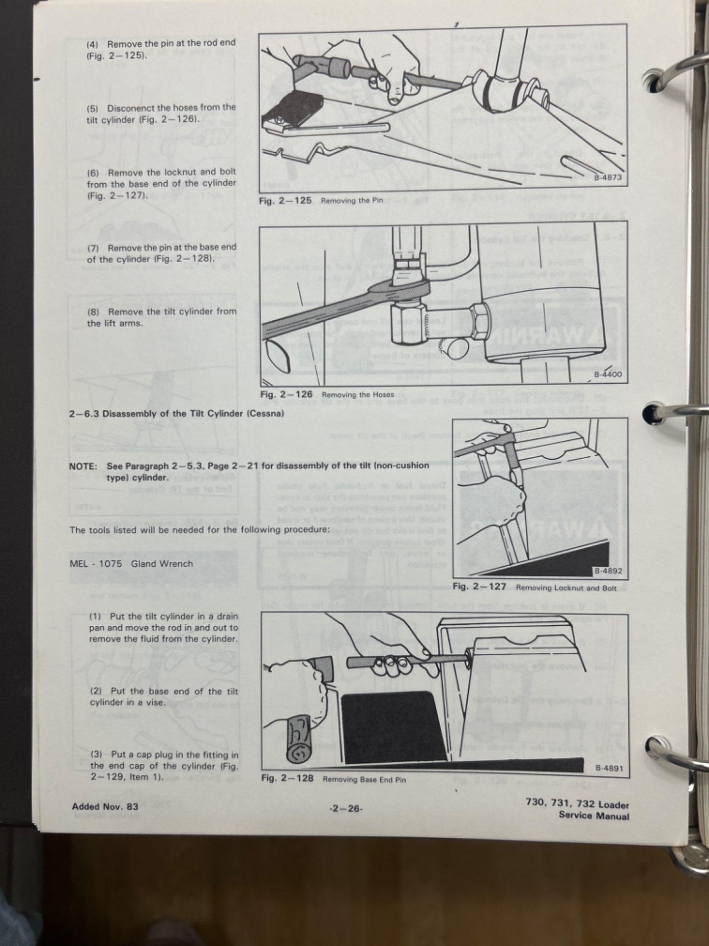

It's actually not threaded on there, it has a retaining ring that you see in that little slot you talked about. You need to dig one end of that ring out then pull the whole ring out as you turn the head of the cylinder. Once the retaining ring is out the whole head, shaft and piston assembly comes out... I've done it way long ago and it can be a bit of a bugger to get the retaining ring started on its way out but once started it comes apart quick and easy. Here's the page in the manual that shows how it's done. Hope this helps.

Thank you all. Yesterday afternoon I found a video on how this is done. I went back to the dealer and they had not been able to get it apart. I offered to show them the video and they weren't interested. I retrieved my cylinder, came back to my shop and got to work.
This is called a square wire retention system. The Cessna cylinder I have isn't the only place it's used. Cylinders like this have been shown in videos on Kubota, John Deere and Cat as well as the Bobcat I have. The procedure shown in the above post is the correct way to go. What they don't make obvious is there is a hook bent onto the end of the square wire. This hook is what allows the wire to be pulled in to form the retention ring and then pushed out when the time comes.
What confused everyone on my cylinder was the hook had broken off so the gland just rotated with nothing else happening. I noticed the hole in the ring track and made a pin to fit which allowed me to push the square wire out.
Now the two challenges will be: 1. The seal kit is not the right one for this cylinder. The main piston cup is 1/2" thick and there's nothing in the seal kit that thick. and 2. finding a new square wire for the retention ring.

Glad that worked out for you. What bothered me is if that hook may be broken off and as you said it was. Good we have that enginuity to make things work. Thanks for the follow up.
