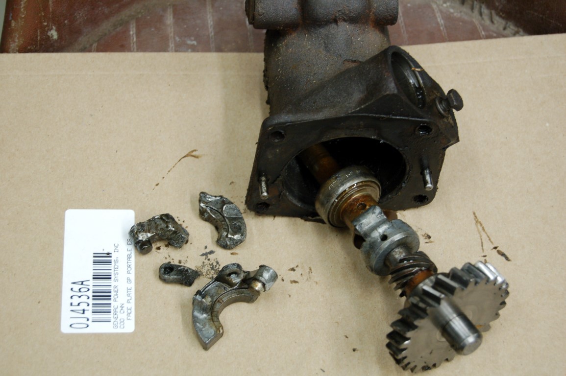

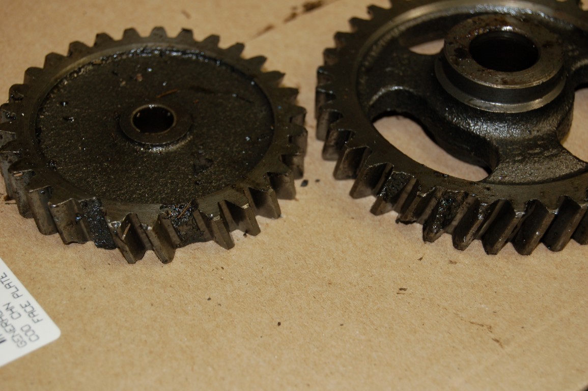

I gave the old motor to a colleague who always wanted one, he says. He stripped the motor and this is what he found:
20150311_02.jpg width=400
So, it seems that it was the correct choice to re-engine the little machine. Wow, I really feel relieved that I did not spend the money in vain.
If anyone wants some of these internals, my colleague is prepared to sell them for a very reasonable price - of course you'll get the good stuff, not the broken parts :)
Update.
Just a little damage there :)
