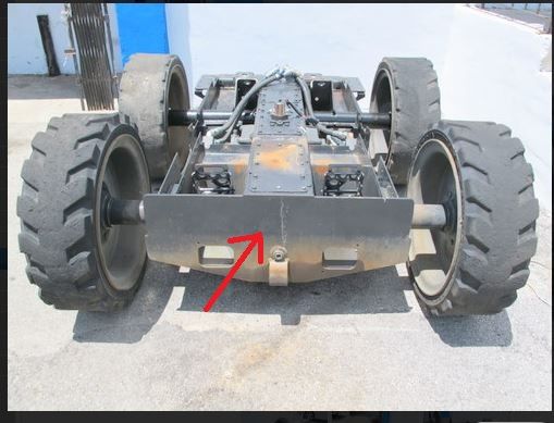

Thank you I will look again unfortunately I think the plate is missing is the number stamped anywhere else?
There is supposed to be a hidden serial number stamped on the chaincase but its only pin punched and very hard to find most times.
Thanks you sure know a lot about bobcats. There are four holes but no plate where you said. Is the pinpunched number on the front or rear? Thanks.
On some models its around where I pointed the red arrow but I've heard other owners have found it on one of the sides. Only Bobcat knows where they put it and won't tell anyone but law enforcement where it is. It's hidden so that it can't be easily ground off when a machine is stolen. Most police agencies will confiscate a skid steer that doesn't have a serial number plate and won't let you have it back until you prove its not stolen.
