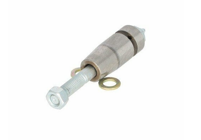

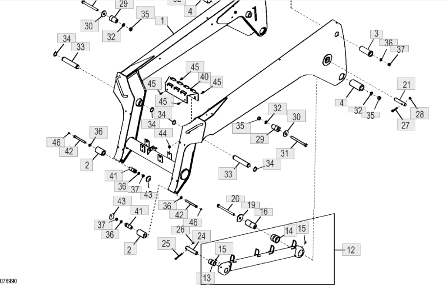

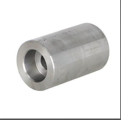

I'm trying to remove the tapered pin from the loader arm (number 41 in this image). I was able to remove the bolt and nut (42 and 37) and tried to heat the arm and drive the pin from the outside in. The pin boss (number 2) is what is welded onto the loader arm and is stopping me from easily accessing the tapered pin since there is a flange which the bolt/washer is used to hold it in place. I attached a picture of the tapered pin (second image) that fits into the boss (third image) and the flange that the bolt/washer is seated against. Has anyone been able to remove this and were special tools required?
It should just knock out. Nothing should prevent the taper pin from coming out once you remove the bolt and nut. The pins are changed frequently because they wear out. If yours is not coming out easily, there maybe something stuck or blocking it from coming out. I suggest you just try hammering it out from the outside in once you are sure the inside hole is not being block by something. You can use the bolt with washers or something that contacts the outside surface of the pin to knock it out.
