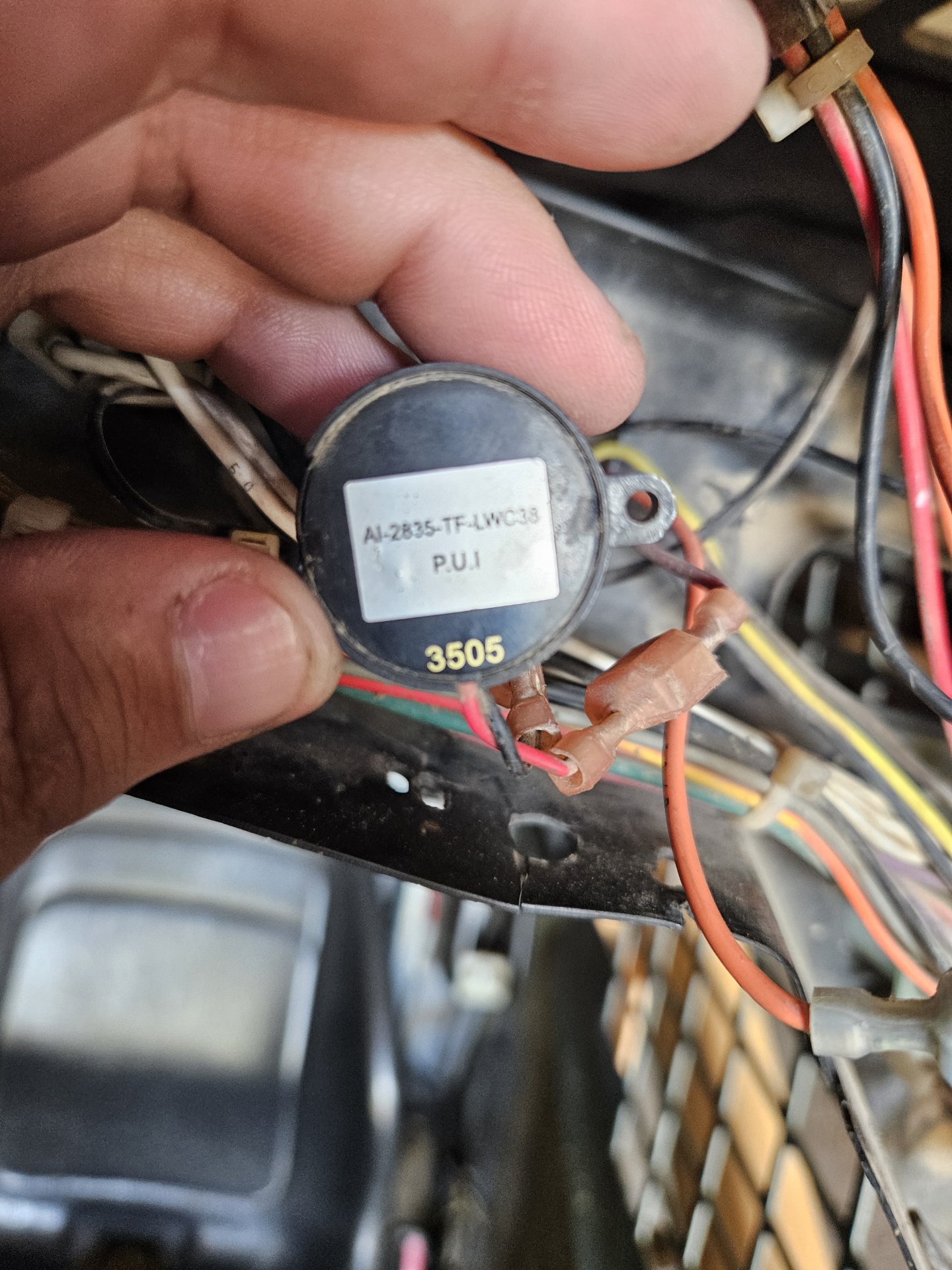

ok what is the model of loader, they only used one style thru out multiple models. timer mounts to the rops behind the dash
This the only thing I see by the switch
    450 KB
Okay that was the buzzer, I follow the step and when I turn the key the green light on the parking switch doesn't come on and when I start the machine it instantly die when before it would stay running. I plugged everything back up the way it was and still no power to the switch and instantly dies.. I checked the fuses all was good. Anything I'm missing?
that is normal for the green not to come on till loader is running, if it runs for 2 seconds & shuts off it is probabaly a seat belt seat switch fault, turn the pedal lock switch into red, does it stay running? if the loader shuts off as soon as the key switch is released, from the start position it is usually a fuse, rotate the fuses, i have seen fuses that look good that are actually bad
It runs for about 2 seconds and dies. The light indicator for seat belt comes on when plugged up. It did not die like this until I attempt to bypass timer. I put everything like it was before and light still doesn't come on switch when before it would be on when key is turned
