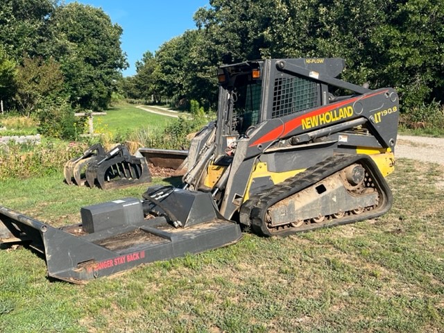

New guy, Joined in hopes of finding some help here. From the looks of similar posts there isn't much advise.
Going to give it a shot anyway. I have a 2005 LT190b. I am currently getting a crank no start issue. It will beep when I get in the seat. Seat belt light goes off when i plug it in. Will only crank. Flip the switch to service mode and it will fire right up. Once running in service mode if I flip the service switch off it will die. If I leave it in service mode I cannot unlock the hydraulics/parking brake. If I move the auxiliary handle the attachment will move but it will kill the engine. I have tried starting it with an attachment hooked up and not.
I had a prior issue with the crank no start being the auxiliary was not neutral so I have been messing with that but no luck. Any ideas?
All of the fuses in the cab are good. Haven't tried to reach the engine compartment yet since its such a pain with the arms down.
