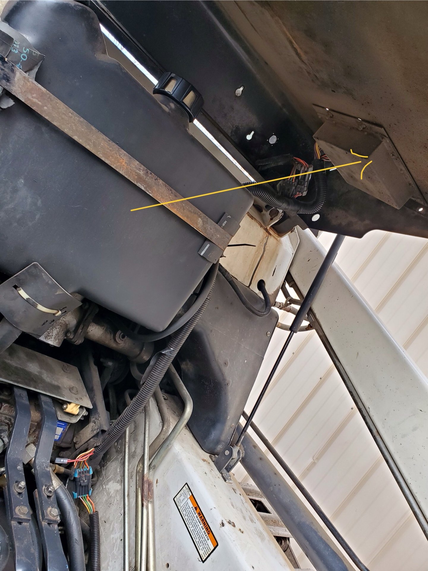

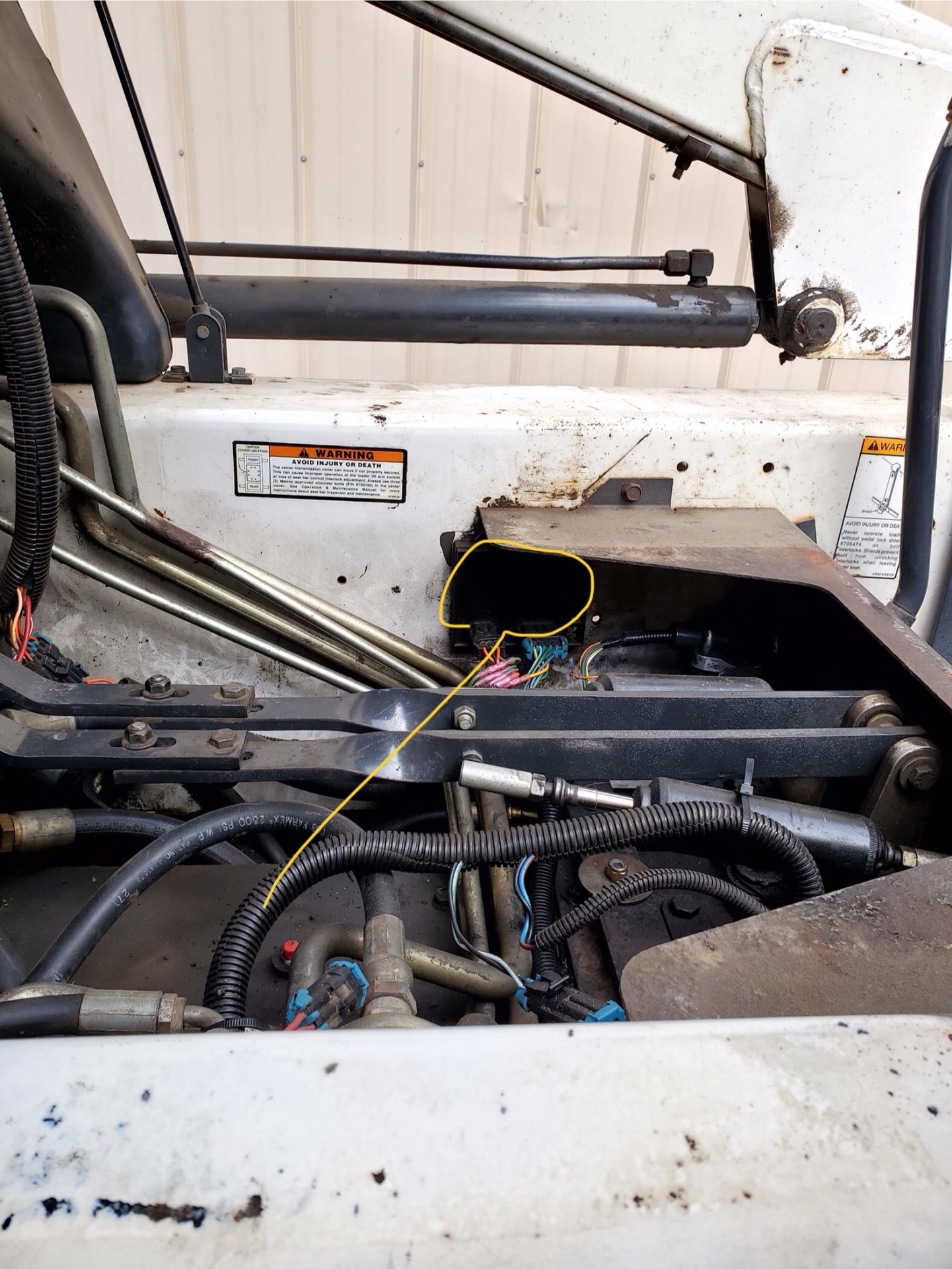

The control module under the left inner cab enclosure handles the aux hydraulics and handle switches. The other controller under cab handles the sensor inputs. I have to open my 753 tomorrow so I will take a pic, of mine.
SO you had a gauge on and verified that the pressure is always good. You replaced the Sensor. What codes come on? Like when you press the light button on the LH panel for 3 seconds when the issues accrues?
Some pics from my 753 for controller (computer)location and aux hyd module location. The one to the left of the driver seat is The aux hydr module electrical controls. There is an eBay vendor who states they can repair the computer/controller.

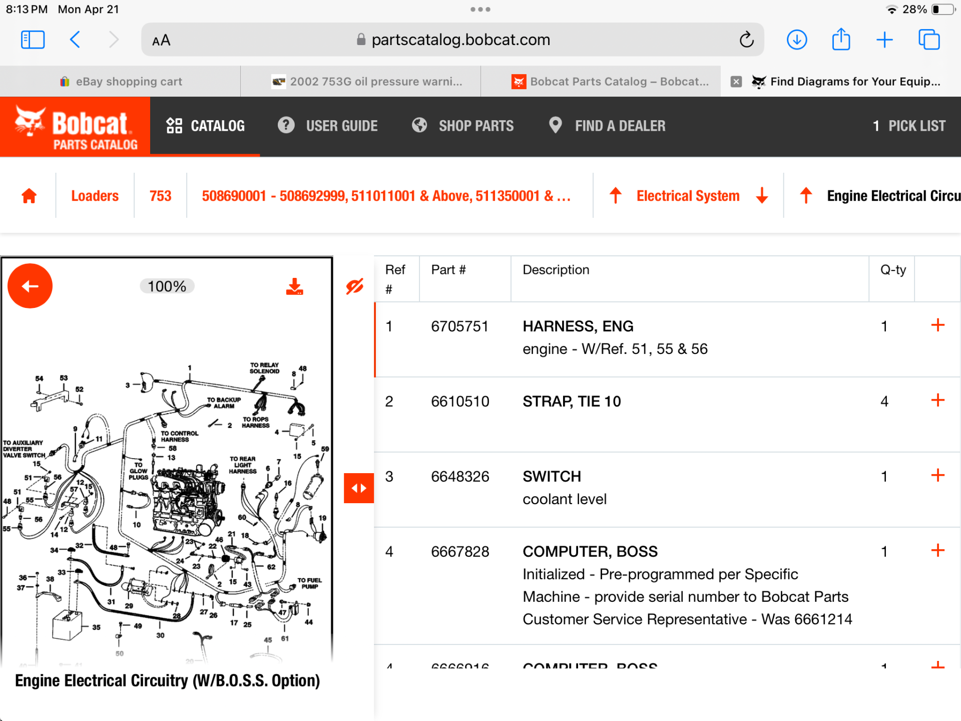

Bobcat still lists some of the 753 computers as available. #4 in pic, but you have to use your SN.
    722.8 KB

Do you have a G series 753? The placement of the controller on my G is different, its on the left side about where your elbow would be.
