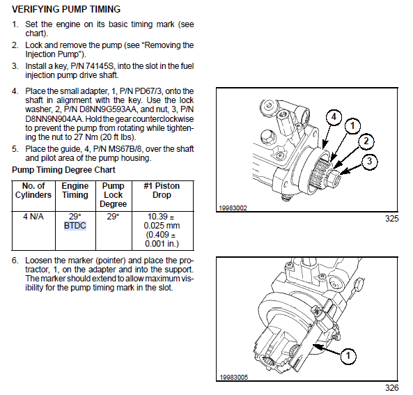

i rebuilt the pump-delphi 200 --[ 2000] -the head rotor drive broke --replaced with a new head - had timing problems --finally set to 10 deg. BTDC ---AT TDC AND 10 DEG --- after start-- steady increase in RPM --slight change with throttle --seems to run wide open ----no after run when shut off --weights are working --
