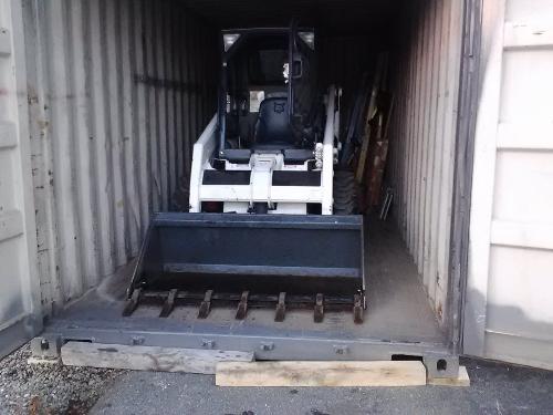

I've never owned a diesel until the S130, It will be kept inside during the winter but in unheated space (shiping container) Just wondering if I should use an additive for the fuel and if so what do you recomend. I live in southern New England so temps can get quite cold.

we'll be below freezing most nights Dec-March and may go thru a week or so at a tie when the temps never leave the teens. That being said it is New England and you never know, we could have another mild winter like last year rarely had to put on more than a sweater or sweatshirt.
I'm just asking because I've no prior experience with diesels and to be honest the skid could sit for a month or more without being used if there is no snow
