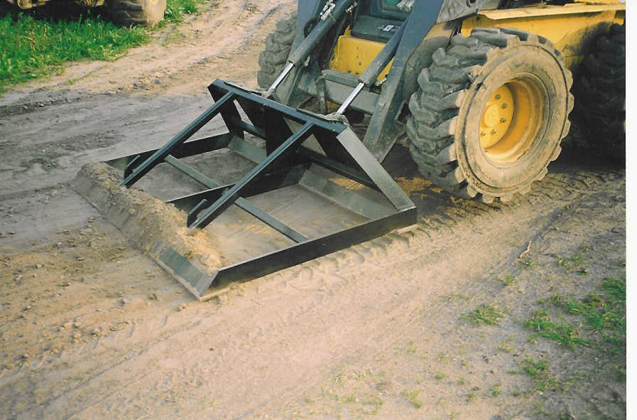

Most snow blades are setup to float to follow contour of area where snow is , dirt blades are not and are controlled by downpressure of machine . For moving material a grading planer on a skid loader works best for leveling .or a bucket and backdraging after spreading material .
http://koeckeritzironandsteel.com/other-products.htmlMakes leveling dirt and rock for driveways and yards a snap.
Heavy duty design.
Very easy to use.
No moving parts means NO maintenance.
