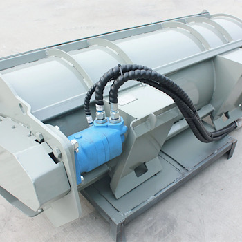

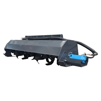

movable joints, pipe and a bolt or greaseable pins and bushings? Slop in the joints or shimmed out for a tight fit? Auger drive (planetary or chain or ?), Hydraulic motor (brand, low rpm/high torque, location on attach), hydraulic motor interface, diverter valve (brand, pilot operated)
Added 2 rototillers (both china) one leaves the hyd motor very vulnerable and is direct drive, second is belt drive but needs a drain line.
