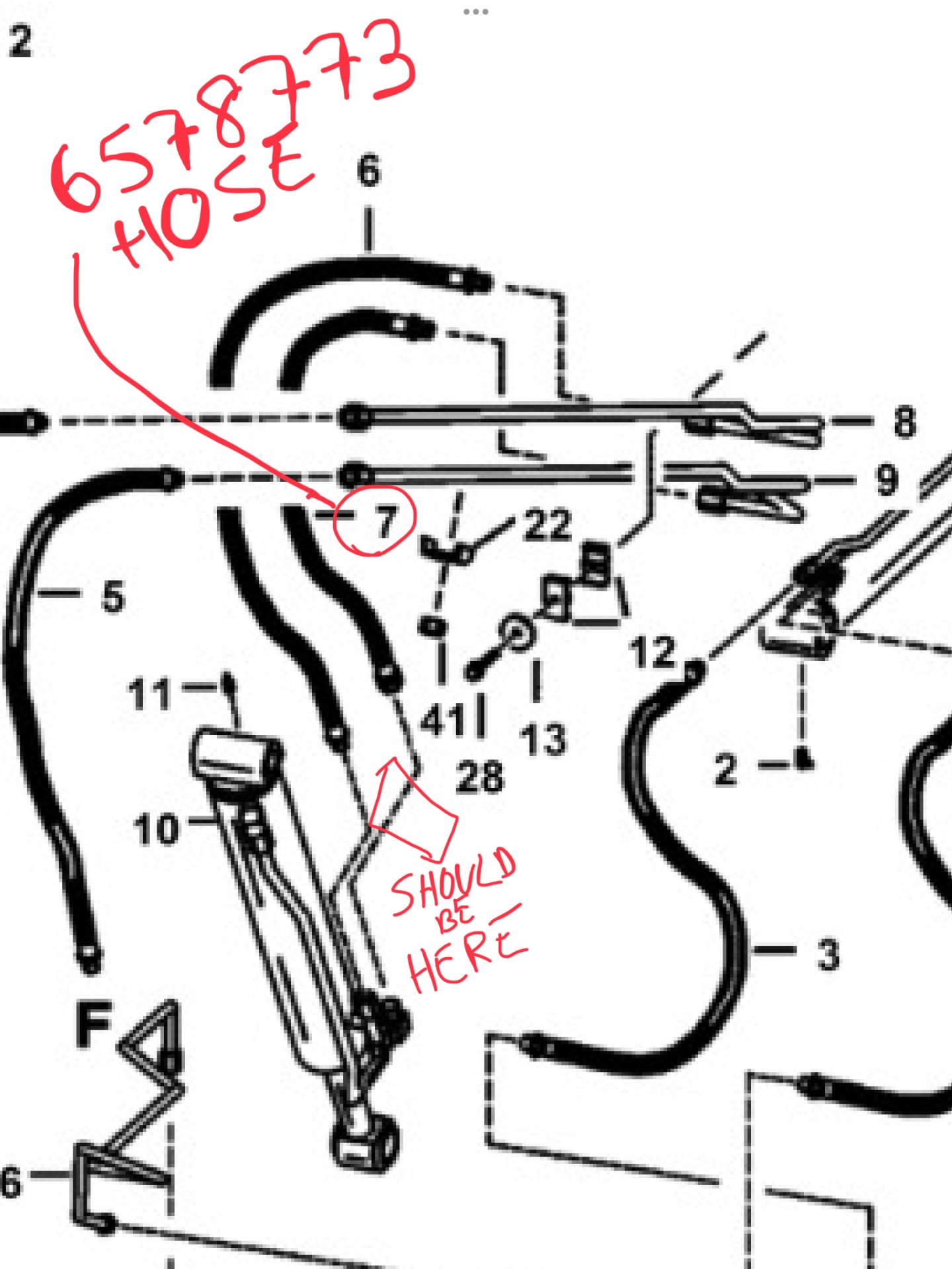

What part is this? On tilt cylinder return line, not in parts manual.
wateka
May 25, 2022
150
City & State/Province
Texas Hill Country

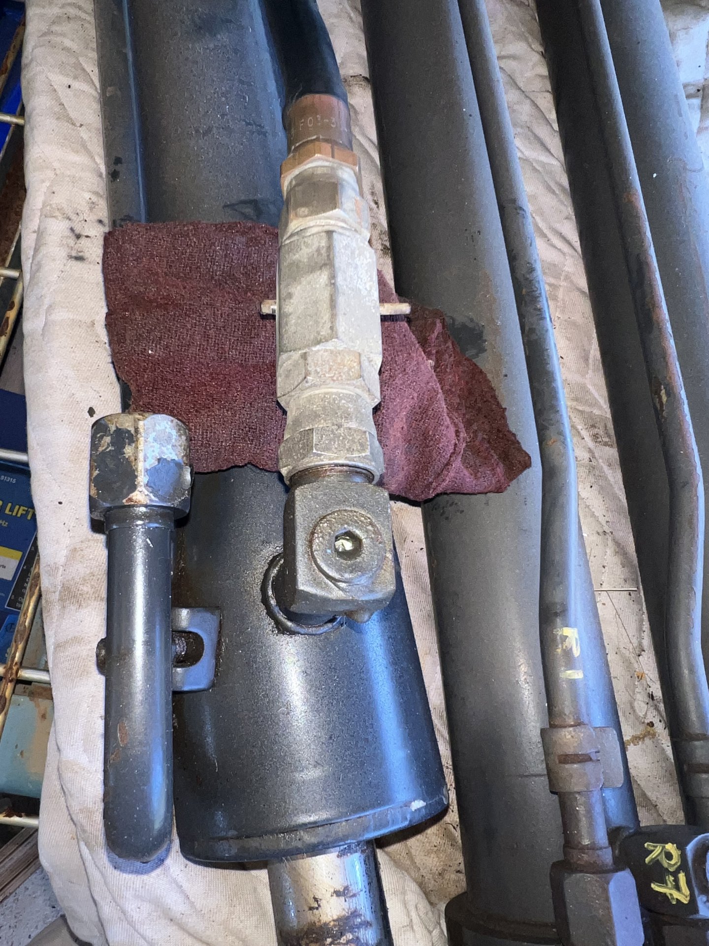

Any ideas? It’s from the return line of my 853 tilt cylinder, but the parts manual shows nothing. It is attached to hose part 6578773 but Bobcat doesn’t sell that hose anymore so I couldn’t reverse search Bobcat parts website to see if other models used it. I’m guessing it’s a flow restrictor but searching the parts catalog only finds a restrictor in the control valve. Aftermarket? Needed? I’m in the reassembly stage of my top to bottom 853 rebuild that came with a blown engine, so I have never seen the cylinder (or any other part of the Bobcat) in action.

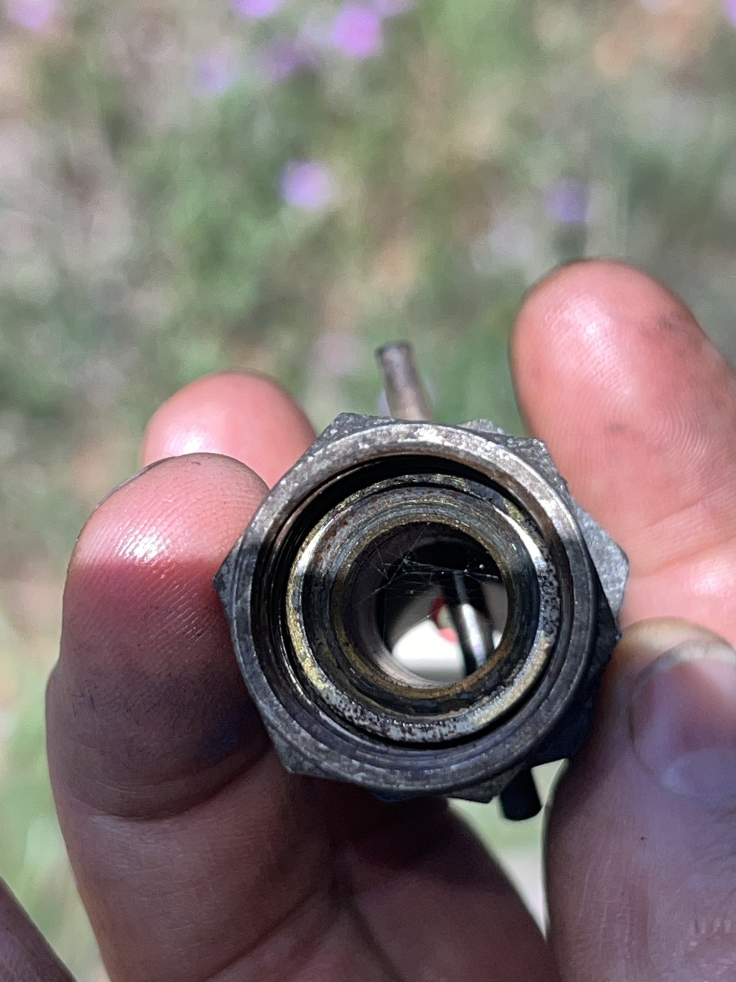

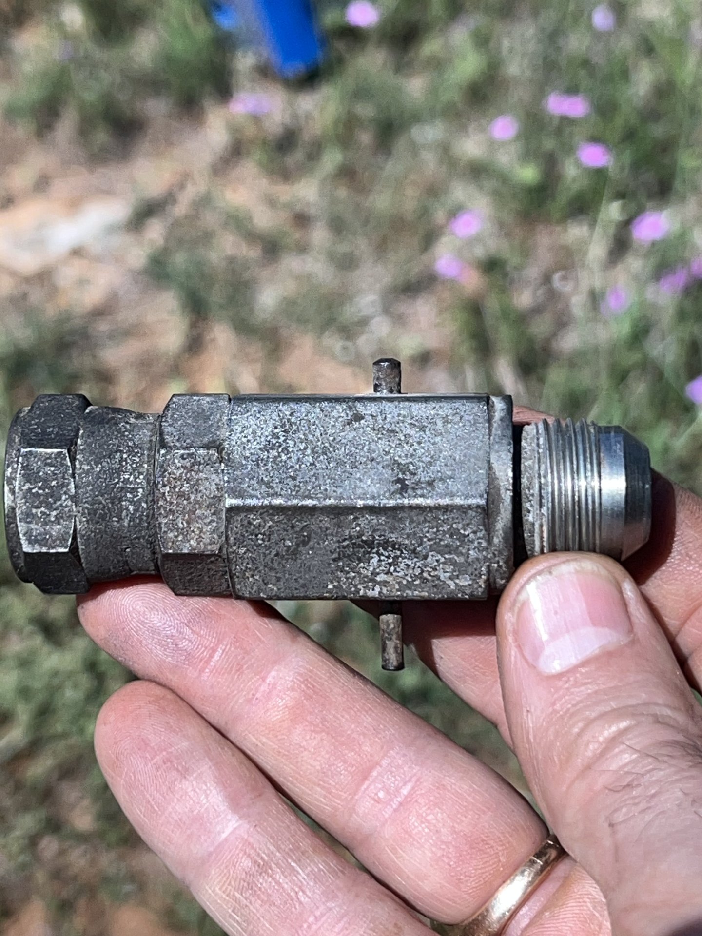

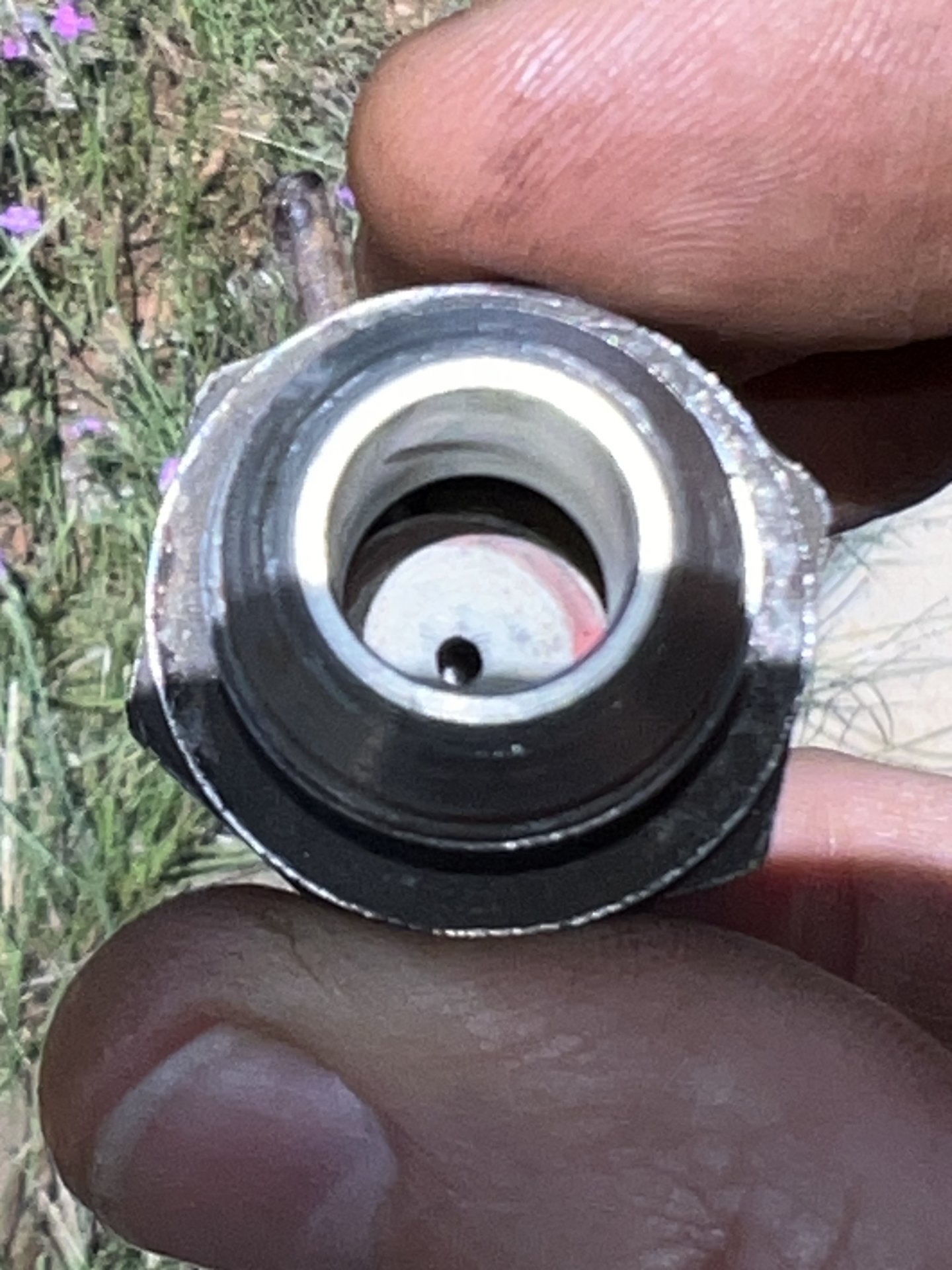

It looks like a one way flow restrictor. This would allow full flow in one direction and would limit flow in the other.
As installed, it would limit flow when you retract that cylinder. Did that cylinder move faster on extend and slower on retract?
If that is actually what it is, someone may have added it for more precise control.
Example video -
Thanks - I think that’s exactly what it is. Just a ball restrictor in my unit instead of a metal plate, as shown in the video. Since I’ve never seen the cylinder in action, and it’s not a stock item, I will leave it out of my reassembly. I know at some point my Bobcat was owned by the University of Georgia, and based on the below article I found searching for “one way flow restrictor” , it could have been added by them as a safety measure.
