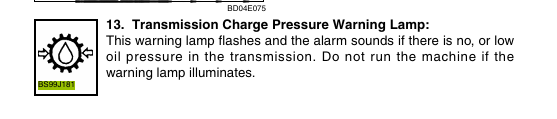

New owner of used Skid Steer. Just got it delivered and this light already came on. Can't figure out what it's trying to tell me. Owner manual won't be delivered for a few more days and don't want to wait.
Thanks!
Ken
Thank you for your response, I just bought it and in about five minutes the light started flashing with a audible alarm like if you are backing up so I parked it. The guy I got it from said to let it warm up and drive it around and the light should go out he thanks... Sounds risky
OM came in. Apparently, it is confirmed to be Transmission Oil Level. Absolutely do not run. Thank you again to everyone.

Sounds like a filter, if it was a pump as the oil warms it flows easier, however the light would never go out and you would find that it would not lift a empty bucket.
I am thinking that the hydraulic system runs under a static 100 psi when running.
I would be checking to see if there is a screen between the pump and tank that needs cleaning.
