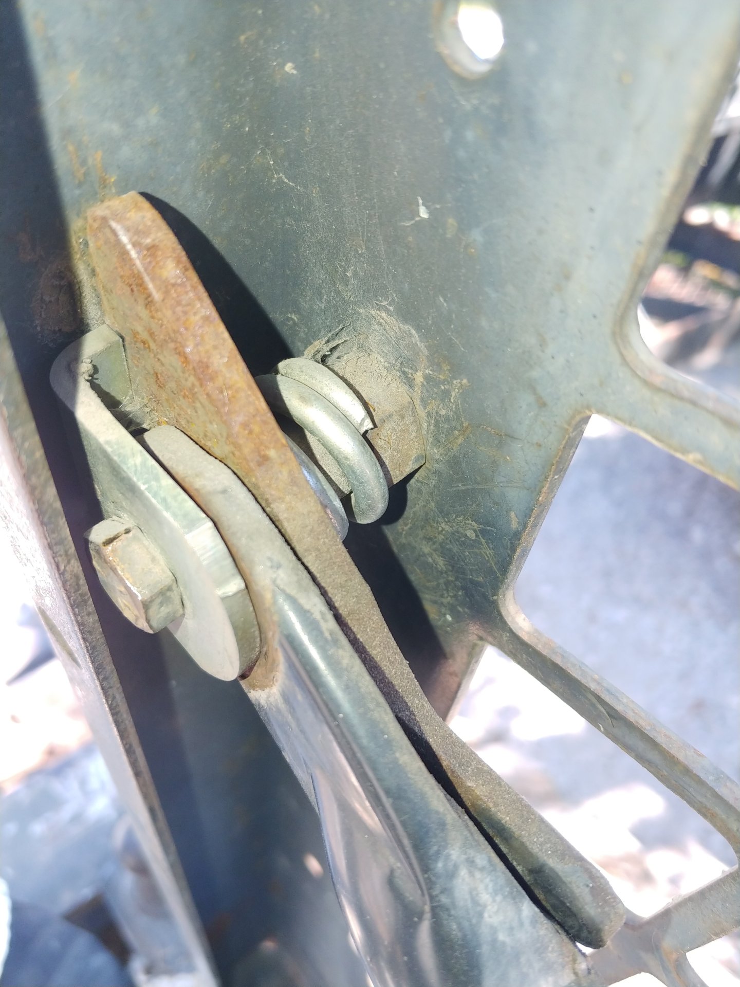

107

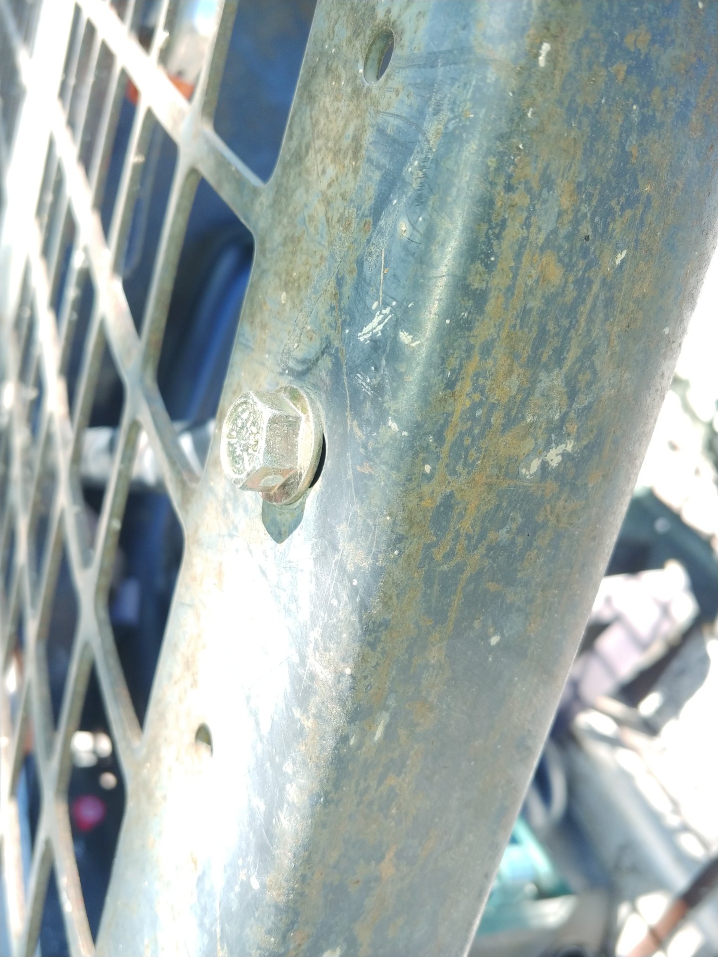

I'm not sure how they come off. there's an inside bolt head and an outside bolt head. the inside one is trapped inside the metal frame so it couldn't come out. so do you take the outside bolt out and then the wh
ole little contraption with the spring and plate and bar come out?

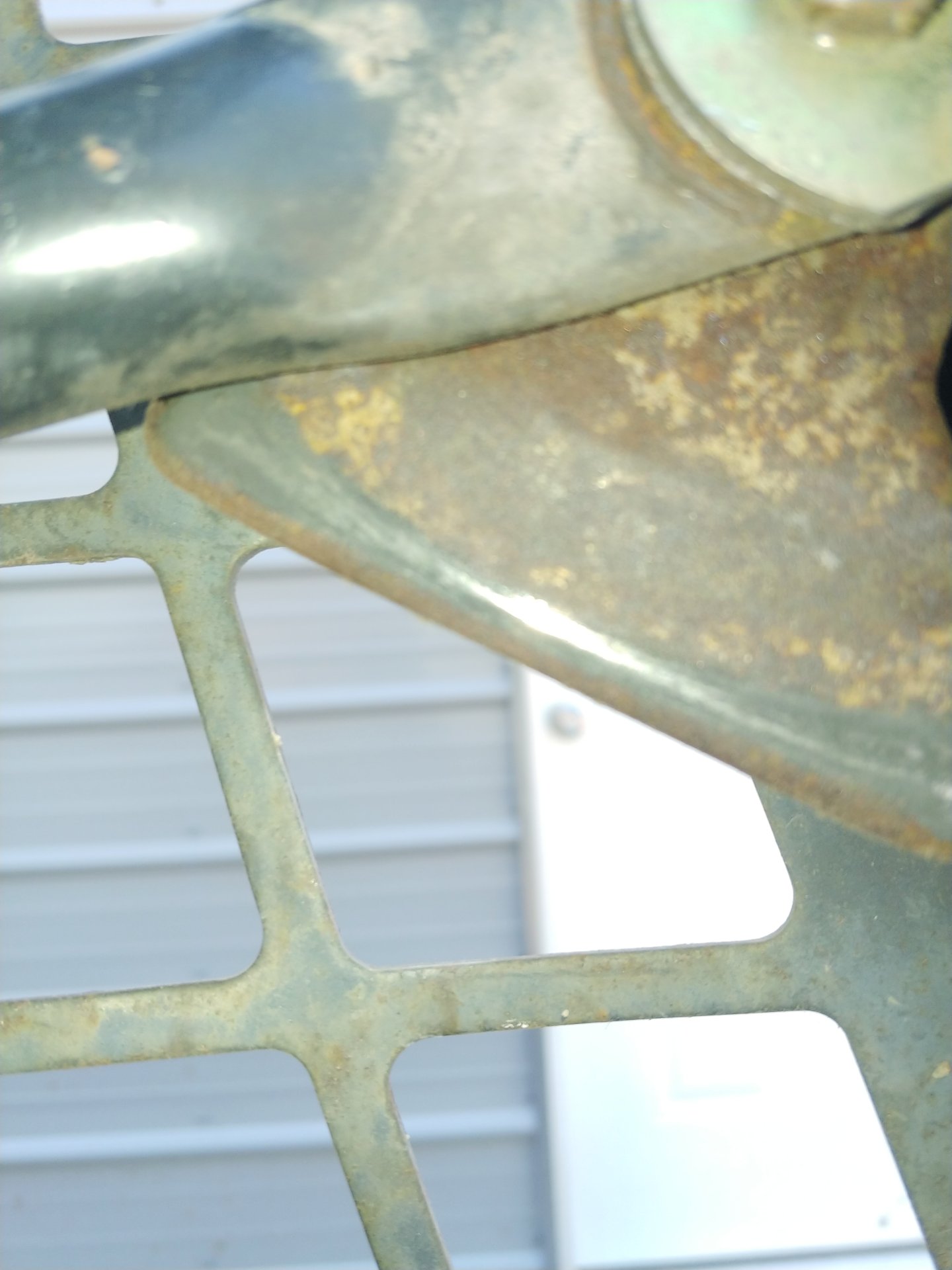

doesn't look like mine "spring under" the bar. they're just sliding against the side of the bar. maybe they're not installed right?. here's the picture with the bar up.

It looks like the plate is thick enough. Did you tighten the bolt on spring and see if the bar stays up?
well which bolt should be tightenable the inside one or the outside one? both seem to be super tight already I can put a cheater bar on my 14 mm wrench but feels like it's just going to strip the bolt head

Did you put some penetrating oil in the bolt running through the spring? I would try to break loose that bolt. I think it tightens the spring clockwise but first break it loose by trying to back it off and then lube it. Then draw it up on the spring. Do it on both sides! Let me know how it goes.
