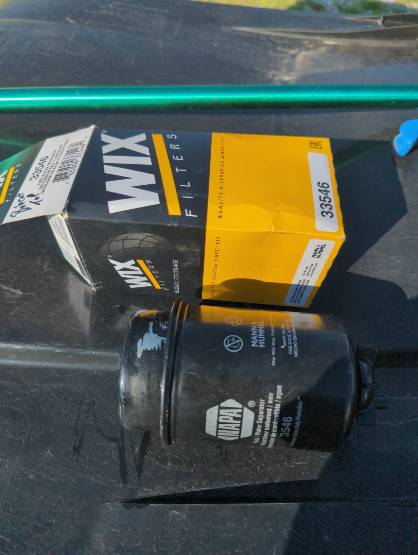

Just to clarify, The S250 does not have the same Fuel Filter.
The Filter you have seems a little big at the top of the filter.

I have first hand seen a reman motor from Cummins that had a fuel supply problem that took awhile to sort out. It ended up being a cigarette butt inside the new filter that came on the motor from Cummins.
I am thinking that this cheap wix filter is bad. I would suggest to go with an OEM or something better then wix
Bobcat doesn't manufacture their own filters. The wix filter is actually identical to the bobcat filter, That's who makes them for bobcat. Confirmed at dealer.
I don't know if maybe that's for their spin-ons not this weird one I have. But a few years ago when they were out of stock and I had to have one, that's what they told me.
Good information though. I appreciate it.
Anyway, I still think you have a bad filter.
