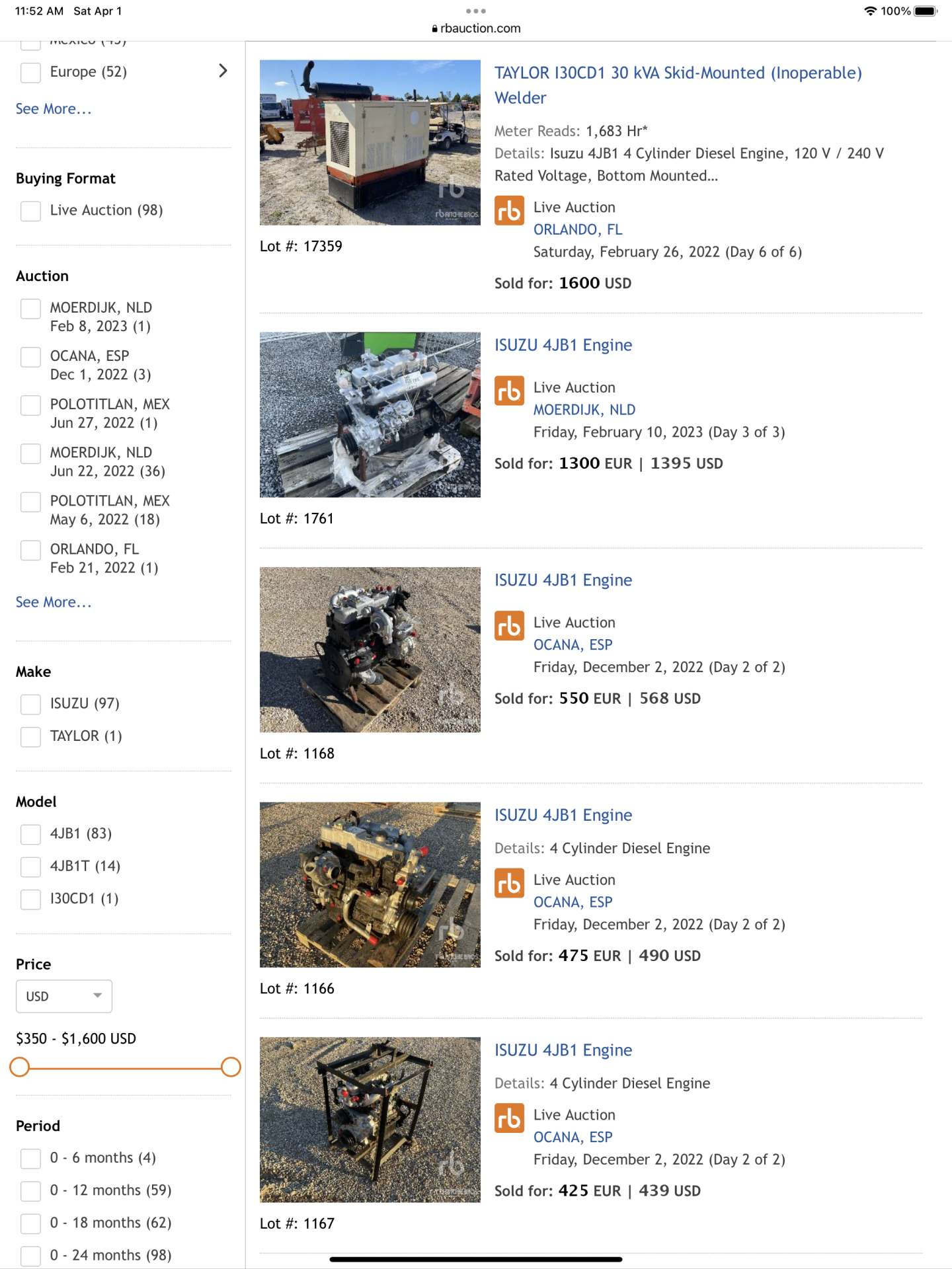

Well done. Hopefully you can patch up your crankcase and reuse it. What auction website had the engine? There had been some complete 4JB1 used engines at Rbauction.com (See picture) but they were in Europe and you would have to go through the whole import nightmare. Some were standalone engines and one was in a generator.

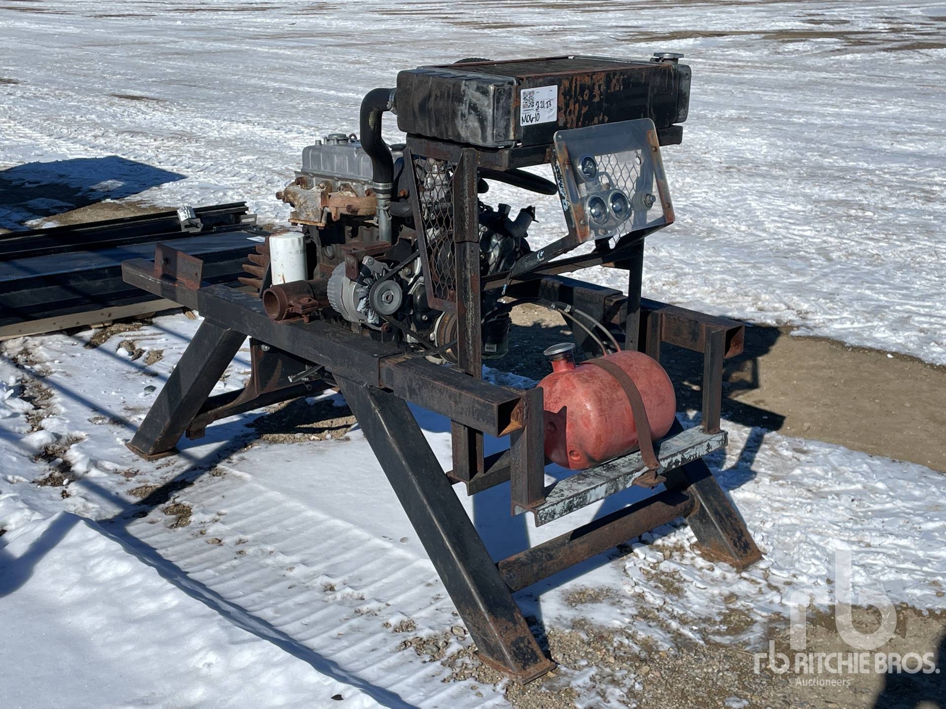

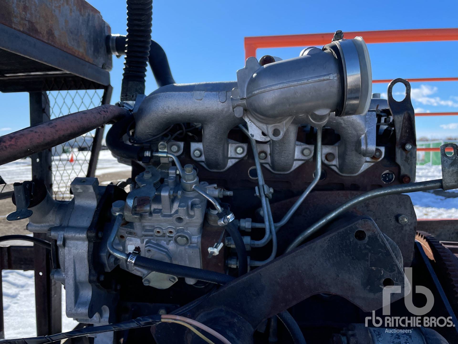

Yeah Ritchie bros was where I lucked out. It was a unit on a stand and it did not have the isuzu id number. I was able to compare the second picture with the one in the machine by the valve cover and water pump housing area that had a distinctive square knob on it. The crankcase is toast and I didnt bother to even attempt to repair it. I just installed it without the crankcase extension.
