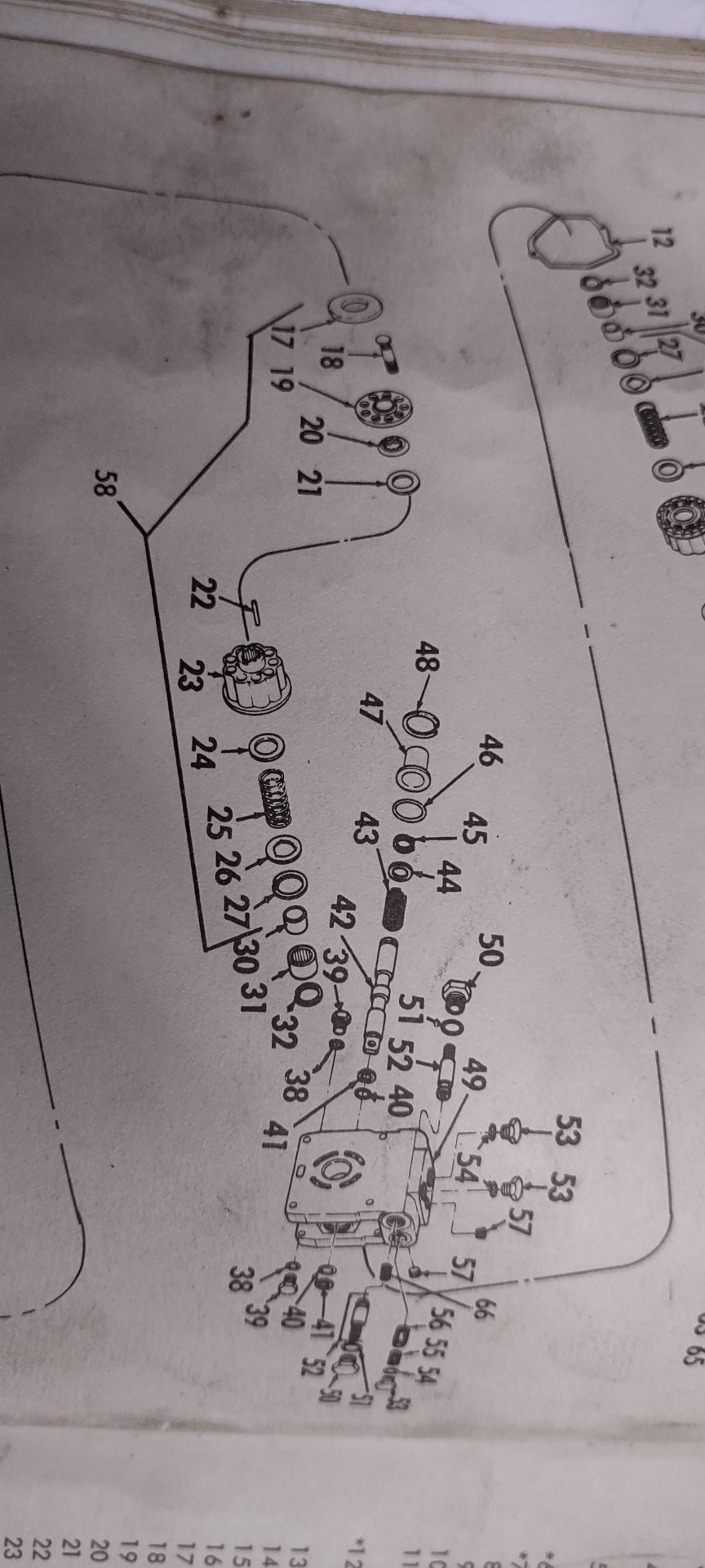

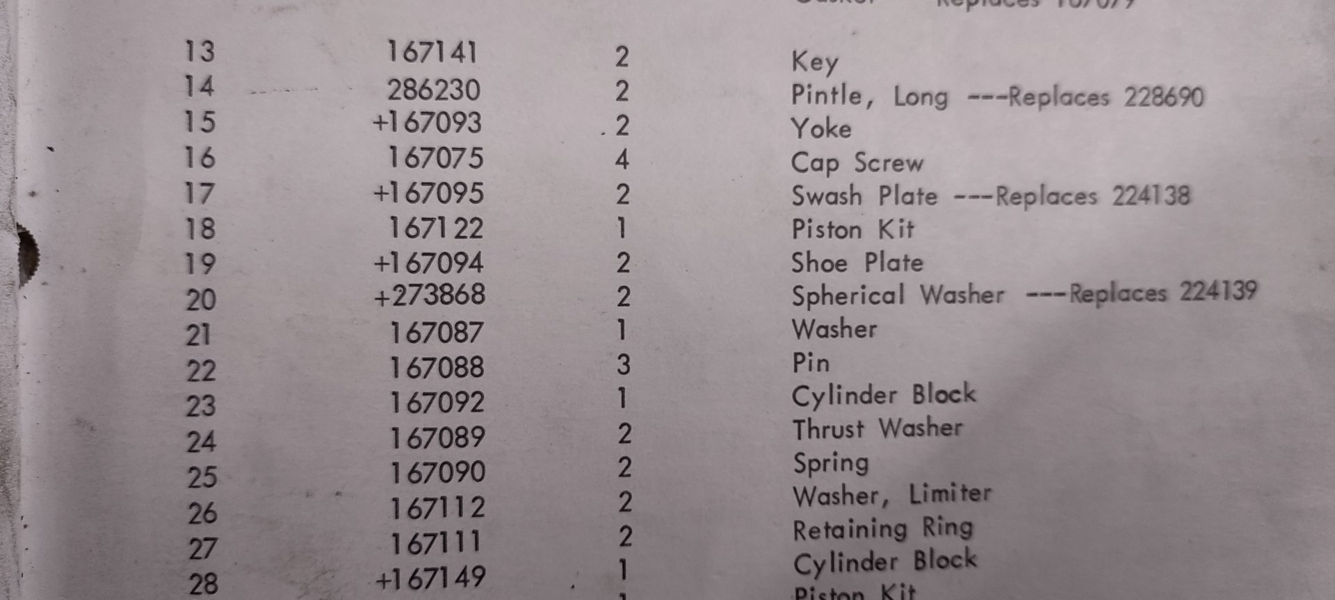

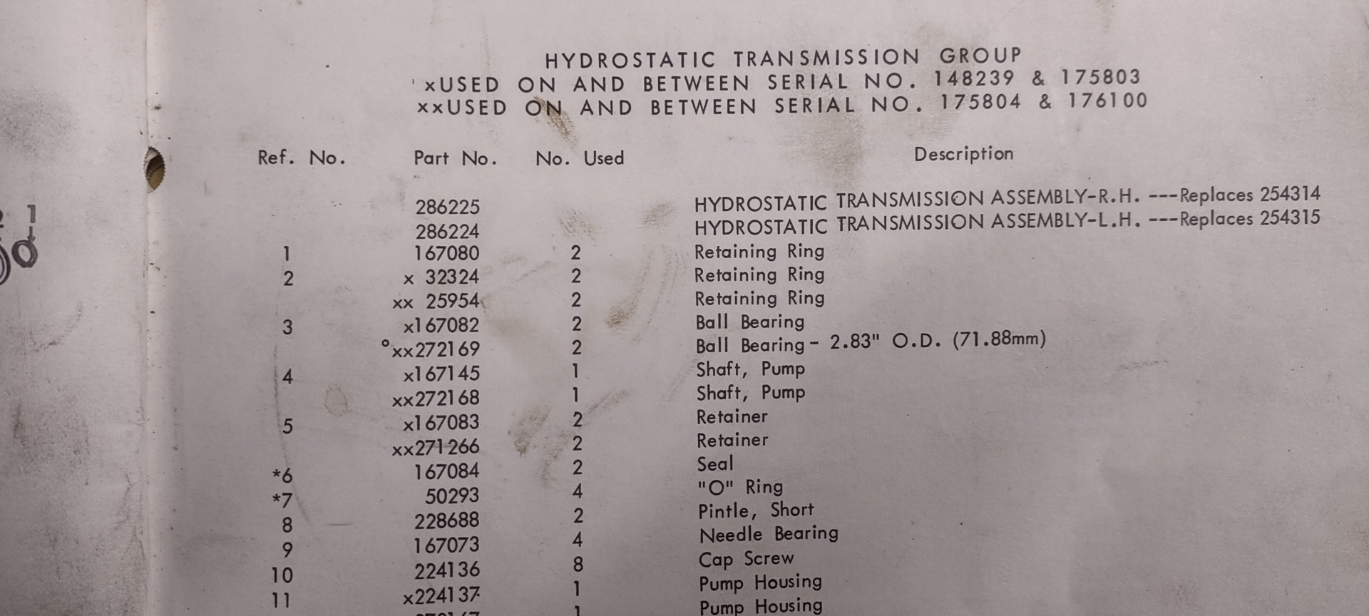

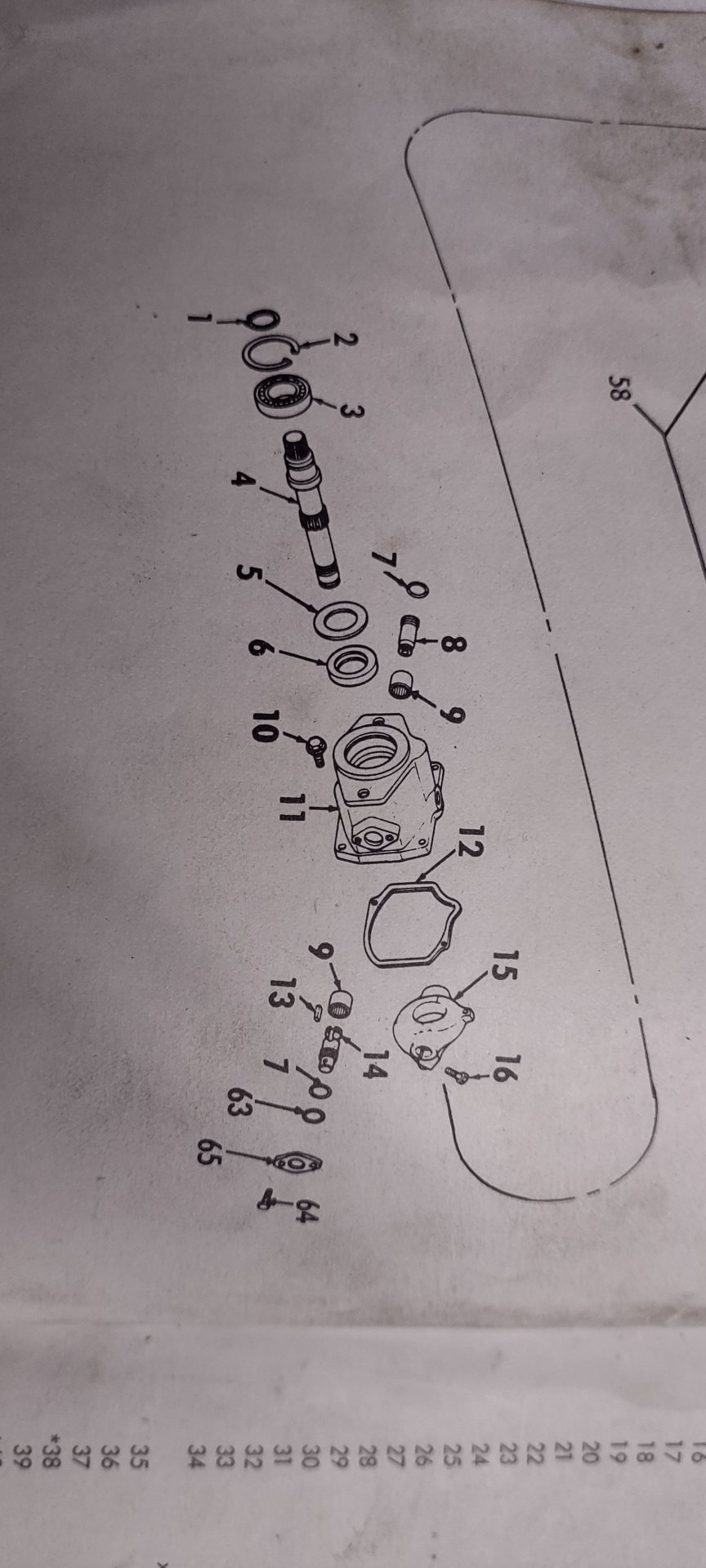

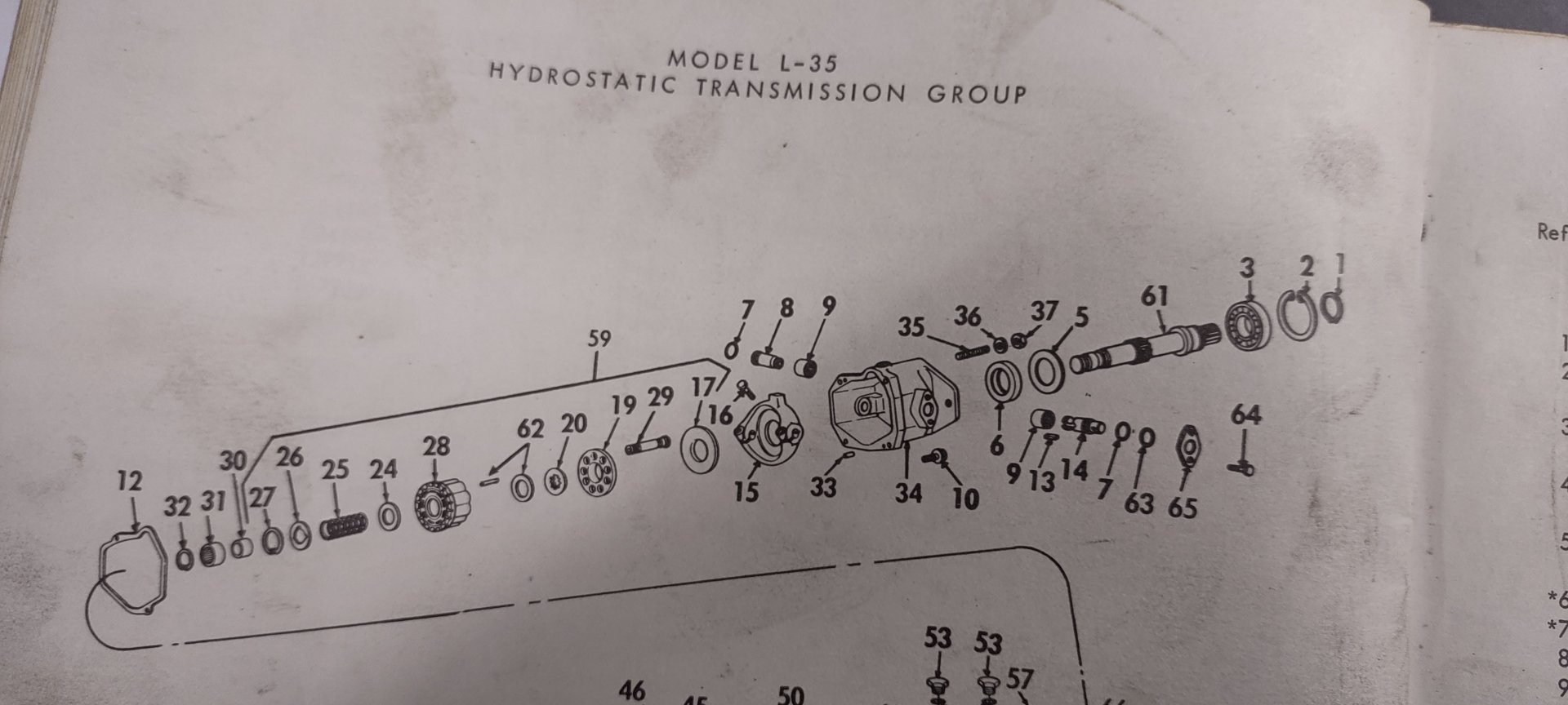

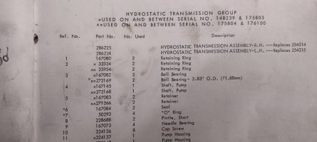

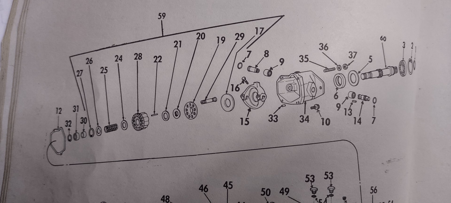

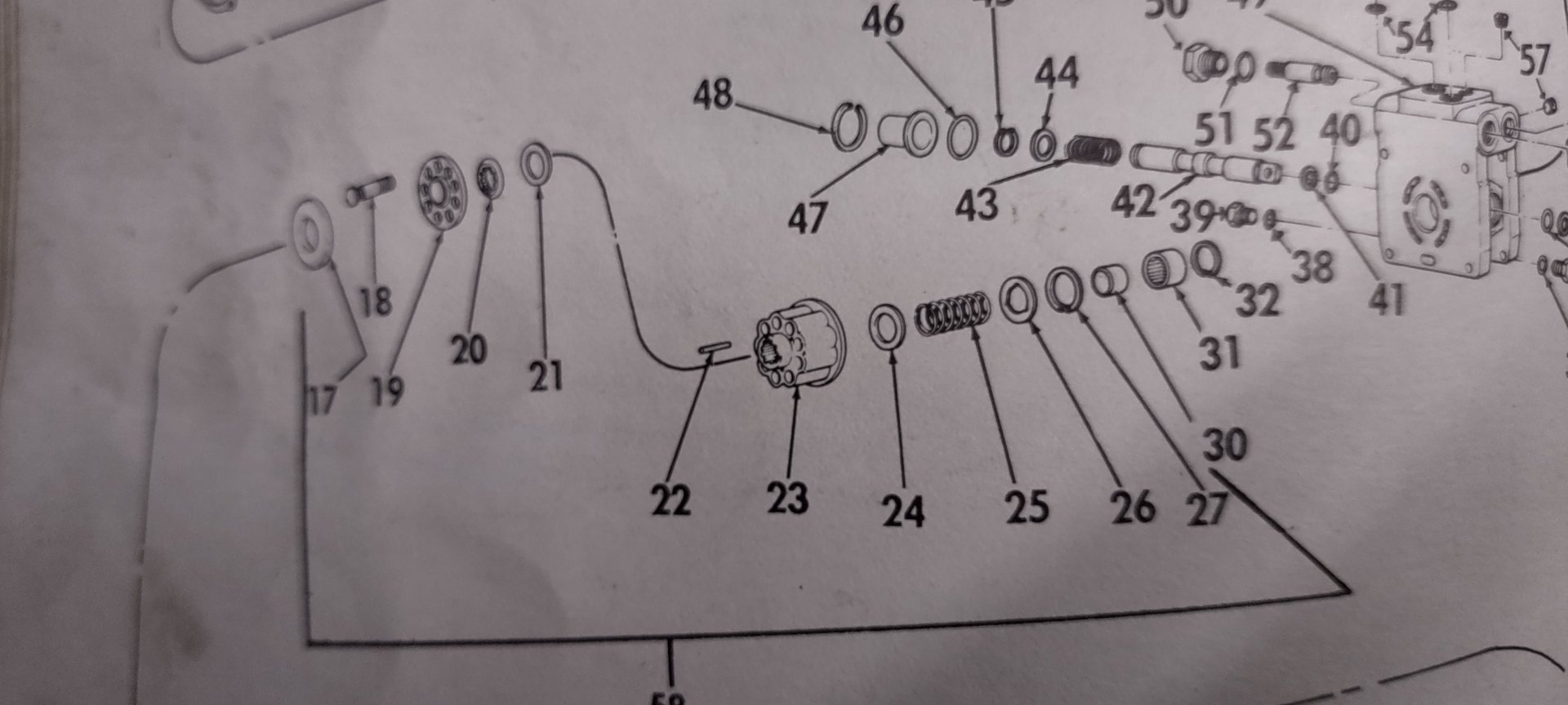

Assembling Vickers hydrostatic transmission on a L35. The parts catalog calls for a shim kit. I'm making my own gaskets,does it matter the thickness as far as the spool that holds the pistons clearance? It looks like on the pump and motor the spool sits past the case roughly 3/16 inch ?
Photos?
I figured it out. I used logic. The shim kit is used between the gearbox and pump for the purpose of the spider gear.

I appreciate this site. I hope this helps others. I have service shop books not for sale but I can send pictures of what you need. All in the name of good will to men.

Glad you figured it out. That is an old Vickers TA1515. Solid pump for it’s day.
