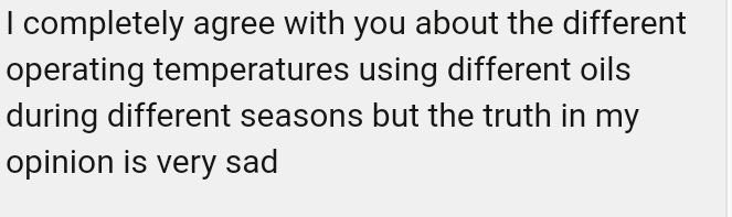

I completely agree with you about the different operating temperatures using different oils during different seasons but the truth in my opinion is very sad

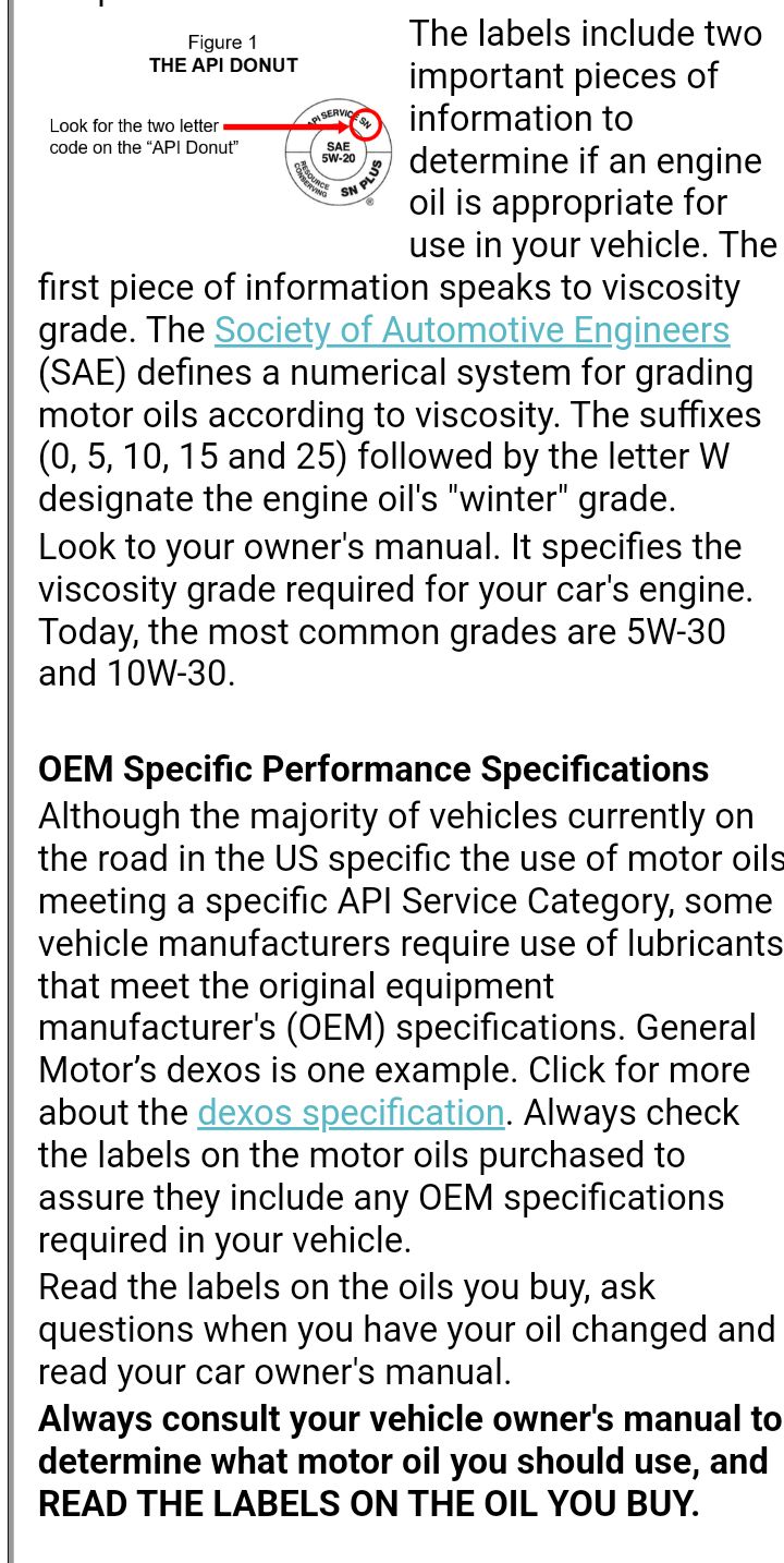

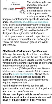

API rating has nothing to do with viscosity, only with the additive package in the oil. It is important to stick with the API rating specified by the equipment manufacturer. Viscosity can vary, depending upon the ambient temperature/climate you are operating in. Most manufacturers specify a different viscosity for different temperature ranges. You need a thicker oil (higher viscosity) in Arizona than you do at -20 in the Arctic. Viscosity requirement varies with the ambient temperature. Has nothing to do with the API rating.
Hey what do I know......
    239.1 KB
    24.1 KB
